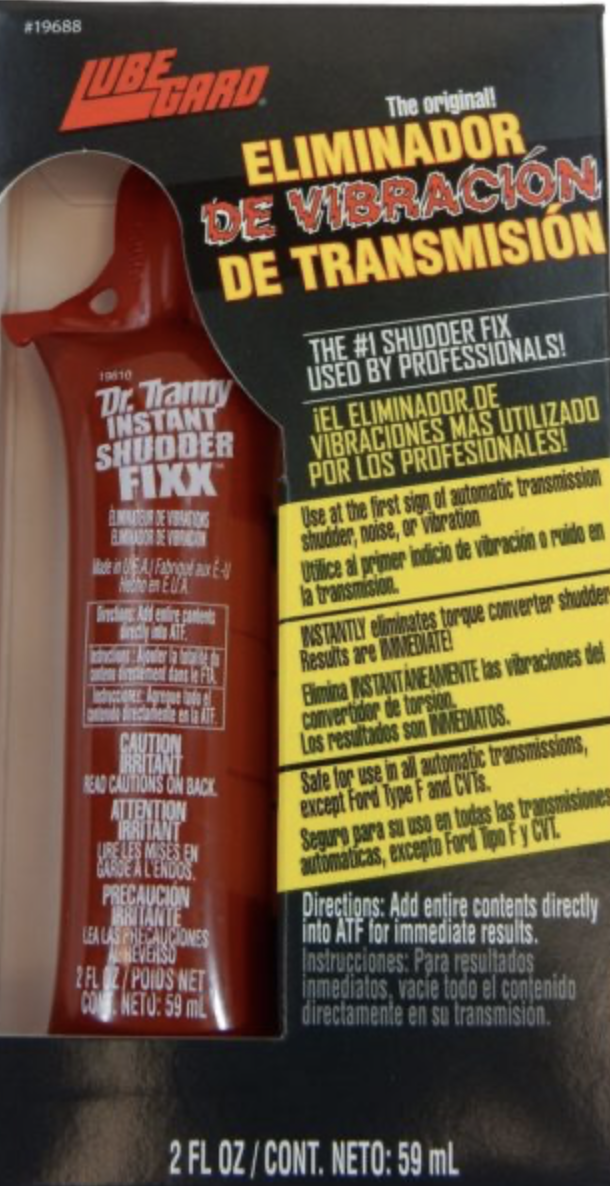

    AT shudder is most likely the torque converter locking up. Usually caused by low AT fluid level, a common problem on these trucks from the factory. If the truck is under warranty, get AT fluid level checked and filled to spec. Otherwise, add 1 tube of Lubegard Instant Shudder Fix in the AT fluid fill (2WD / 4WD). It should eliminate the shudder/lockup. If it's "fixed", your TC is good... if not... $$$$ problem$. Regardless... do a level check as described in the 3rd Gen AT Fluid Level Check DIY thread. Shudder Fix is a "diagnostic tool", according to the MFG.
    My 2017 DCSB 4WD Offroad got this problem at 100K. 1 tube of Shudder Fix made it go away until I can do a drain, drop the pan, install new filter/gasket/washer kit and refill... I will add a tube of Shudder Fix to the fluid when I do that job.
    Also, FYI, the poison warning on the Shudder Fix tube is legit. It is a skin irritant. DO NOT let it get in your eyes, nose, mouth. Wear gloves and goggles for the quick fix. I got a little fluid under my shirt cuff and waited a bit to wash it off... mistake. It's not as caustic as brake fluid, but it does penetrate the skin. And you will most likely get some cuts and scrapes on your hands due to the remote location of the AT fill port.
    Stuck in VT, CCATT-RN, TRDRed and 2 others like this.

    Please don't confuse OP.
    3rd gen tranny torque converter is designed to lock up and maintain locked till the death.
    Tunes are dealing with this by increasing the production of engine torque , modifying downshift point and torque converter unlocking points. Op need to go back to the tuner and don't waste time on checking fluid level.

    Yes, we have...
    Unless you are SCARED OF DOCTOR TRANNY... give it a try!
