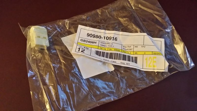

    Part number 90980-10916 Connector

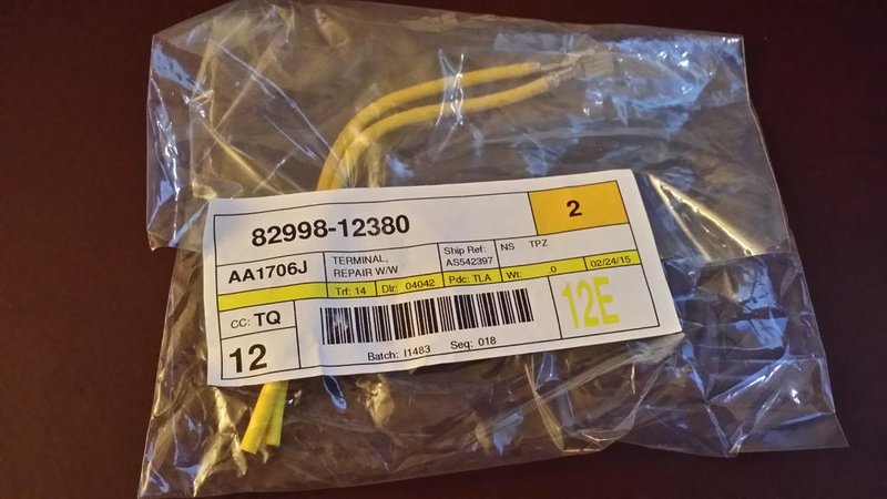

    Part Number 82998-12380 Wire and terminal
    Not sold as a kit, sold as each. So you will need one of the plugs and two of the terminal and wires.
    Connector:
    Terminals:
