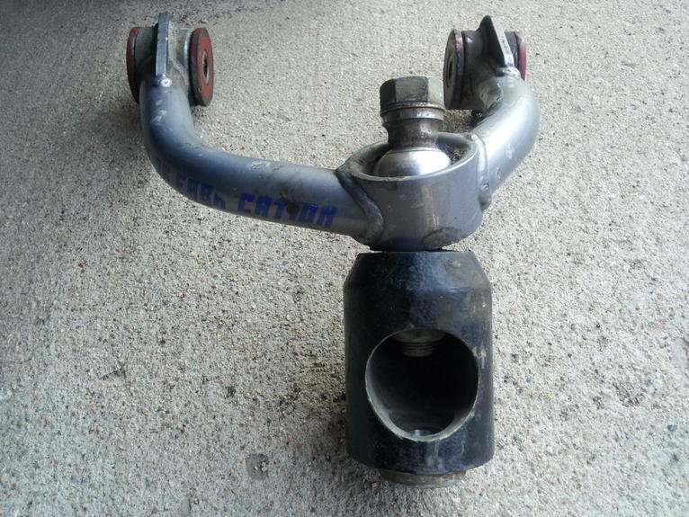

    Hey guys, I bought some Total Chaos UCA used and they came with these spacers that I've never seen. Can anyone identify what they are? I'm assuming I don't want to use these since I'm not using any sort of spacer lift or a lift higher than 3".

    I think those spacers were a cheap way to do a spindle lift. I haven't seen those spacers in a while i believe there discontinued

    I think those were used on trail master lifts... I think ive seen them on a few TM trucks that go around here
    but TM lifts are horseshit, so you should just take those off. haha

    That's what I was thinking, Trailmaster or old Fabtech. Thanks for the help! Just wanted to make sure I wasn't throwing away some uber rare parts.

    make sure has the slug adapter too or it wont go on your truck.

    Those went on the old Fabtech drop bracket 6" lift. They would just piggy back it to the stock spindle vs including a taller spindle. In other words cutting cost on that terrible "lift kit"!

    So likely this was on a mall crawler, great. :)
    That brings up a good point paranoid, I have emailed about replacement parts for these but does anyone sell replacement stuff that you know of?

    They are from the 4in. procomp lift for the 1st. gen tacoma.
