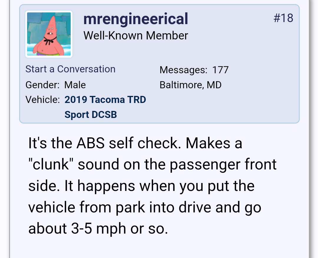

    It might be this... Sound comes from the front right wheel. Definitely not the steering wheel.Screenshot_20221114-180954~2.jpg

    Weird, my tundra does that but not my Tacoma. That’s what it is for the tundra though

    Brake pad slap. Pull your pins, pads. Clean pins, back of pads and shims. Apply fresh coat of brake pad grease to them. Problem solved had this same noise.

    Its the Abs self check. Our 4runner does it as well no big deal.
