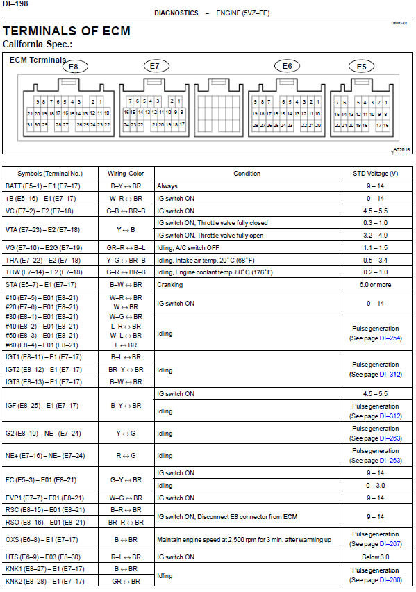

    It's a long shot but on this table you can see the "STA" signal and the 6v you should see and where to see it, eighth line down.
    I say its a long shot because manual trans folks can push start without using the starter at all.
