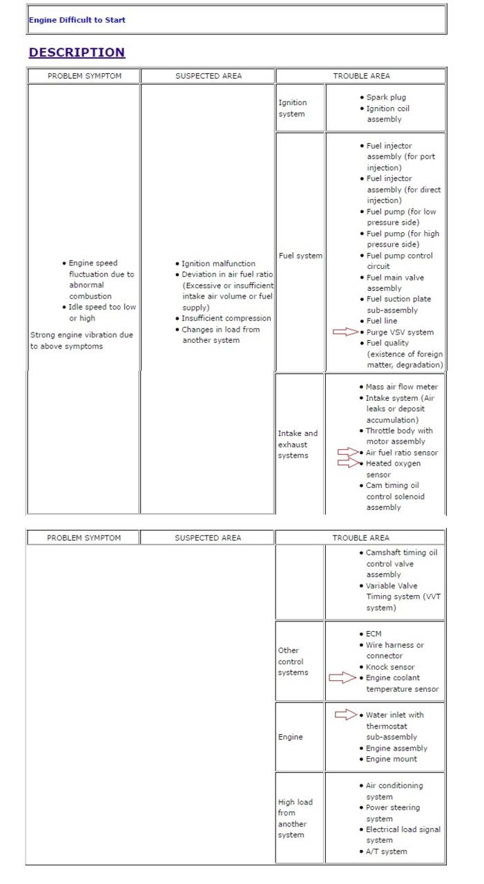

    Temperature dependent?
    These would be my guesses.
    Maybe the engine mounts going by noise and movement at start-up...
