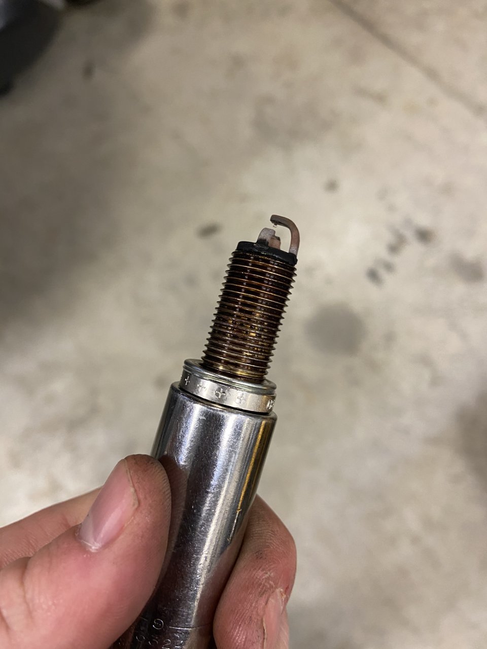

    Hard to say for sure from that pic, but that looks like a pretty big gap on that plug. Whats the spec supposed to be on 3rd gens?

    Not sure on the actual number, but here's my old ones

    Ahh yup that makes sense. Wasnt able to see the other pointy bit in OPs pic

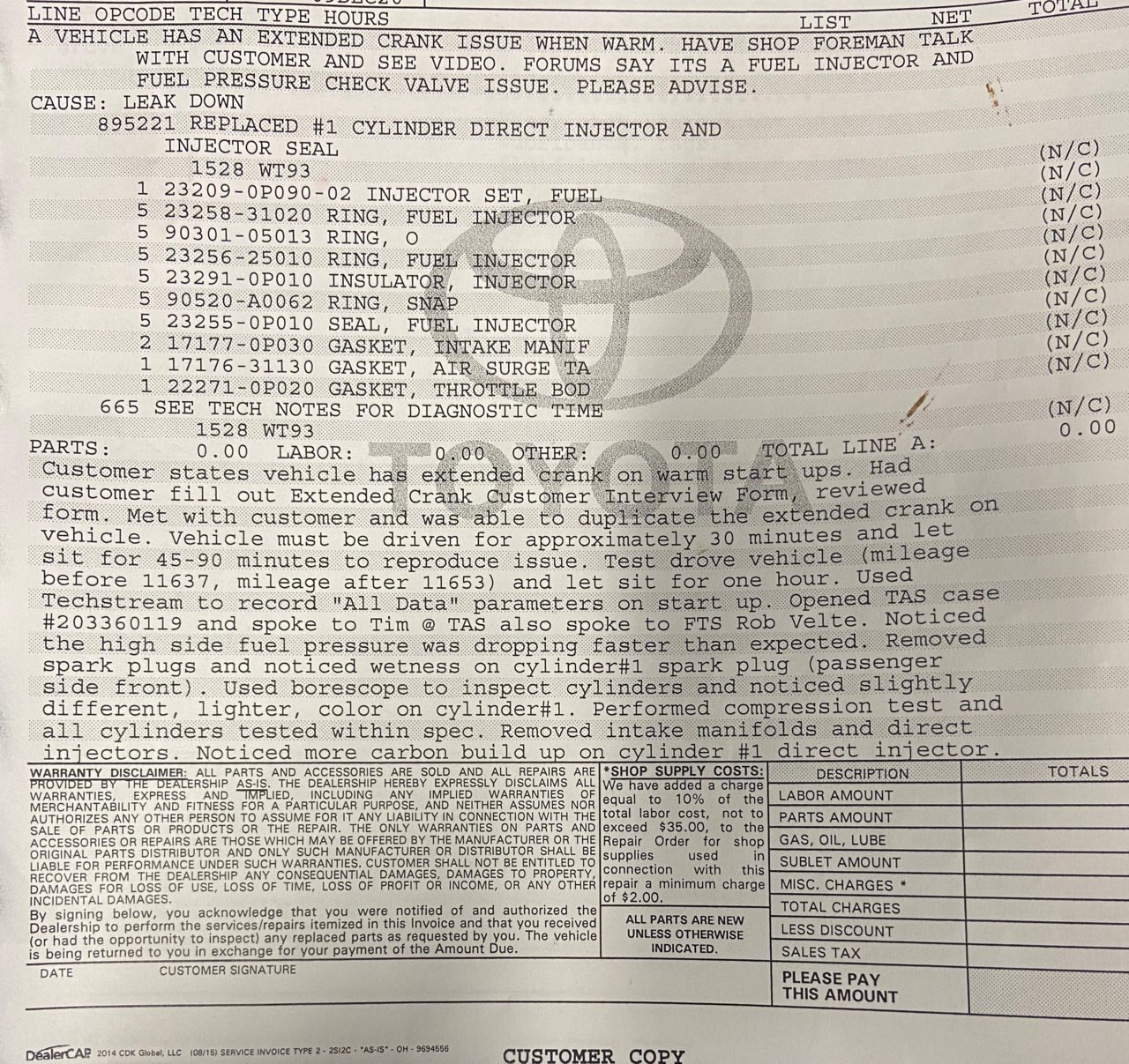

    Update: Took my truck to the third dealership yesterday 12/1/2020. Prior to taking it in (on 11/25/2020), the dealership's service manager emailed me the attached form and advised me to leave enough time when I bring it in to be able to allow her technician to hook up diagnostic equipment and get the noise to happen in front of him. Filled out the form thoroughly and sent it back in the same day. I took it in yesterday at 7:00 AM and was able to get the noise to happen in front of the tech at around 8:15. He confirmed that it did not sound right. I told him about the soaked spark plug and how my oil smells like gasoline. Both the tech and the service manager were extremely kind. Far more so than both of the other dealerships. Anyway I got a call back today (12/2/2020) and they said they found a slow leak in injector 1, which is the forward most passenger side injector (where the soaked spark plug was located). They told me they are going to replace that injector, replace every injector seal, and change the oil because of the gasoline leaking in. I am supposed to get it back next week; a little delayed on parts orders, probably due to Coronavirus.

    Excellent. Glad pulling the plugs wasn’t a waste of your time and provided another data point for root cause.
    Let’s hope that fixes it for good.

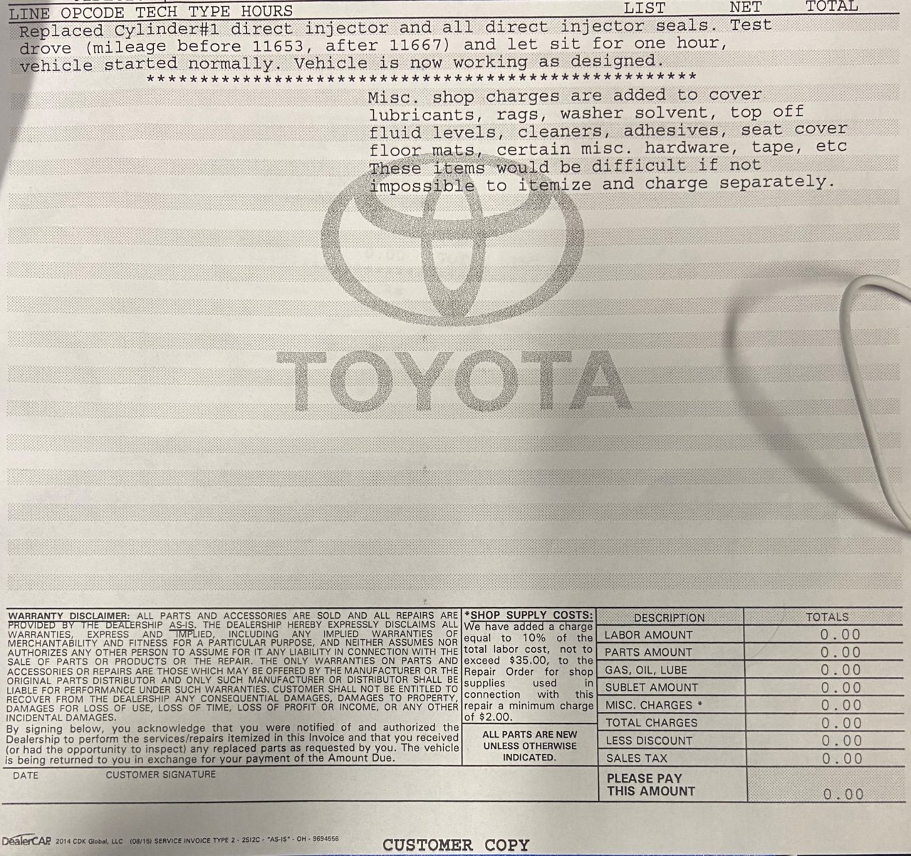

    So I got the truck back and this is the write up that I was given. I am very happy with this dealership to say the least. That said, I recorded a startup that I think still sounds slightly off to what I consider normal. Opinions? I very well may just be over sensitive to any little noises right now. If ya'll don't think it's anything don't hesitate to say so. If it is something, any suggestions on what to look at?

    Is it just me or do those write ups they write always seems condescending? Lol "Forums say its a fuel injector" you can feel them rolling their eyes. My dealership always writes "customer states ..." before anything as if it's not true. Maybe I'm projecting lol
