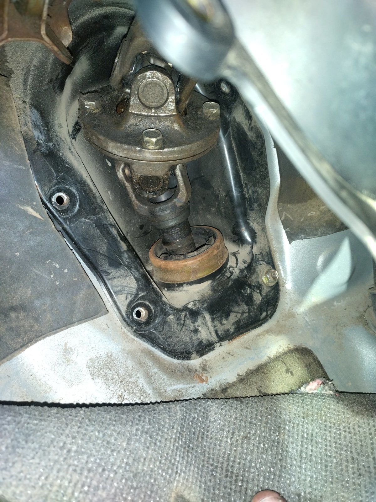

    Both. Just jacked up the vehicle and tried moving the wheel to locate anything. The dust seal through the firewall is gone and the intermediate shaft is rubbing against the truck. Due to it the alignment is off and I'm wondering if something as simple as this could do it. Will order a new seal tomorrow and see what happens.

    definitely your issue. The rubber boot is very soft and won't move the shaft though. Looks like somethings is bent like the steering column.

    That's promising, in general the whole shaft has plenty of play and can be moved back and forth. Hopefully, the seal fixes the issue. I'll pull the whole thing tomorrow and test for straightness while I wait for the part.

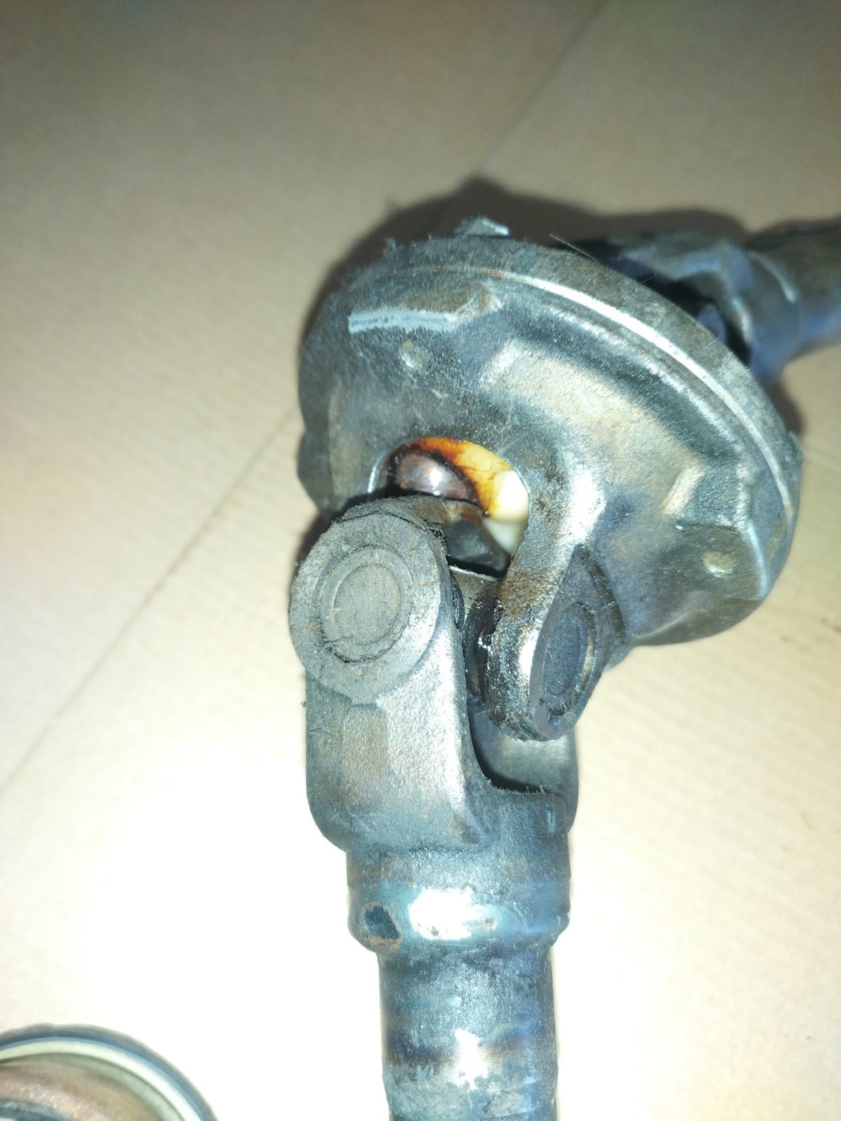

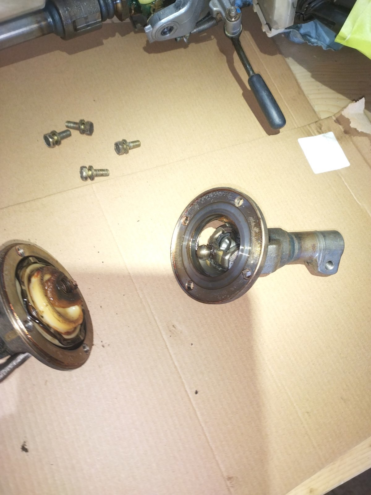

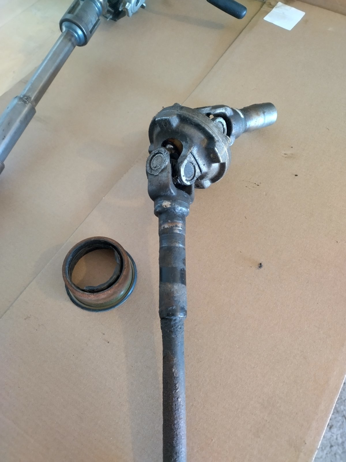

    So it turns out this is one of the best things I have done for the truck, super happy I did, even with all this headache. The joint in the intermediate shaft would barely move by hand so I took it apart, regreased, and it made a world of difference. Seal through the firewall is completely gone but new one should be in Monday.
