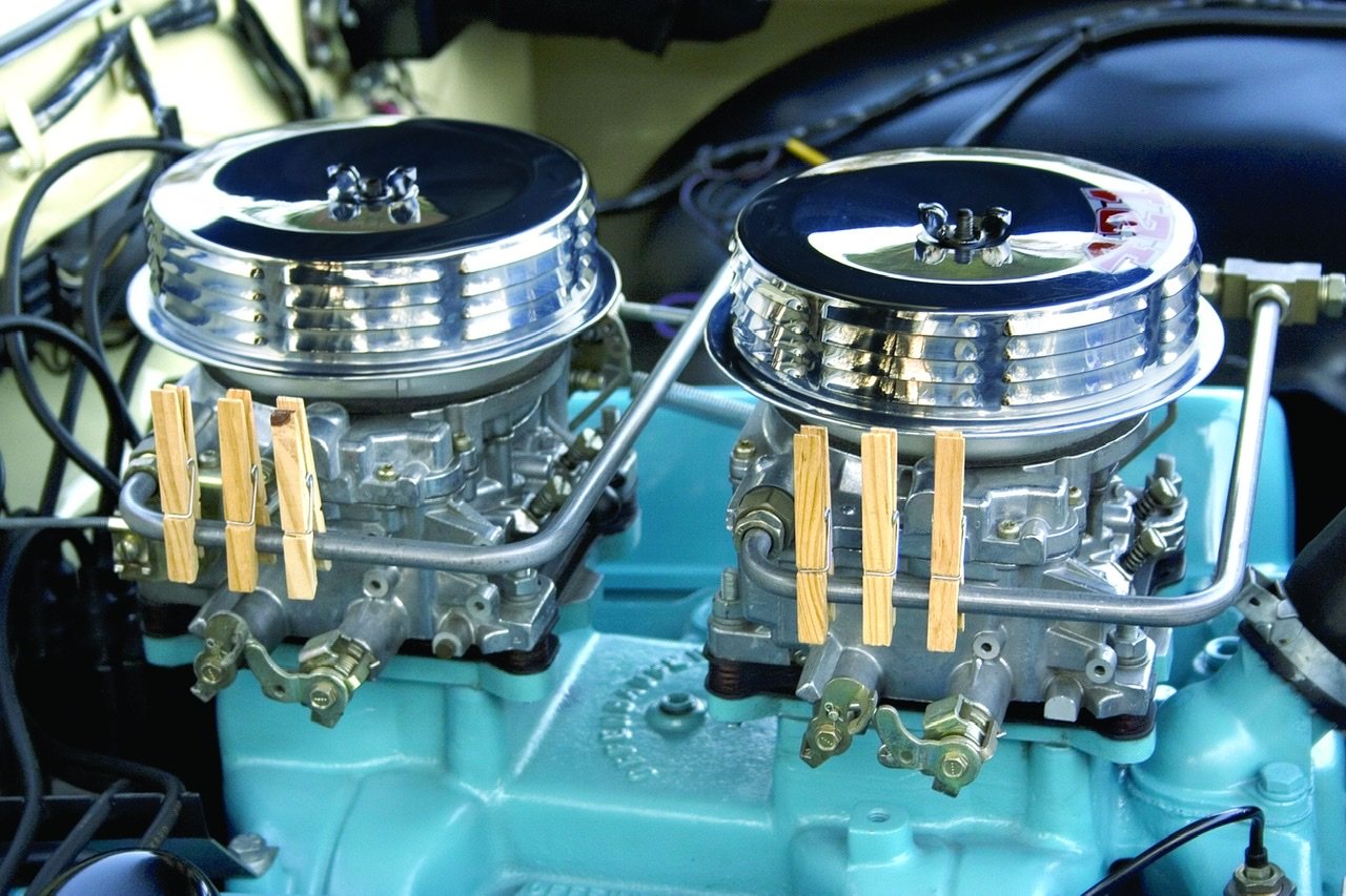

    If you believe vapor lock is the problem, maybe you should try some clothes pins on the fuel line.
