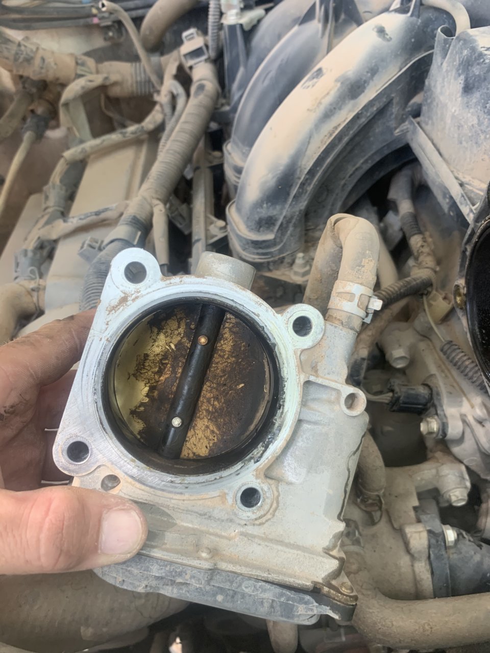

    So here Is the throttle body. The back was pretty gunky so I clean it up and put it all back together and it’s idling smooth at 1000 rpm. At first start up it went to about 1500 and stayed there for a bit then calmed down. I guess it didn’t know what to do with it being so clean again. Headed down to get some MAF cleaner and do that next.

    Cool. Thank you. I’ve been running around town today and it’s idling smoother at 1000 rpm and has more power on take off. Cruising around seems pretty much the same but it’s always had good power. The biggest change is in fire up it idles way up to 1500 for a sec then settles down to 1000. My wife’s exterra does that so maybe that how it’s supposed to be.

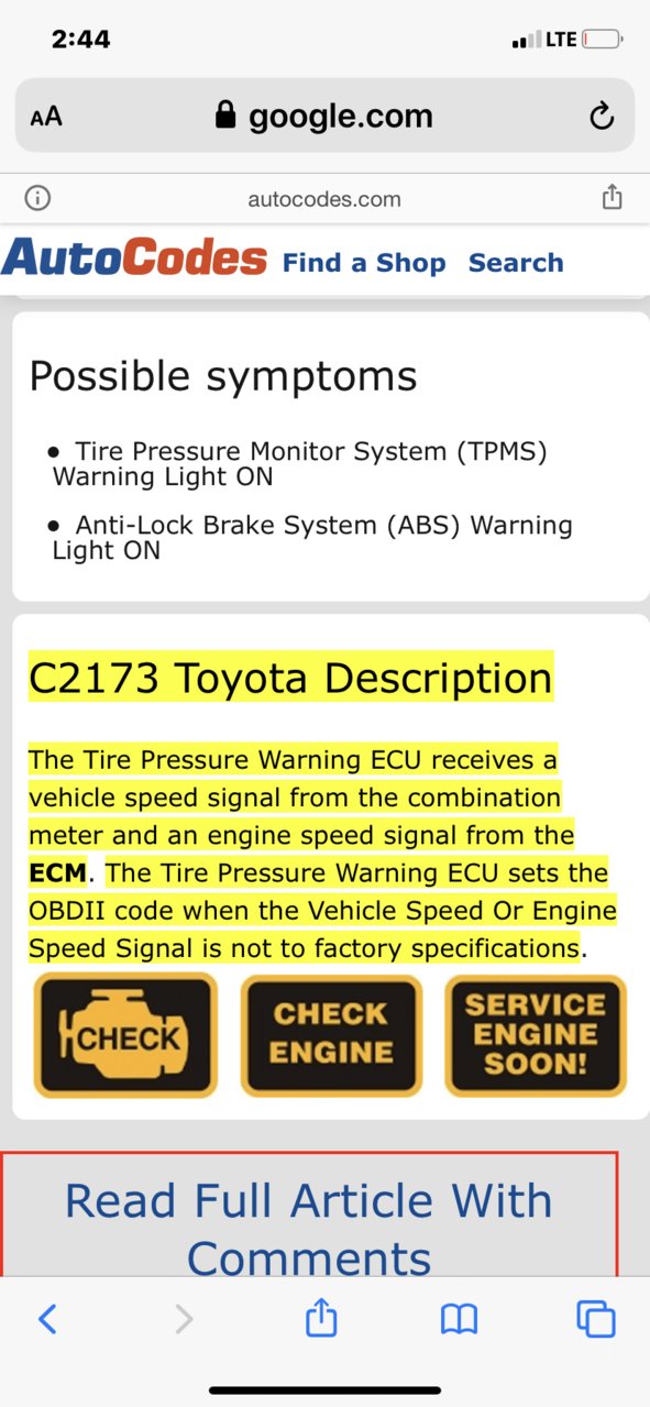

    Finally got the codes pulled and this was the only one that popped

    WTF!? Tire Pressure ECU would = Tire Pressure Engine Control Unit first of all. Last time I checked the Tire Pressure Monitoring system won't need an engine control unit...
    Sigh, the ABS warning light would come down to a more specific problem with a reader that will give you specific info from the ABS module (NOT ECU) of why the light is on (is it on, on your dash?).

    C2173 TOYOTA Possible Causes
    • Faulty Combination Meter
    • Faulty Tire Pressure Warning ECU
    • Tire Pressure Warning ECU harness is open or shorted
    • Tire Pressure Warning ECU circuit poor electrical connection
    How is the C2173 TOYOTA code repair?
    Start by checking the "Possible Causes" listed above. Visually inspect the related wiring harness and connectors. Check for damaged components and look for broken, bent, pushed out, or corroded connector's pins.
    dustinJ[OP] likes this.

    The abs light is not on. The TPMS light is on however but it has been on for more than a year. I assume one or more of the sensors went out a while back and I’m not too worried about it working to be honest. The code was read with a high end snap on code reader and that’s all it showed. We fired it up while connected and it showed everything was working as it should.

    How's it been running since you cleaned the throttle body?

    It's been running great.
