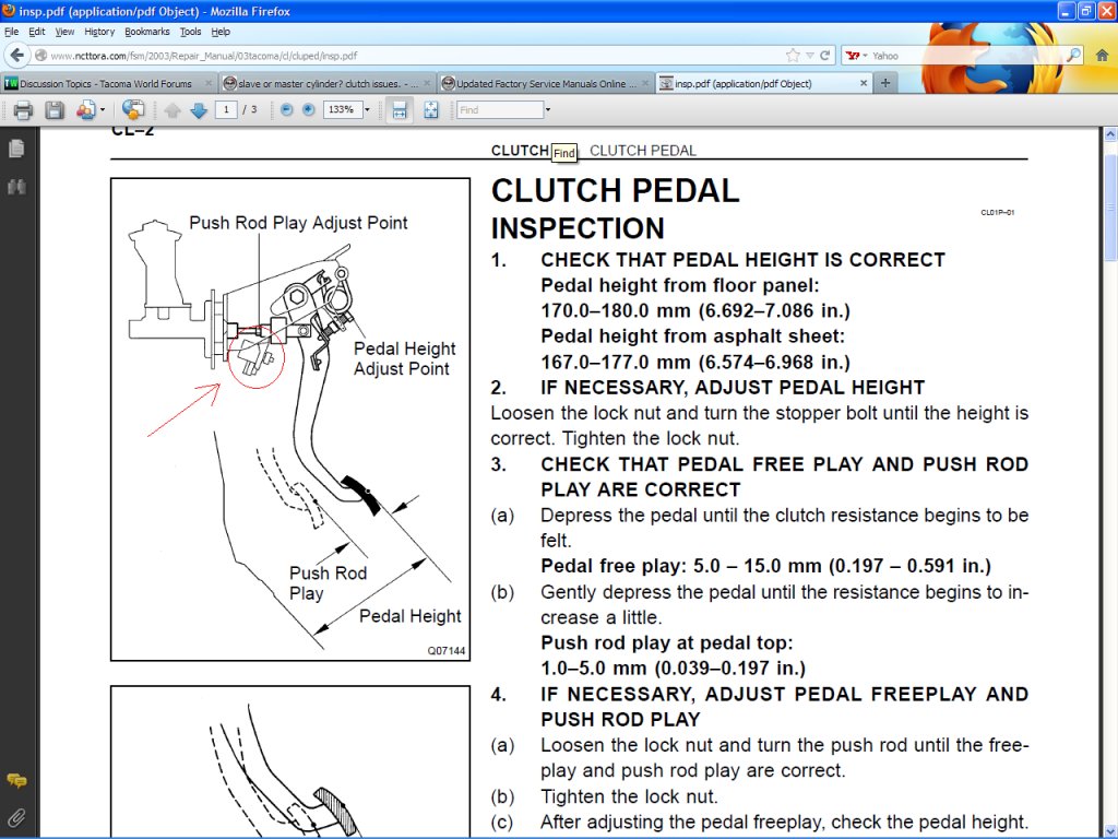

    possibly an over ride for the "clutch cancel" foot pedal/lever switch ?
    Does your clutch pedal have a switch mounted behind the clutch lever ?
    should make contact when the clutch pedal is depressed to the floor.
    ^ should be wiring to that if it's functional.
    Was originally... two options
    clutch cancel was done at the clutch pedal/lever (switch)
    or the clutch cancel button located on the dash.
    would not start unless one of those were engaged
