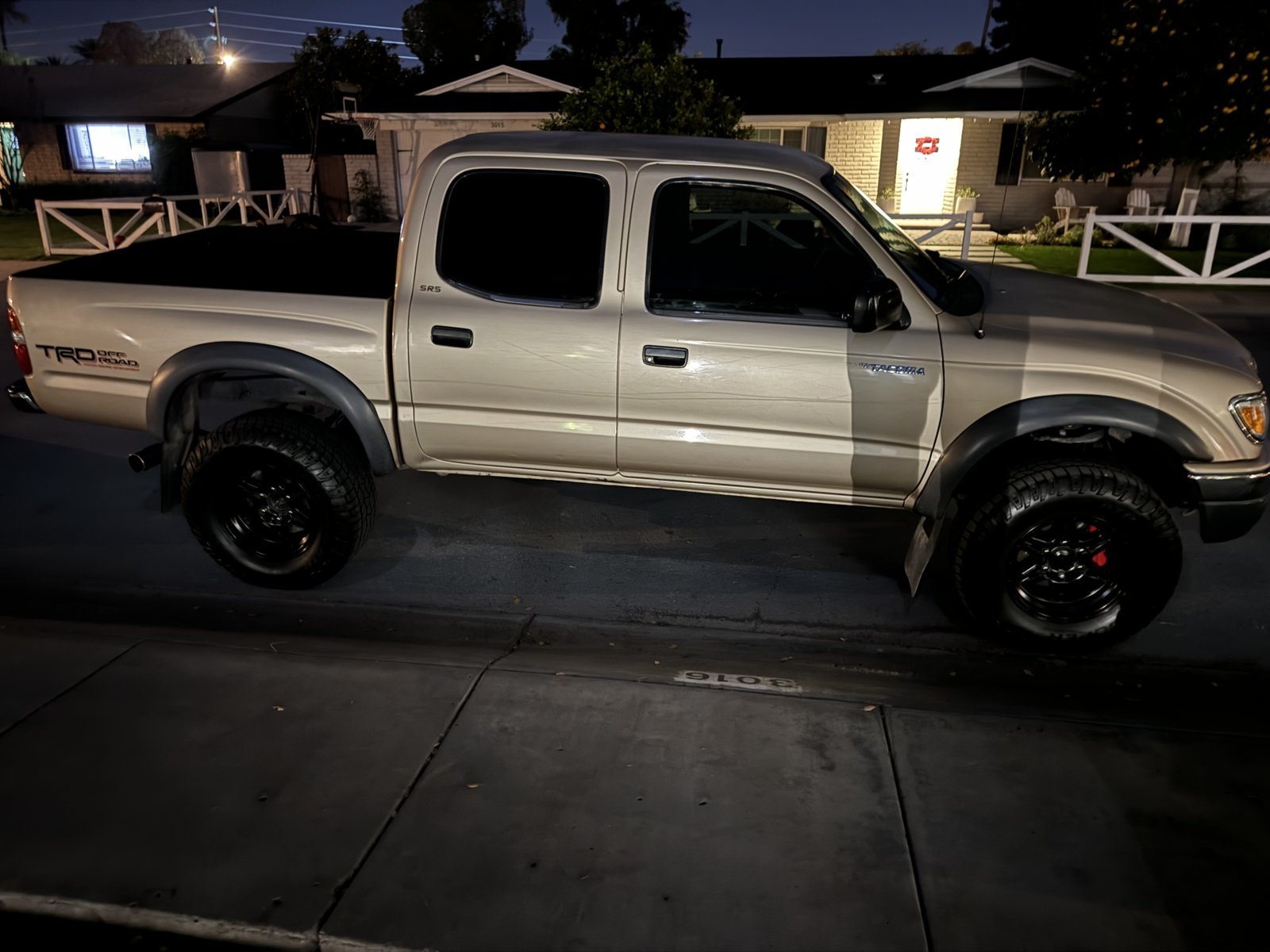

    So, 2004 tacoma double cab 4WD, 157k miles, last time serpentine belt was replaced was at 57k. Weird whining noise started after i went for a pull with my friend while on street, probably hit 5k revs in 3rd gear now this whining motor like noise is happening while idling and most noticeable when in 1st gear when you hit the gas from complete stop. plz help. Here’s the link for the sound > https://youtube.com/shorts/9REp63ydpOI?si=93dZFuV0DVn23cP9IMG_5937.jpg
