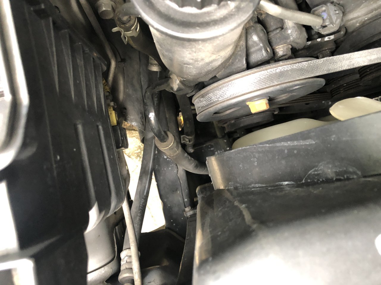

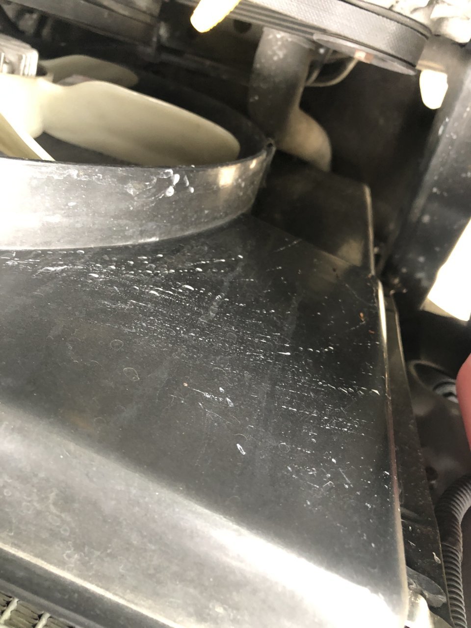

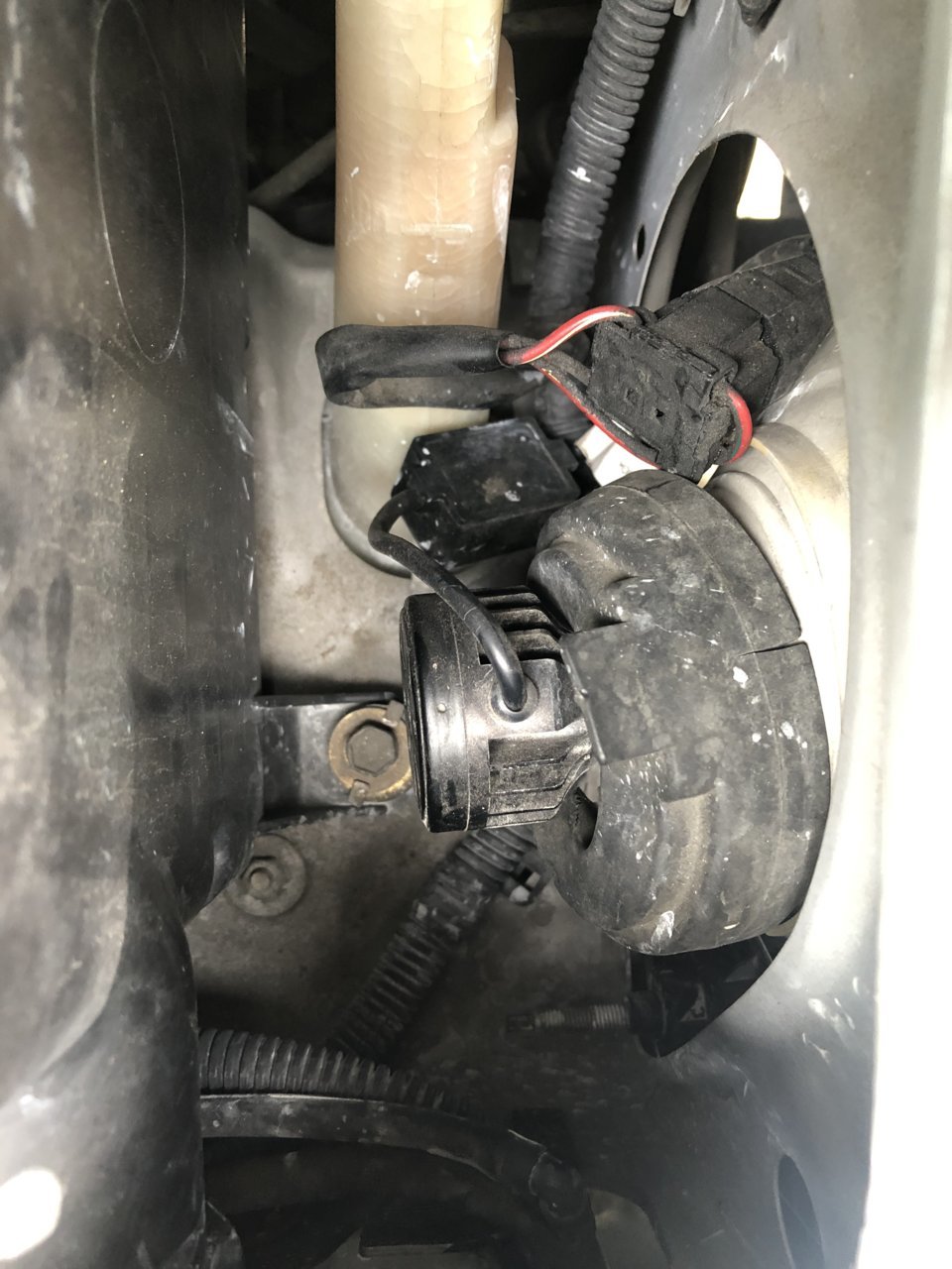

    Bought my 2001 prerunner 3.4l about 3 months ago and I've seen this white liquid almost everywhere on my truck (I even found it inside the door when I took the panel off. It wipes off with a damp towel no problem.
    Anyone have some ideas on what it could be?
    Has something broken that needs fixing?

    Soap residue from a car wash?

    Looks like dried coolant

    I would say soap. But the radiator could've exploded and done that to and maybe got in the door jambs. My cousins jeep did that and sprayed rusty antifreeze all over hers worse than that.

    radiator coolant.... check for any cracks on the top of the radiator while the engine is running at operating temp, or better yet, borrow a radiator pressure tester from you local auto store. If theres a crack, coolant will slowly seep out while pressurized and drops on to the spinning fan causing it splatter over the engine bay.

    Dried soapy water is my guess. Wash it all off see if it comes back..

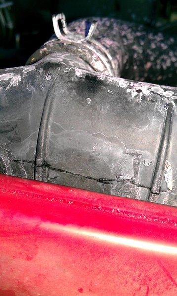

    Thats what I thought too. Here is a picture of how my radiator failed OP.

    I'm saying coolant, too. Not inside the door, though. Inside the door is something else.
    But I'd bet near anything that under the hood, that's coolant. Clean it off. It'll come back. Then you start chasing the leak.

    If this were coolant residue, you would see much higher concentrations of this near the radiator or coolant hoses where a leak would be, like Wyatt's pic above...
    That doesn't really seem to be the case here. I'm betting it's just soap residue or crap from the road.
    If you're concerned about it, clean it all off real good, then see if it reappears.
