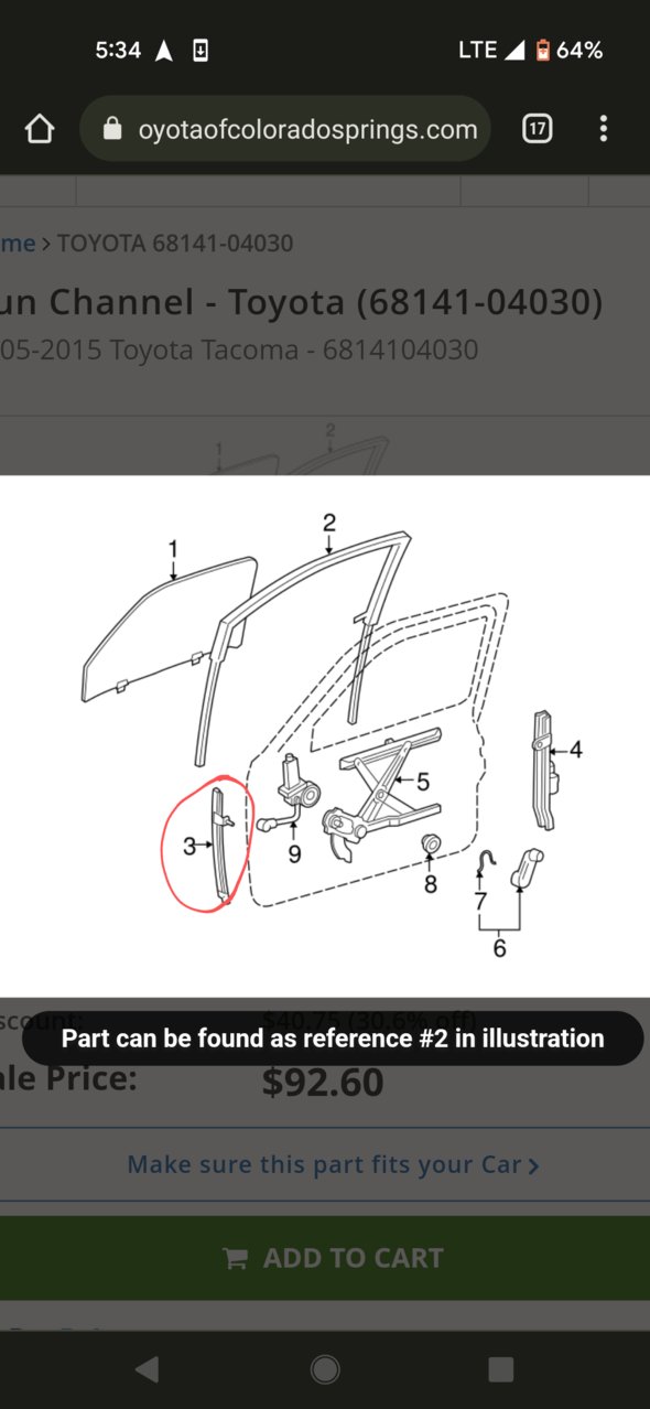

    I almost feel like the actual issue is the piece in the pictures you showed me highlighted 67401/ 67402 2015WhiteOR. After googling what it looks like in actual photos I'd be more inclined to believe that is the issue. I believe those are labeled guides. Are these the ones you guys are talking about which are suspect in their potential "cheap build quality?"

    Oh no, I know where the regulator is and what it does. Haha. What I'm asking is if the item I circled in red is the guide in question which is possibly worn out, or if it's the entire run channel piece that is most likely done for?

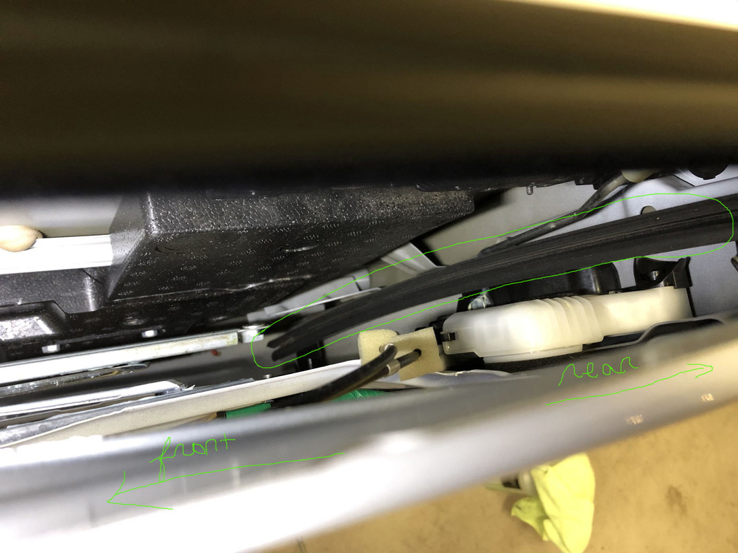

    Here is a pic I took a while back while I was diagnosing the jiggle on my front passenger door. The highlighted thing is the guide channel where the glass sits inside. The bracket you had circled cannot be seen but I think it does not actually touch the glass at all.

    I had this issue for a long time and it pissed me off quite a bit.
    Ended up taking a small piece of plastic from any generic packaging (the kind that sucks to open without cutting yourself) and folded it over to make a kind of v-shaped spring about 2" long. Jammed that in behind the triangular trim piece down in the front corner. That forced the guide or rubber or whatever it was to take up the extra space and prevent the window from rattling.
    Really wish I could find the pics I took, it would be much easier to understand but no idea where those are. I found pushing on the glass with the window partly open (same conditions that rattled on the road) I narrowed it down to that small vertical section in the front. I think youll understand if you do the same.

    Took the interior triangular trim off and put it in there. Probably wedged between the door and #2 in your screen shot above, not #3. Like I said I was able to easily recreate the noise just by pressing or tapping on the window and narrowed it down quick
