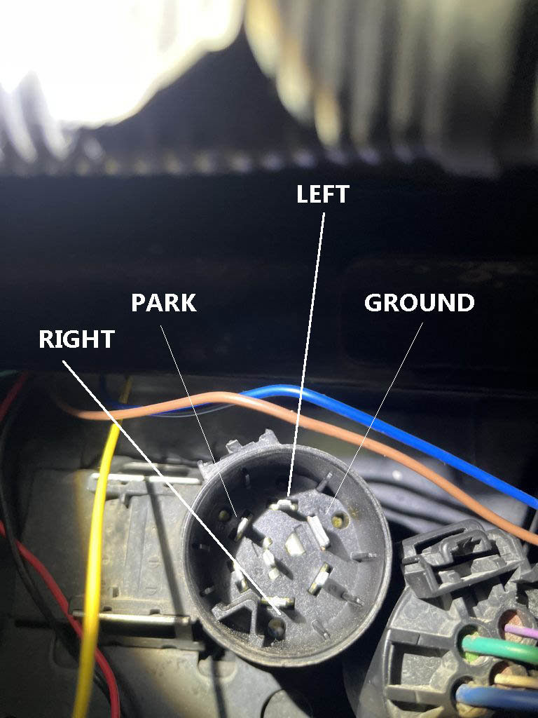

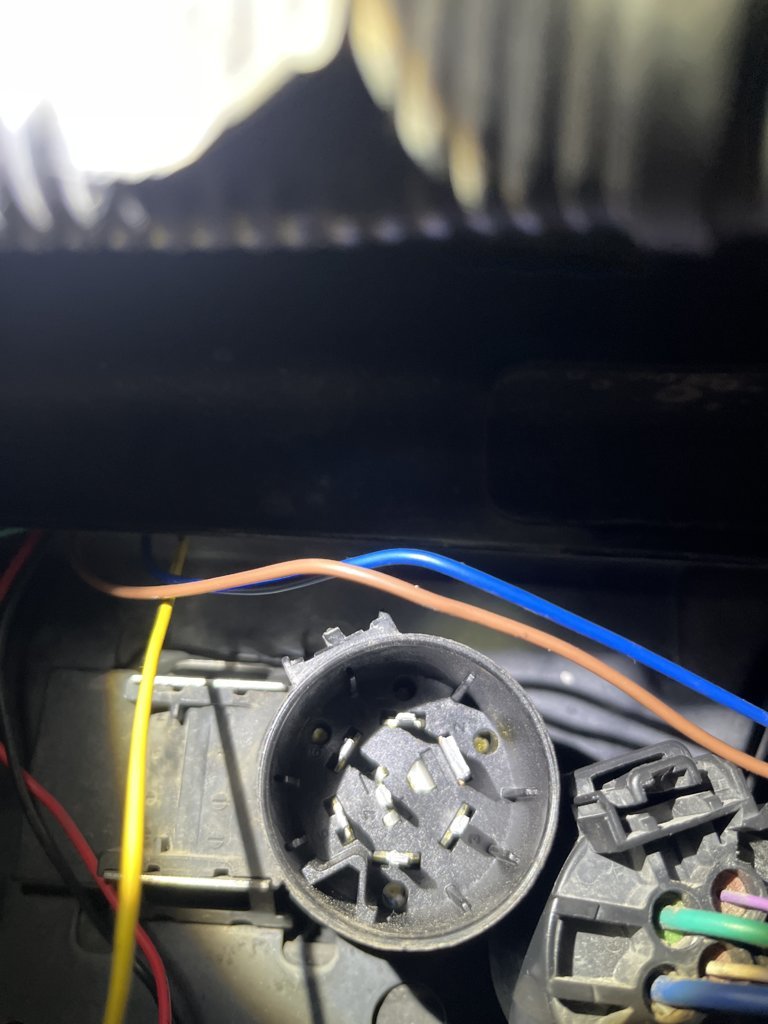

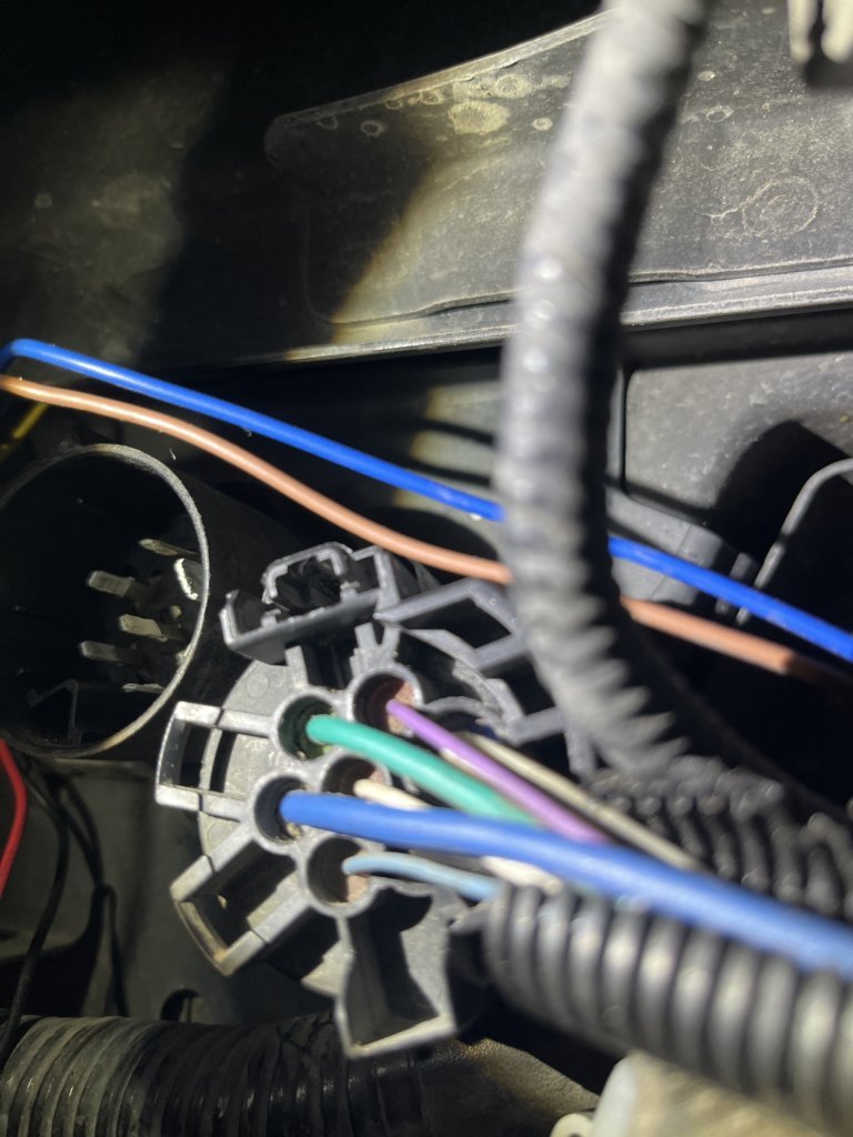

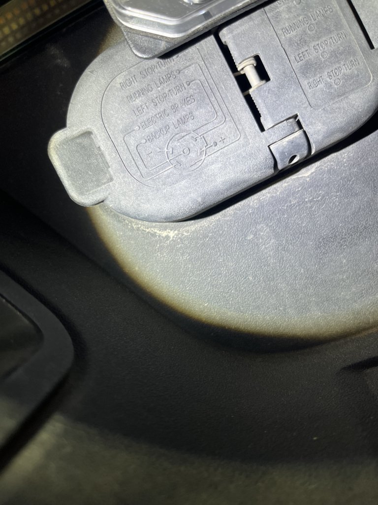

    Weird wire colors and lots of confusion for 7 pin trailer plug… which wire/s are for brake lights (or LH turn/stop and RH turn/stop)? I have multiple white wires, blue, green, pink, brown and black. The snap pin that holds it is also at the 11 o clock position…

    I need to tap into the left stop and right stop for rear emergency lights. I figure it’s the light blue and pink wire…. Am I correct?

    For just stop circuit, tap the rear lights, not the towing wires. Towing mixes stop n turn. (on 4 pins & 7 pin outlets)
