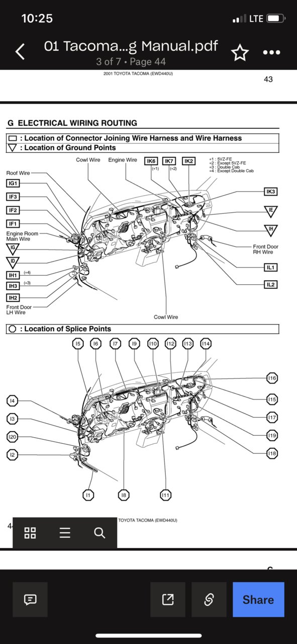

    The clocks are kinda flakey anyway, but the radio shouldn’t be doing that. That said, if they’re doing it together, that could mean something.
    Should be grounded behind the kick panels:
