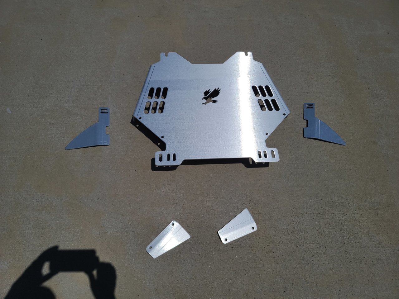

    I wanted to get a cat shield for peace of mind, especially since I park in a parking garage every day for work. This design was my favorite of the ones I saw and the 1/4" thickness was a pretty big deciding factor. I also really liked the design of the front skid and figured might as well just get it all! There was a little mix up with the first shipment, but @Talon2006 got everything sorted out super fast!
    Install was relatively quick and easy for everything, even though I had already installed the cat shield prior to the front skid. It would have been even easier to do it the other way around... I was just too excited to wait. :D
    Thanks for an awesome product and customer service, @Talon2006!
    Comparison to stock "skid" thickness:rofl::
    Side note: It even made the cat happy with the included cat toys (packing paper)!

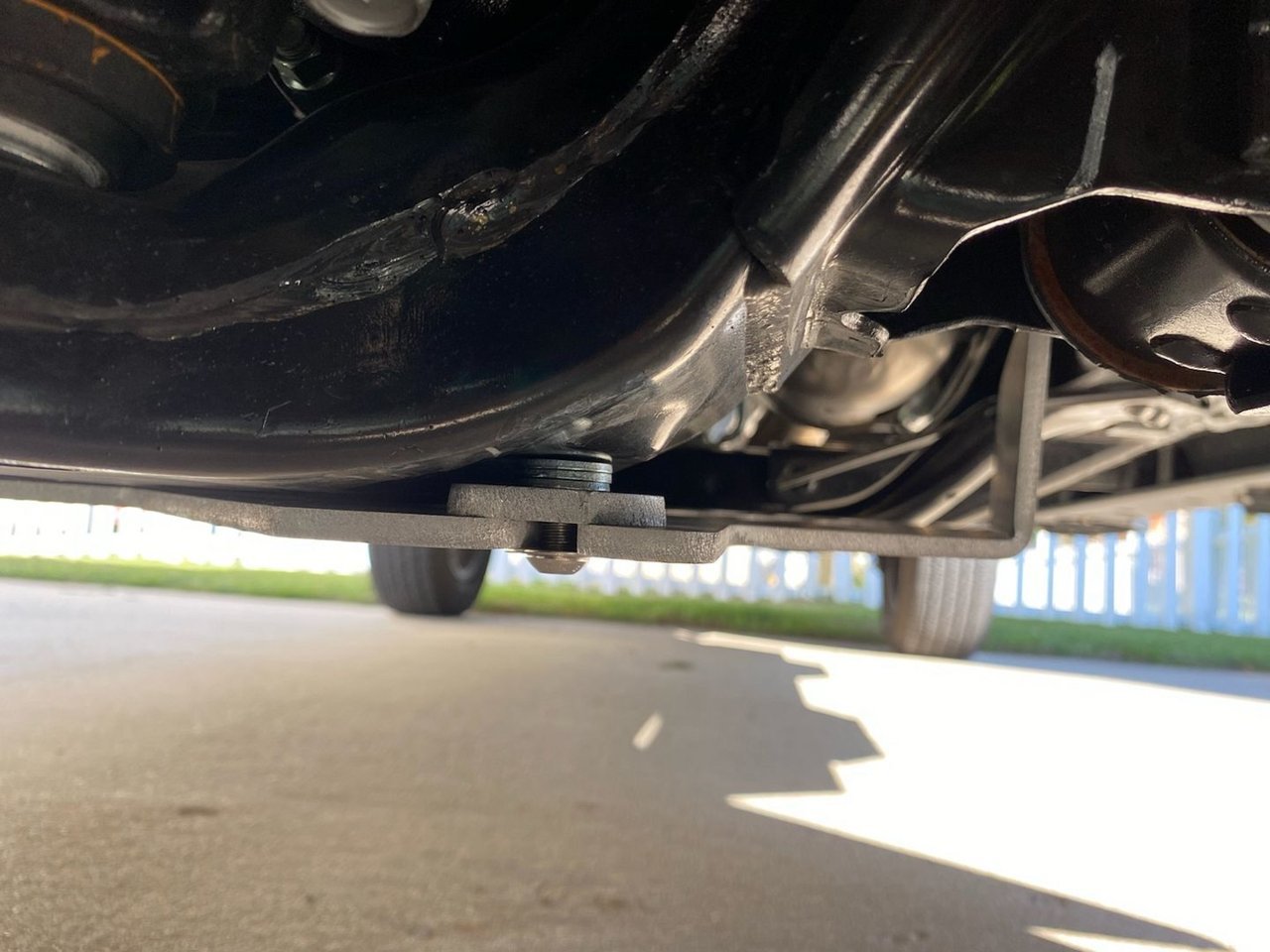

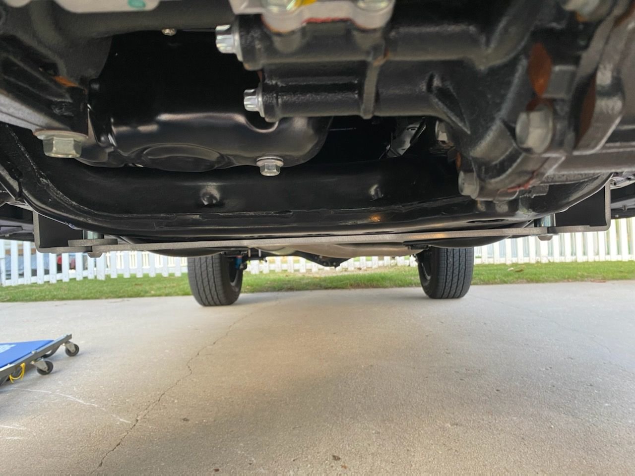

    Here's one side of area in question:

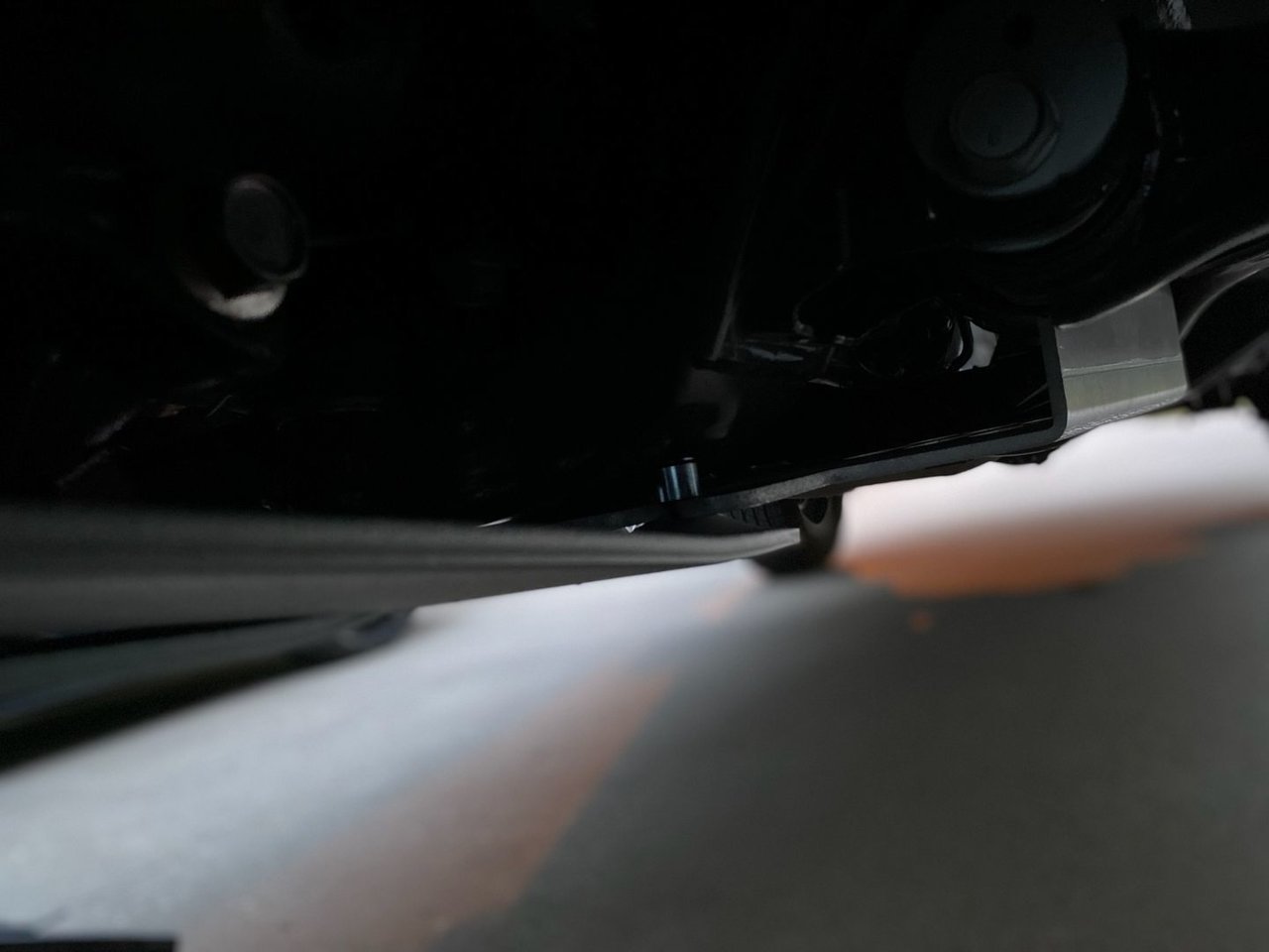

    You only need them for the two points where the Talon and the TRD Skid meet. It depends on which spacer will fit flush against the frame.
    Take a look at this pic and see the difference each length makes. The wider spacer makes it bow a little while the other is more flush.
    This was trial and error before the two spacers were sent to me.
    I was using some washers with the big spacers initially sent with the TALON.
