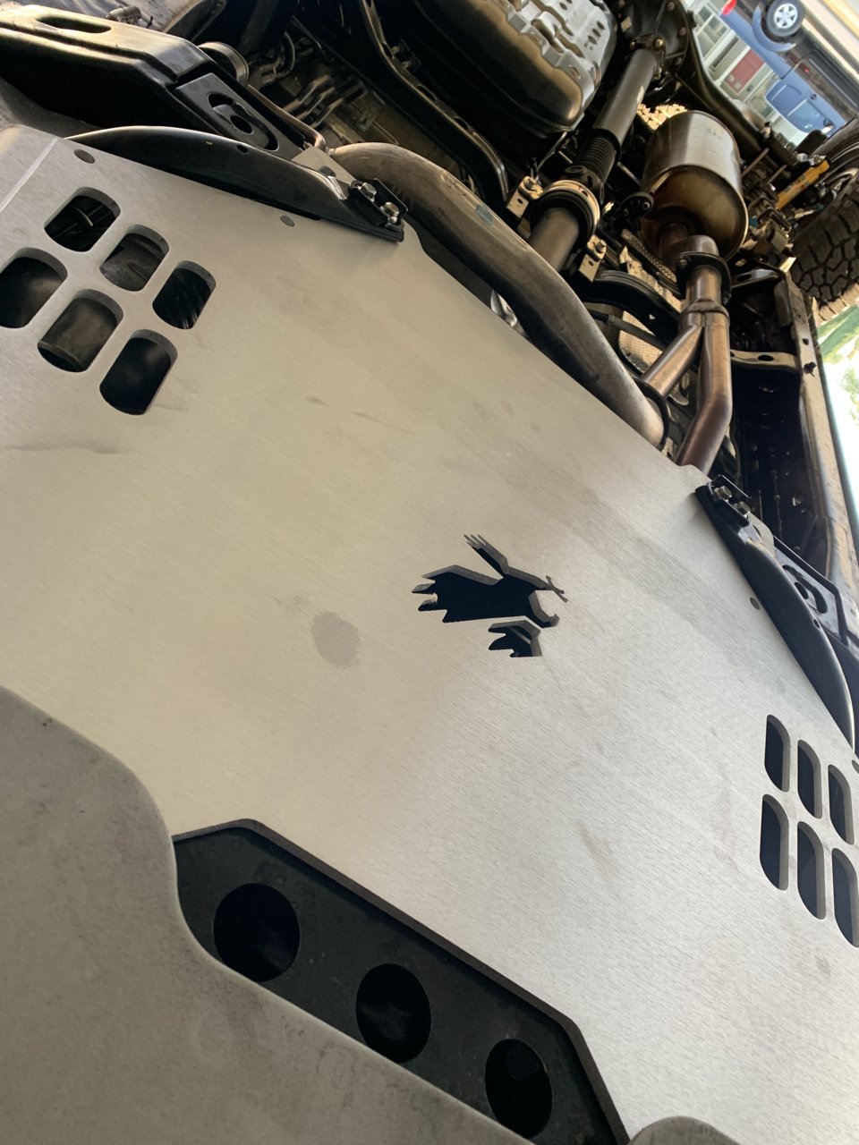

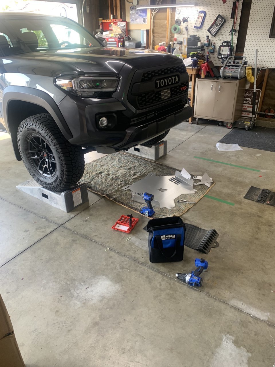

    This was before I got the TRD Skid...as you can see it's only the TALON skid in the pic.

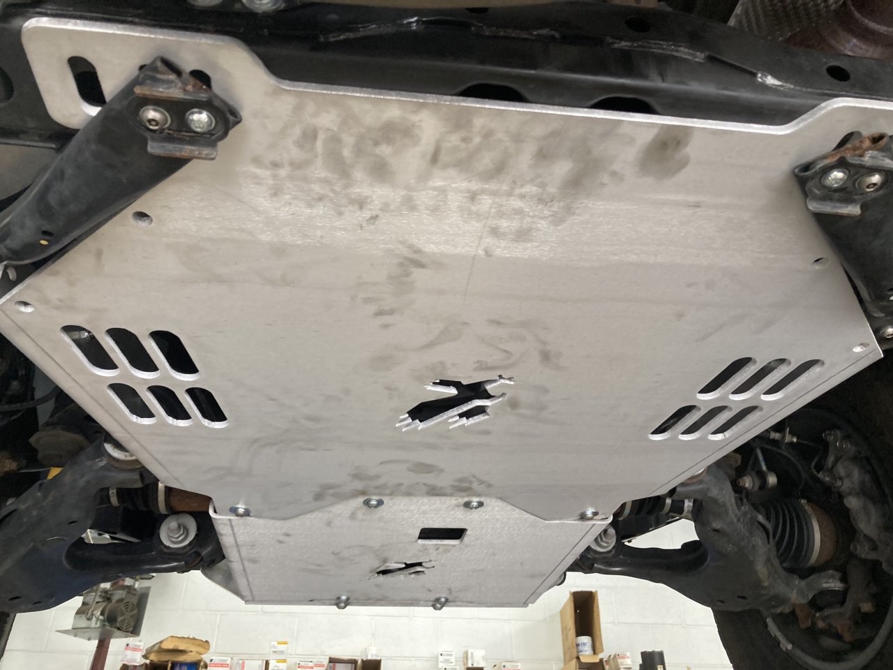

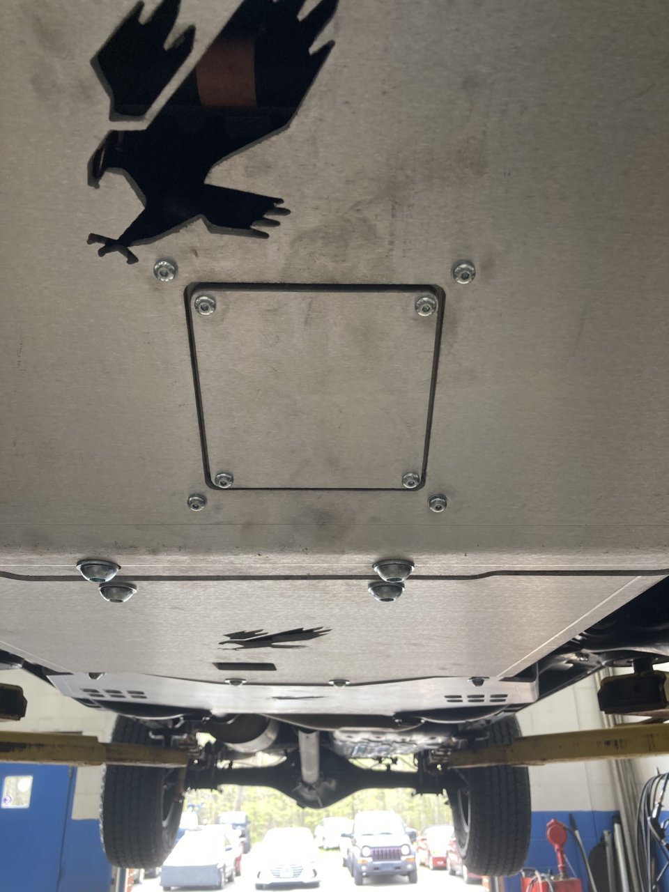

    Got mine installed today. Great product!

    This is a great product! I do not plan on paint them, used some Never Seize, took me a little longer than I thought it would to install, but I usually have a tough estimate w/time...I'm usually wrong! Great fit and I feel very protected. Went w/the Cat-protector and the skid plate. A friend has a shop so it was way easier to use his lift than lying on my old back in the driveway. Just need to clean them up post install and good to go! Thanks Shaun & Crystal...B.fore.jpgback.to.front.jpgfront.jpg

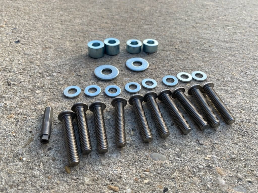

    Hi everyone - this thread is super helpful but I rec'd my shield and opened it all up yesterday and I am still confused. Hoping to get some clarity. This is for a 3rd Gen Tacoma with TRD Skid Plate.
    1. I rec'd 4 of the large spacers. I think I only need to use 2 of them?
    2. I did not get the security bolts. I cannot find specs on the standard bolts or details if I treat them differently or not, but based on other comments some people reference the differences. Are they standard steel? Zinc coated? Do I still use Anti Seize on them?
    3. I rec'd 2 larger 1" OD diameter washers. Where do I use these? I assume it is on the area where the shield gets wedged between the body and the skid plate? If yes, do I also use one of the smaller washers between the larger washer and the bolt head? The ID of the larger washer vs. OD of the bolt head doesn't seem ideal so again I am assuming yes.
    4. If galvanic corrosion is a concern due to dissimilar metals, am I wise to somehow treat the areas where the steel washers meet up with the aluminum shield? If yes, what do I treat it with?
    5. As I lay everything out, I have 4 extra small washers. Is that intentional. I have one per bolt including the area I mention if #3 where I use a small washer and a large washer together. Plus 4 leftover?

    My post# 56 on this thread shows what I received. You'll only need two spacers but you must see which one fits snug onto the frame.
    I used some washers to make up the difference before I got the spacers above. I bought the security bolts & adapter.

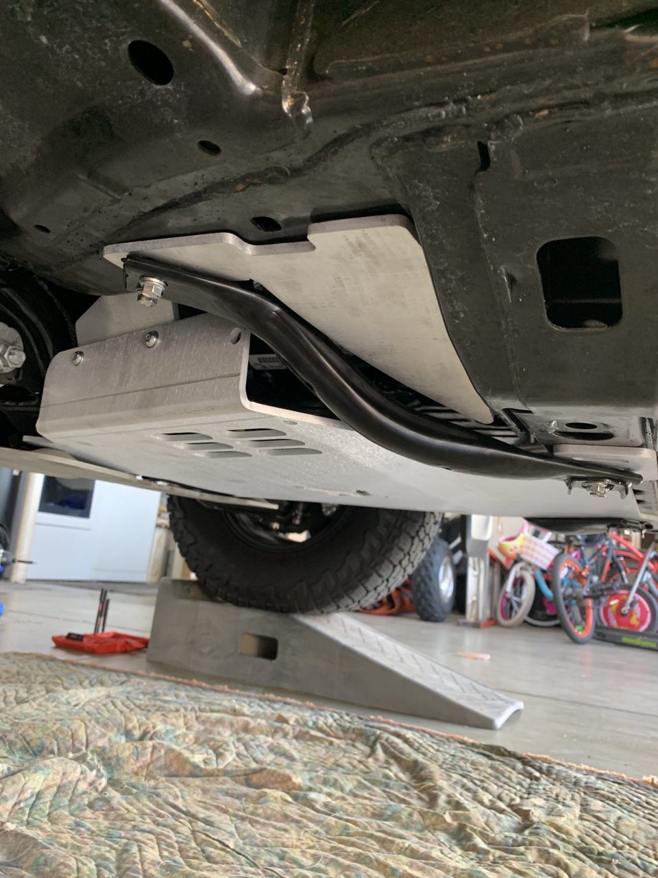

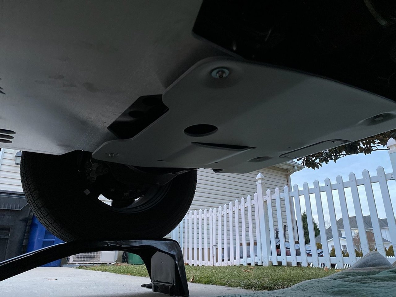

    This is what it looks like with the TRD Skid attached:
