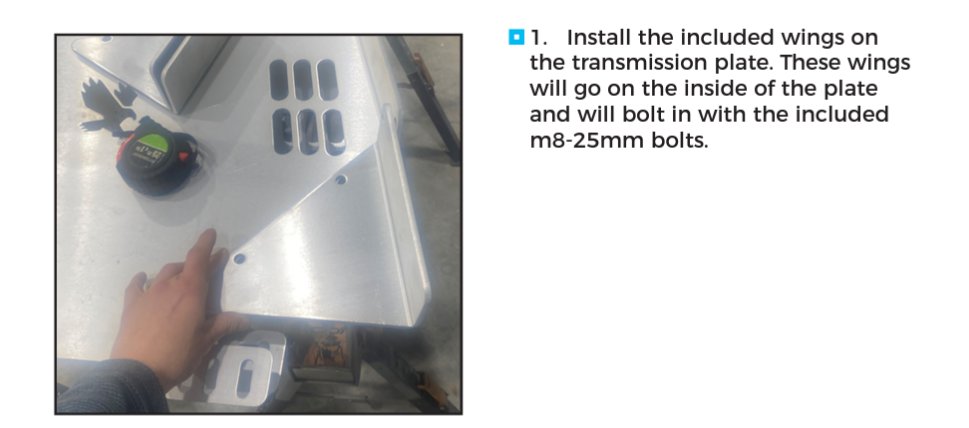

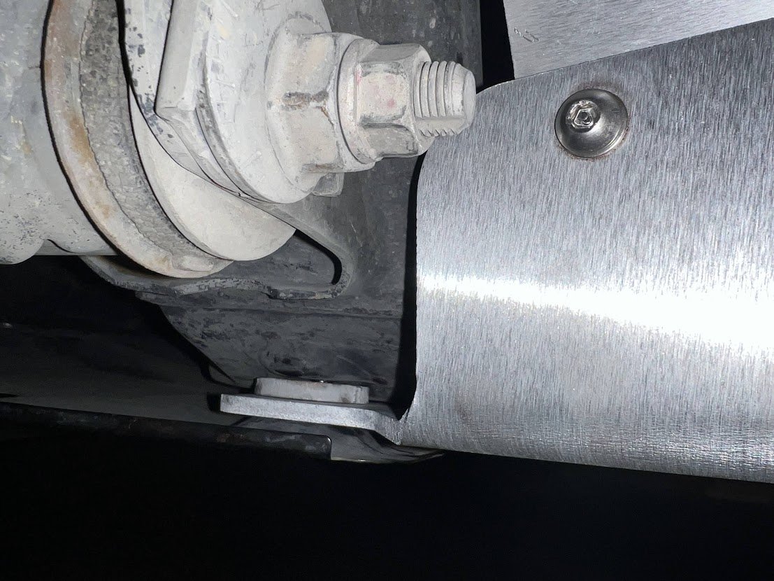

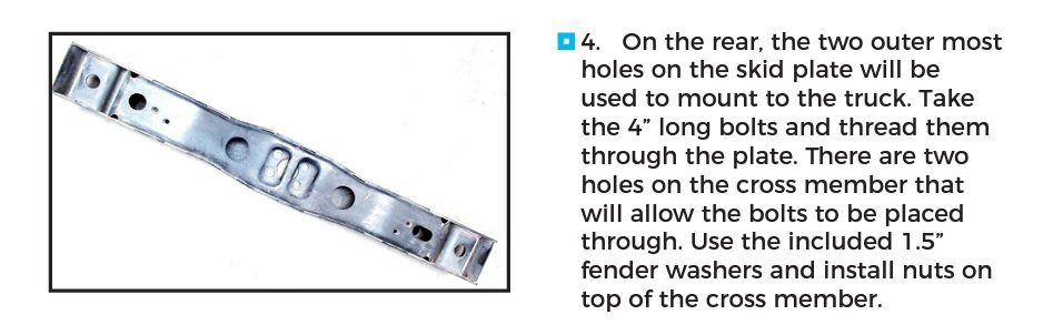

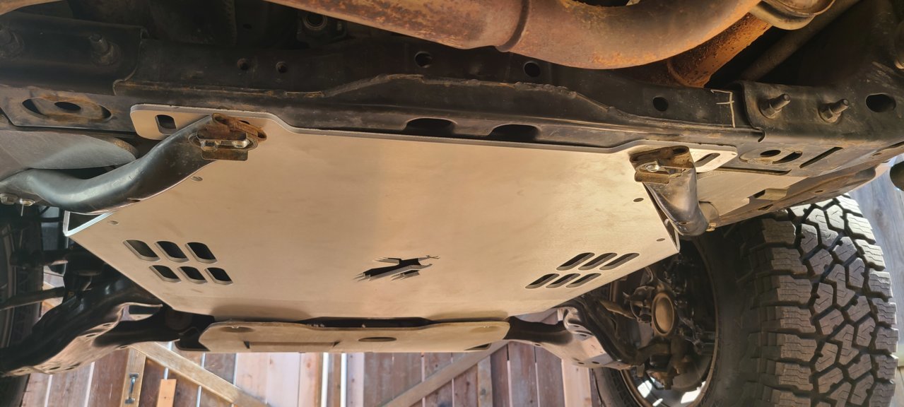

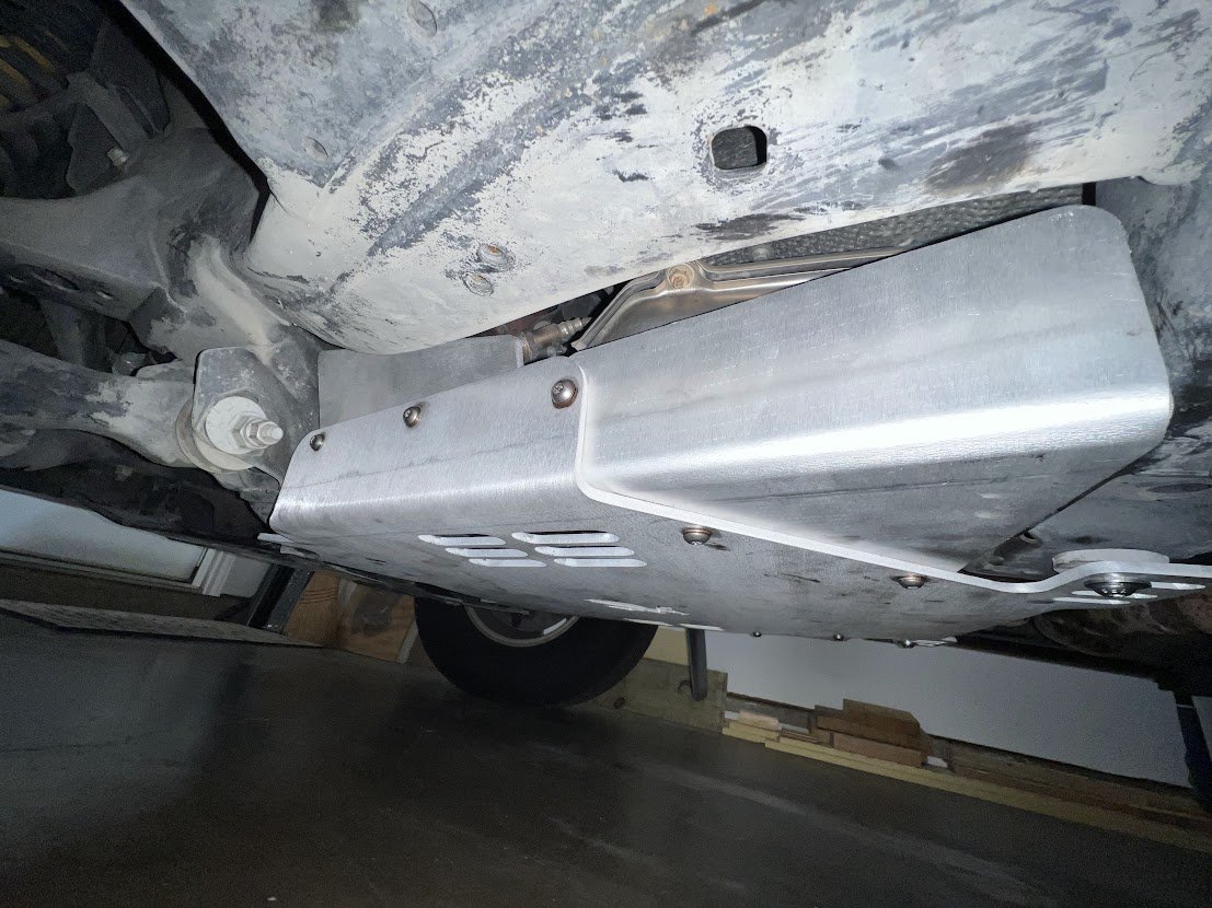

    Well I got it installed. I did source some security hardware since Talon's was out of stock the moment I placed my order. It was a bit of a pain in the rear. Most of the pictures on here and the only video I could find are the 3rd Gen, which is different than the 2nd Gen Tacoma's. I did put copper a/s on all the bolts for lubrication as well as lock washers on the bolts that did not have a lock nut, (two up front)
    This first pic and example in the instructions should really say, "loosely" install hardware. I installed the wings first off the truck, like the instructions seem to call out, but when I tried to put the whole thing up on the truck, those wings were hitting the frame, and wouldn't allow the back end to go up, so I had to take the whole thing back down again to loosen those 6 bolts up for adjustment.
    The big aluminium washers included, it wasn't clear if two go up front, or 4 or as needed maybe none. So I put two on each side first, up front, and the back end had to be stressed badly to lift up and meet the cross member, so I thought no way that's right. I tried it with one on each front bolt then put the other on the rear bolts. The front skid plate did need to have my tab cut off as mentioned, so I did that no problem. I ended up putting one of the big aluminium washers on each of the rear bolts.
    Attaching the back part was a bit confusing, because the instructions say to thread the bolts through the plate (cross member), that part should probably be removed because I kept trying to thread the bolts somehow into the cross member, whereas the next step say the bolts are placed through, which really is more accurate unless I am missing something.
    I'm including a couple photo's since most of what seems avail out there is 3rd Gen installs, a finished picture of the back end would probably help take some of the confusion on how the rear is installed when finished.
    Let me know if I've done it wrong somehow, and we'll work through modifying it.
    Thanks...
    Russ

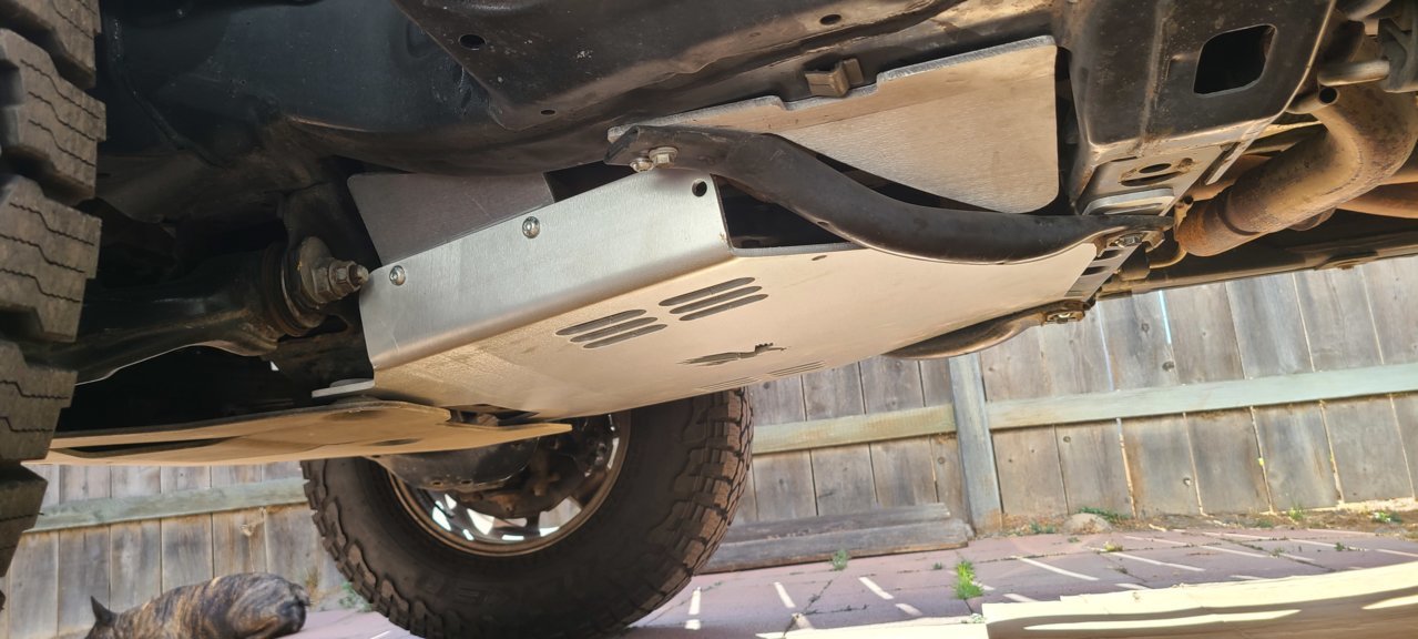

    20220727_155814.jpg Super happy with my skid plate. I bought this for Cat protection (a lot of thefts in the neighborhood lately) yet I run skid plates of the same nature covering the transmission on my other off-road trucks so essentially this was a something that met the bill. I love how the Talons plate matches the TRD skid in terms of thickness. The only thing is I didn't have confidence in was the Allen head bolts due to the "softness" and possible stripping them and ran anti seize on all of them. Torque on the instructions said 120 inches per pound which is 10ft pounds and even though I tried for a little bit more the allens did start to round. What I ended up doing was just alternated the Allen's and the stock bolts for a little bit more confidence yet still security. Overall though I'm super happy with this setup. Like I said it matches my TRD skid plate perfectly and I beat the crap out of that thing and it still holds solid so I think this should do the same.20220727_155748.jpg

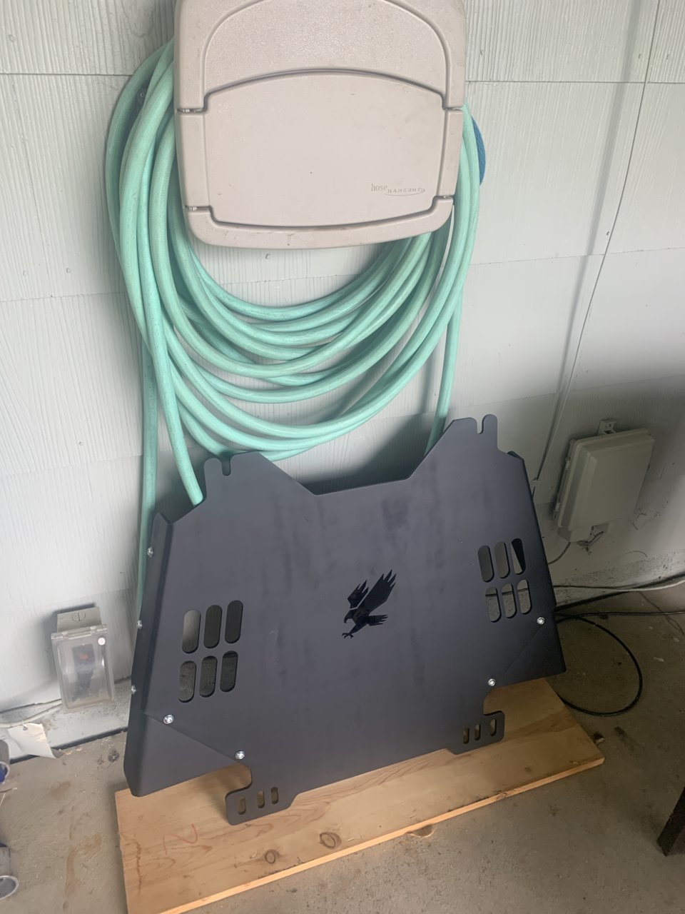

    All painted up and ready to install..
    I may have to modify my SOS ifs skid
    We’ll see…
