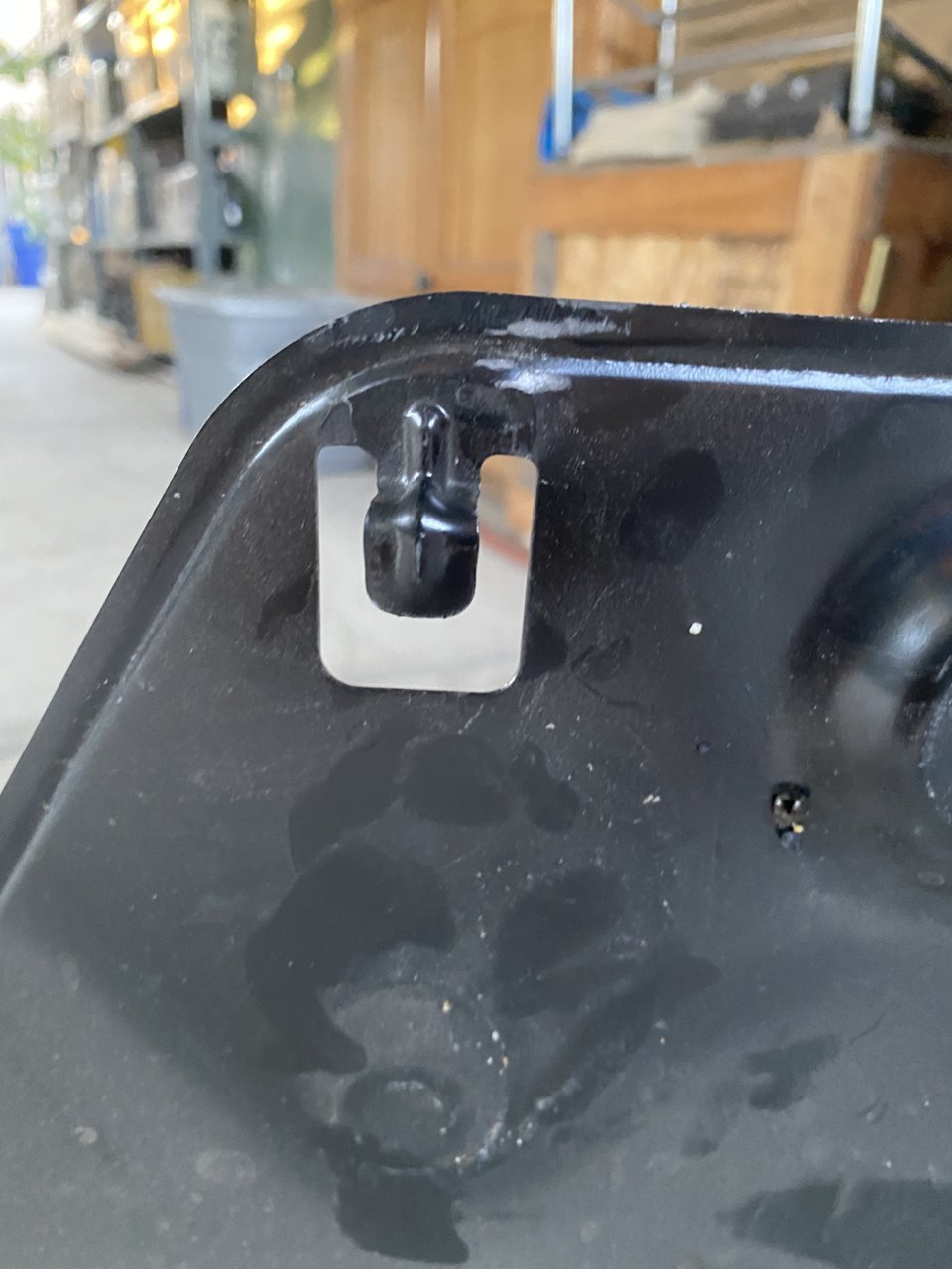

    Just installed my shield today, had this same issue on my 2018 TRD OR. I just bent the hook down with needle nose pliers.

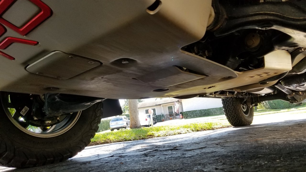

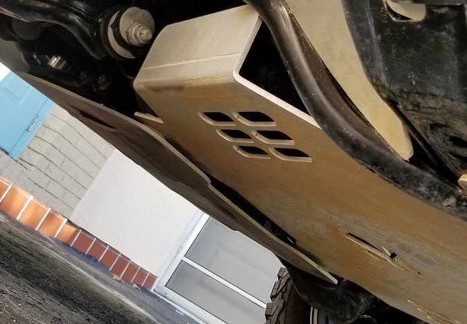

    I have it installed with TRD skid and it came with everything you will need for a good fit. Of course it won't be 100% flush, but the fit is good. The only thing I opted to buy was x2 M8x1.25x50mm bolts to replace the 12mm stock bolts only because I wanted bolts on the back 2 TRD skid mounting points instead of hex head bolts (totally optional and not necessary).
