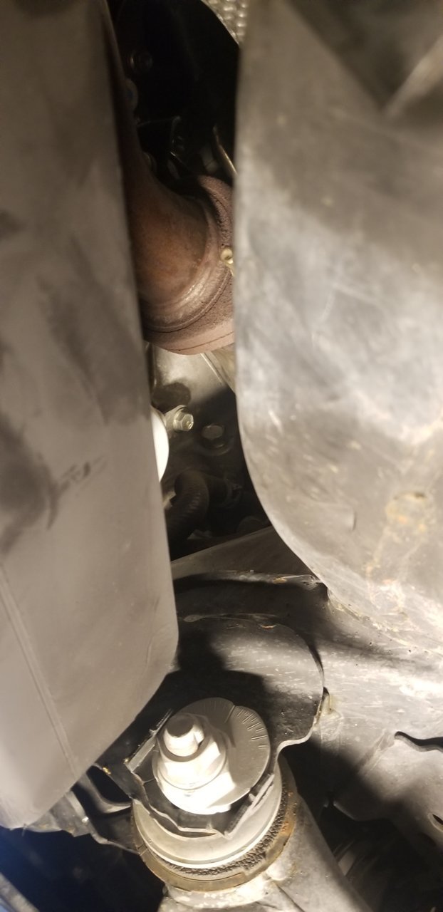

    Here's a BEFORE view of the area in question.
    The two "indented" areas where the bolts will marry have that extra space in question. Not sure if prior year 3rd Generation Tacos have the same indentations (but I would imagine they do) to make up for the flush spacing I wanted flush against the plate.
    The flat spacer that comes with the Talon CAT plate filled part of the space but not all. That's where I fit tested the 3/8" & 1/2" spacers Talon Garage sent me. I ended up using the 1/2" spacer and not using the flat spacer that comes with the Talon CAT plate.
    My recommendation for Talon Garage is to send (4) 1/4" flat spacers (2 on each side) to make up for the 1/2" spacer that I verified fits perfect.
    Ed
    EDIT: this is the 3/8" spacer on the left and the 1/2" spacer on the right. See how the 1/2" spacer on the right fills the gap perfect as opposed to the 3/8" + the 1/4" spacer on the left? (Can you see the bowing too?) The Talon CAT plate sits directly on top of the TRD Skid plate so the 1/2" spacer will stay exactly where it's at in this pic using the Talon hardware instead of the TRD Skid plate bolts...which are not long enough.

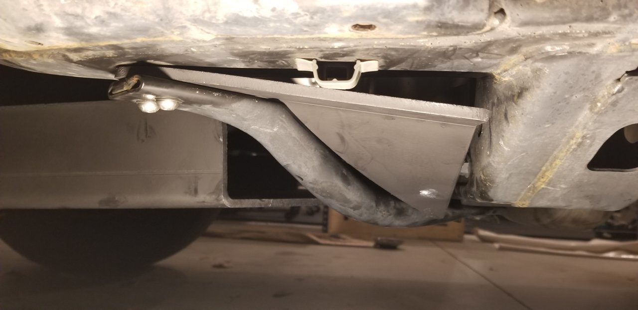

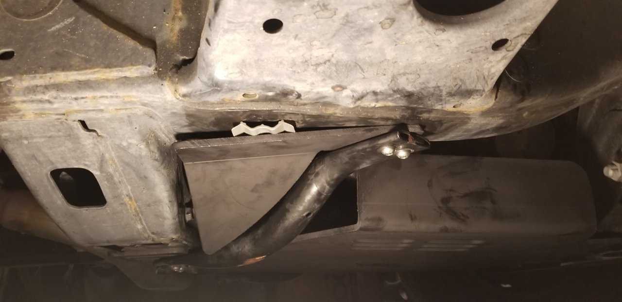

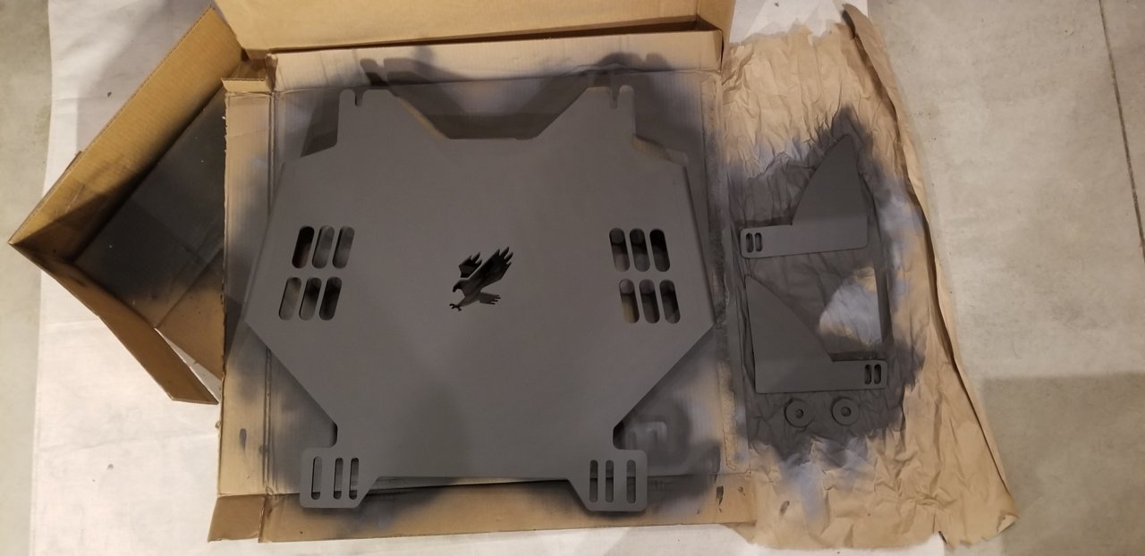

    RE spacers:
    I received only the 2 spacers that were a bit janky (it was not cnc'd and had very rough edges and was even rusted on one face of the piece, but not a big deal). I did not need additional spacers on my 2018 TRD OR DCLB (without aftermarket skid plate)
    Decided to hit it with some high heat primer and matte black paint, so at least would-be thieves can enjoy the aesthetics. More seriously though, I think it makes it blend in more and less obvious what is a protective shield (if it wasn't already obvious). The bare aluminum finish was actually really nice, but I just painted it for fun and to add some rust protection.

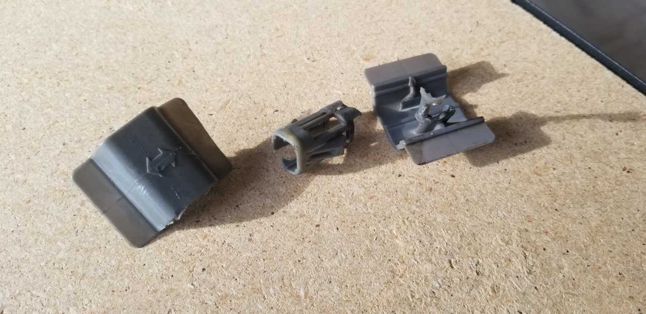

    Not sure what these plastic pieces are, but I ended up removing them with some snips and pliers. Snipping it correctly can prevent part of it from getting lost in the hole, but not a huge deal either.
    Happy with the quality and fit of the shield and the protection it provides. Is it 100% protective? No, I'd say it's 97%+ protective, but it will definitely make a thief move on. I would also recommend the security bolts for another layer of security (it's not a 100% unique bolt head, but it a non-standard one, which is sufficient). Great customer service, fast shipping, reasonably priced, 1/4" aluminum, easy install! I definitely say BUY!
    This is about the only way to cut the upstream end of the cat and you'd have to cut through that flange. Seems sufficiently difficult:

    Interesting about that plastic clip. I was able to maneuver the winglet around it...but good to know that removing requires some intricate cutting!

    Yeah, I'm not sure. I definitely tried and you can tell from the photo the wing is as far turned in as possible. Maybe there are different chassis out there, which might explain some of the minor differences we are experiencing.
    Maybe I didn't try hard enough.. I probably need to loosen it a bit more to clear the plastic or something.. oh well. I wonder what it is for anyway

    This thread explains what the plastic thing is for.
    https://www.tacomaworld.com/threads/what-is-this-part.739453/

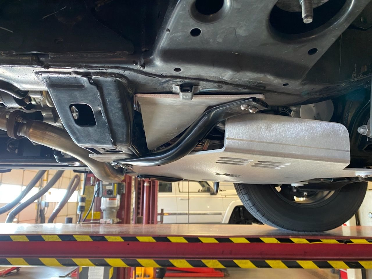

    I cut the Talon “wings” to leave the plastic things intact. Here’s a shot:
    This whole setup is a very nice product. Thank you, Shaun! :)

    Looks good. How did you go about cutting them?

    I was able to position mine at a different angle that avoided that area. Maybe that's why it looks awkward to some...but I made it fit, just like you did!
