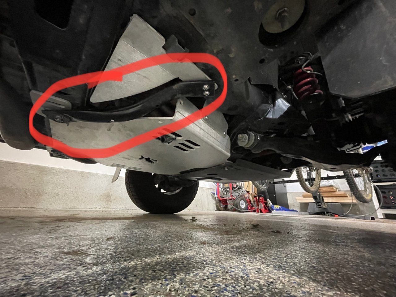

    I’ve been debating in getting these as well but as you mentioned, 2ND Gens don’t have the braces so the wings kind of looks out of place and i feel they need to connect to the cover somehow for rigidity and protection. Just looks odd with the space in between. @Talon2006 would it possible to extend the 2nd Gen covers to eliminate the wings?

    That is basically what I did for the second gens. https://www.talonsgarage.com/_files/ugd/e80c86_358945c63a8c46d5b75f0dee0bdc800f.pdf
    I have sold a few, but didn't get my install guide up fast enough so it was sort of a disaster. I am fairly sure the 4wd is still good to go, but am not sure if the 2wds have some variations across the years.

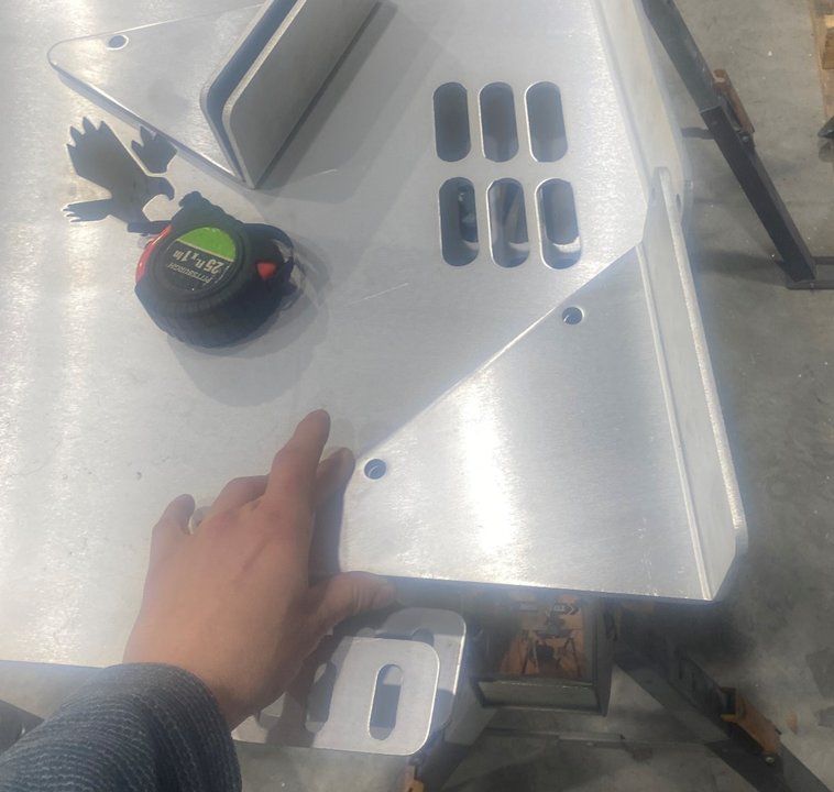

    These are the 2nd gen wings.

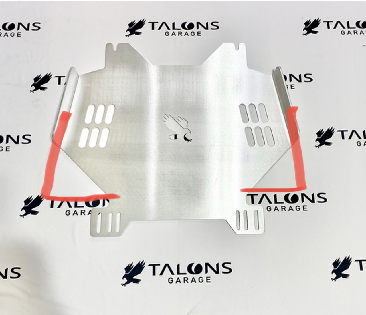

    Do these upper side pieces angle inwards or outwards?
    I'm guessing inwards, like this?

    I did mine outwards with no issues.

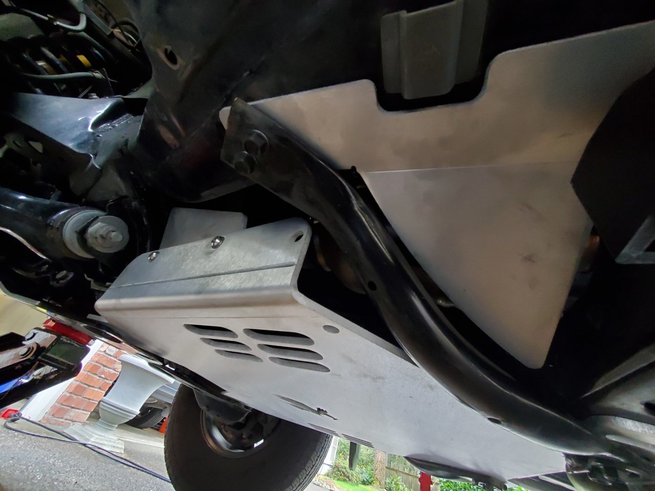

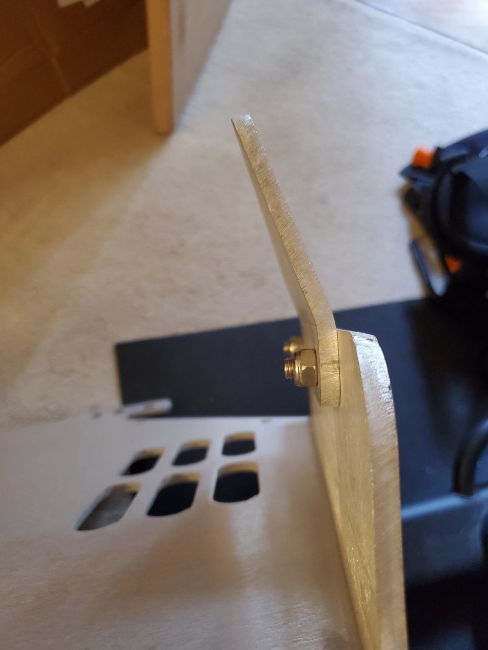

    Install was pretty easy, even with only one person. I greased the front driveshaft zircs first since they will be covered now. I replaced the hardware with longer metric bolts and brushed them with anti-seize so it will be easier to remove for future maintenance.

    Thanks! I switched them to outwards, seeing it on the truck that does seem correct. I wish the install of this part was shown in the instructions.

    Outwards
