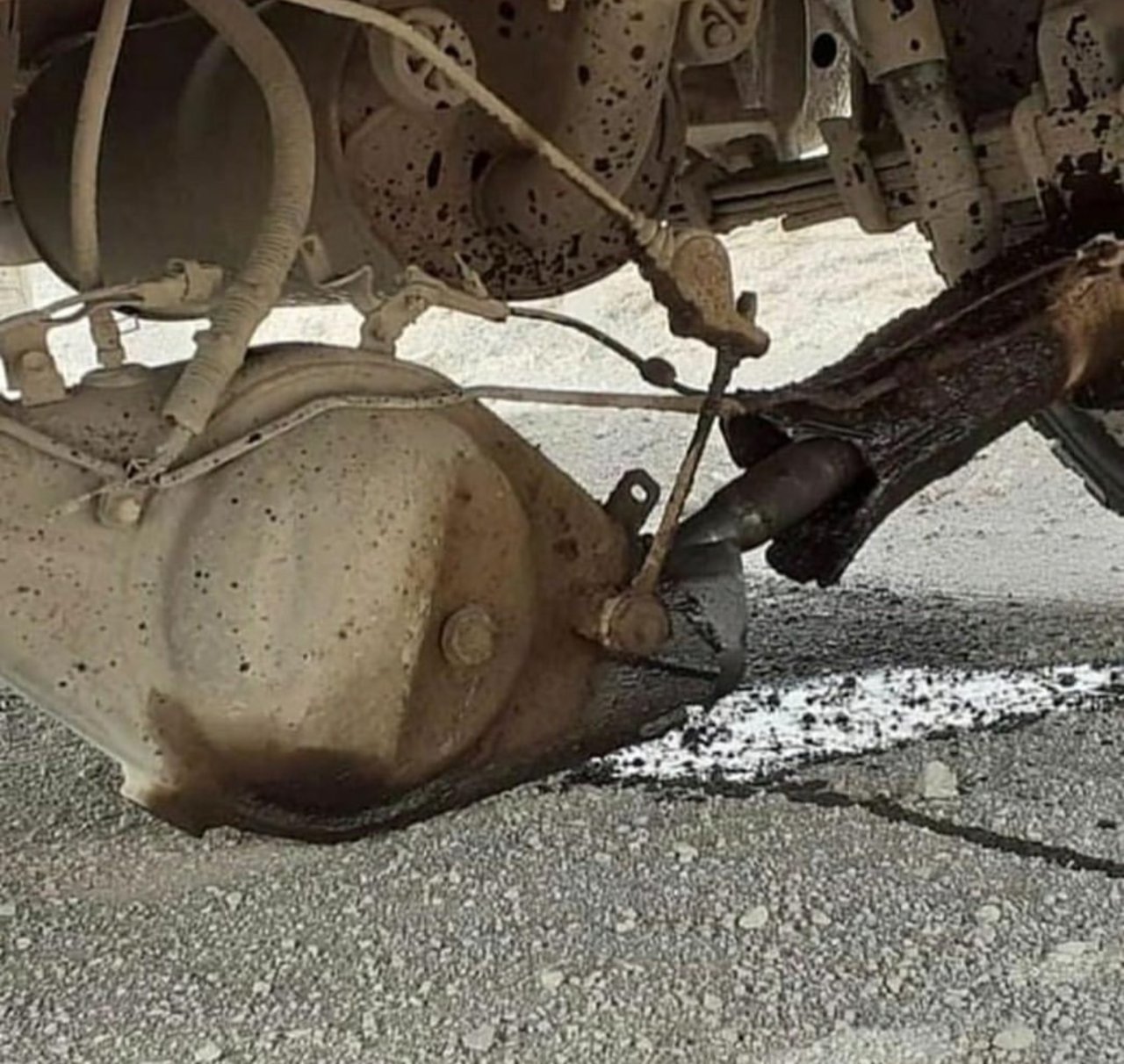

    It's fine... It doesn't need anything.
    sbx22, hiPSI, synaps3 and 2 others like this.

    18
    jeez. how big of a jump did you land for that to happen?
    synaps3 and gemiv19 like this.

    #300692
    484
    2019 Tacoma Trd offroad 6MT
    Not mine thankfully.

    Jul 30, 2019
    #300692
    484
    Customer: I was just driving to church next thing I know...
    Dealer: ....

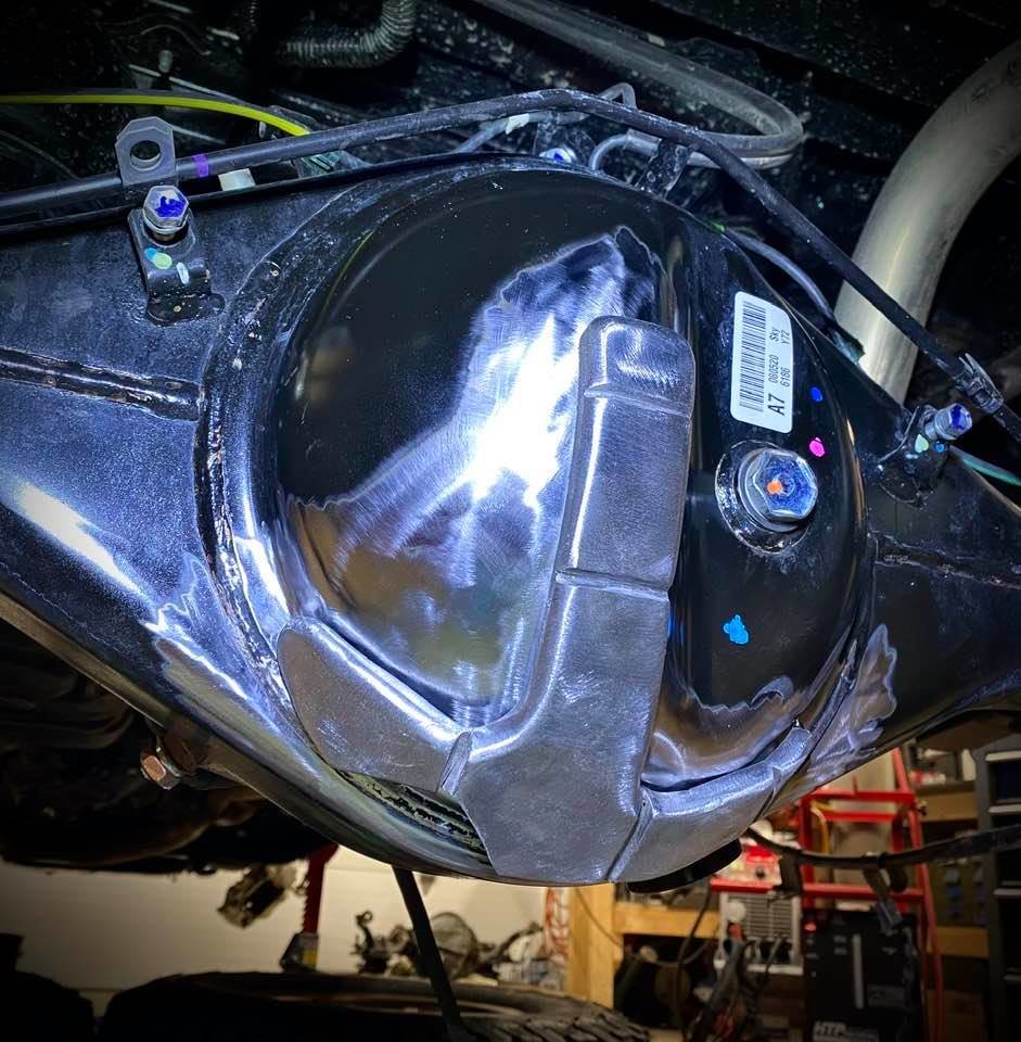

    Blueberry.Taco
    Blueberry.Taco blueberry.taco (IG)
    Sep 14, 2020
    #340806
    887
    Ryo
    Fulltime Overlanding
    Long travel house on 35s with a custom aluminum utility bed and FWC
    some welding required
    This is what I ended up doing.
    bought this
    which is for a toyota 9.5" axle, so it wasn't a perfect fit, but for $28 (when on sale), I just modified it to be a good fit.
    this is a pre-welded photo which helps show how I added some notches in the 3/8" steel so i can bend it on a vice to match the 8.75" curvature.
    After that just burn it in and I filled in a couple more spots but pretty straight forwards.
