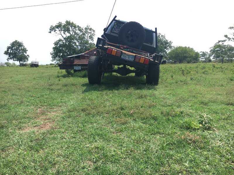

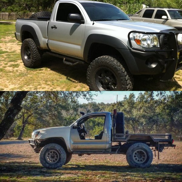

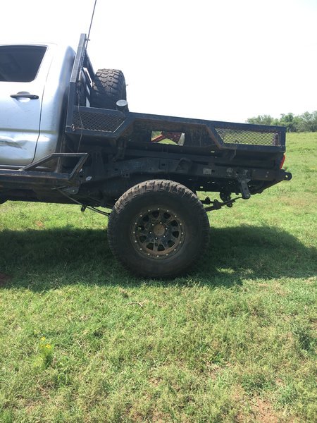

    Sup? The taco isn't my daily and is finally a trailer queen so I'll get to start taking my time and building her right.
    She's basic as fuck. All function and no form lol.
    2011 2.7l 4wd.
    Ome coilovers. Wheelers super bumps. Camburg uca's
    Add a leaf and bilsteins out back.
    4.88 gears. Open front. Welded rear.
    https://instagram.com/p/BT2c_xbFo1W/

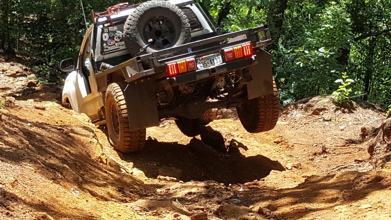

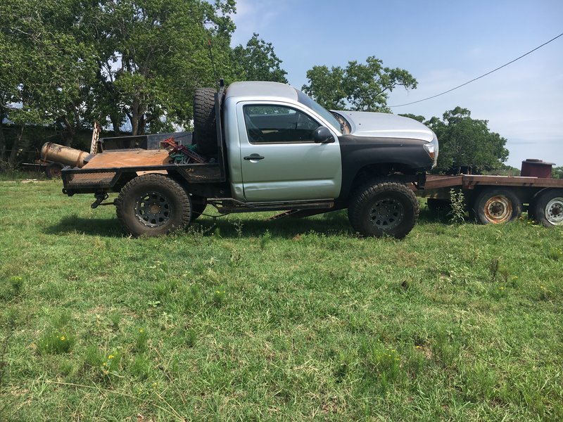

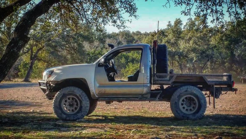

    What rockcrawling does to a rig. When I first got her to how she looks now lo

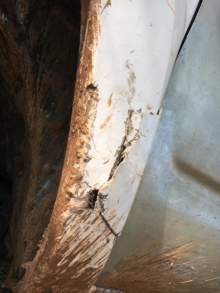

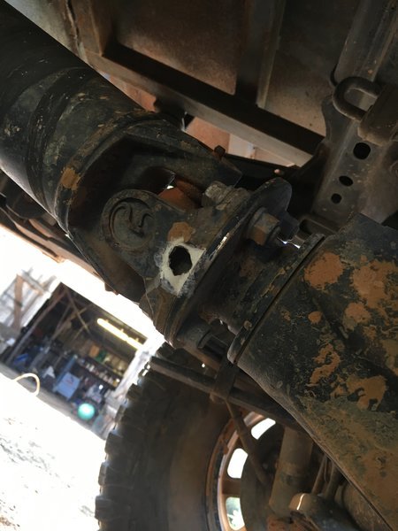

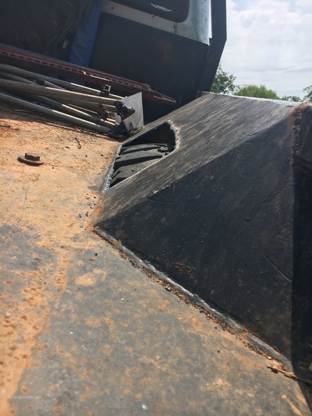

    Looking over the truck from Jambo weekend finally. Got a tie rod with slack for miles in it lol, a cracked up fender and somehow managed to put a hole in my ujoint.
    Time for a solid axle swap !

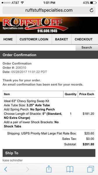

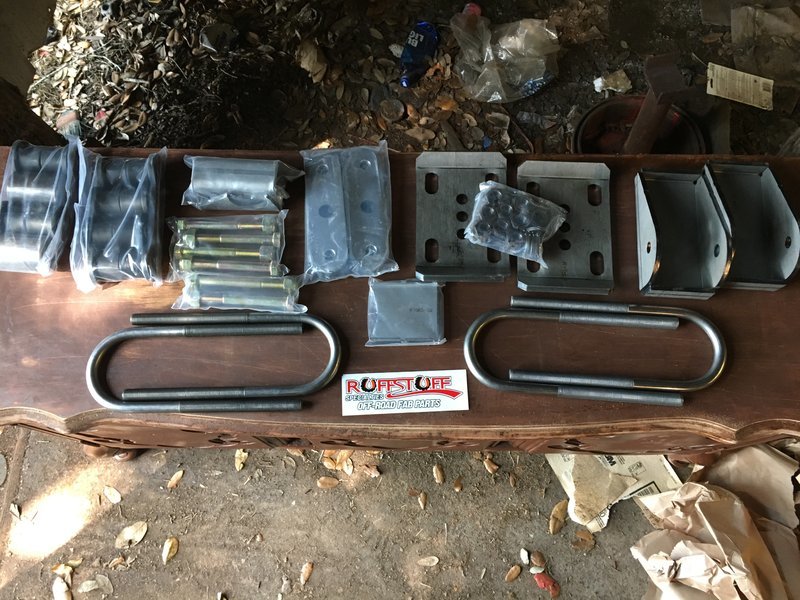

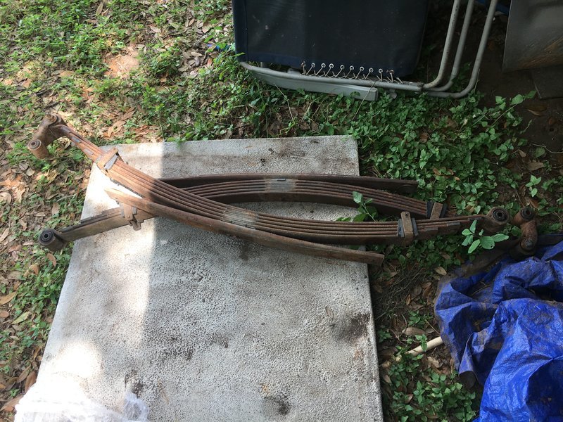

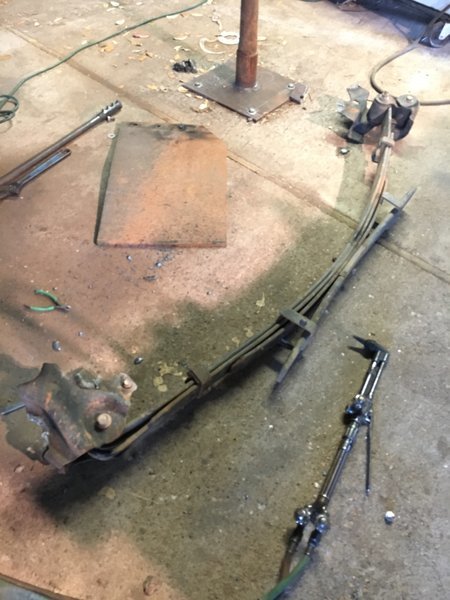

    Got some free 63s this weekend thanks to smkytxn(didn't tag him cause don't wanna bug him). They came off a 3/4 ton but I can just take apart the leaf pack anyway and use 2-3 leafs. Will figure how many I need once it's all together and I can flex test it. And ruff stuff is having a 20% off sale so I went ahead and ordered the kit. So far I'm $200 in this 63 swap. Cutting begins once the kit arrives :anonymous:

    Motivation to get started on this = staring at truck and swap kit for an hour.
    Blah lol

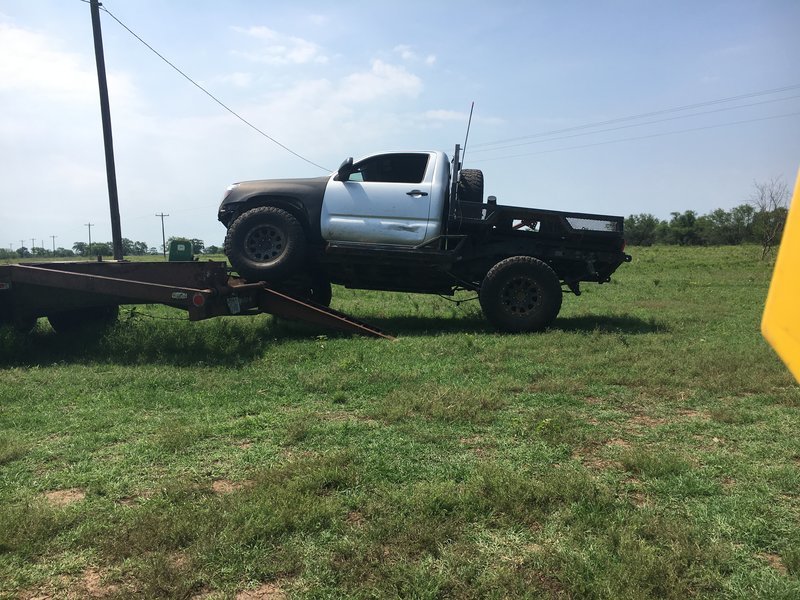

    Won't be needing this anymore

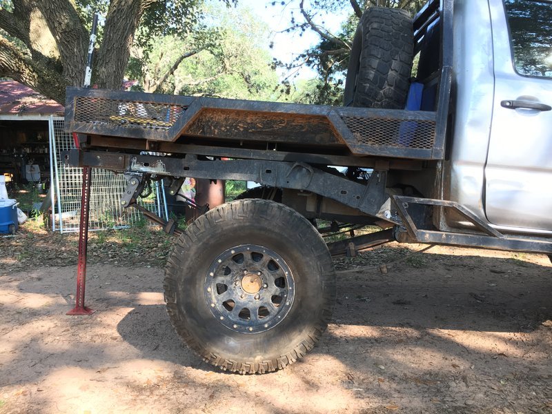

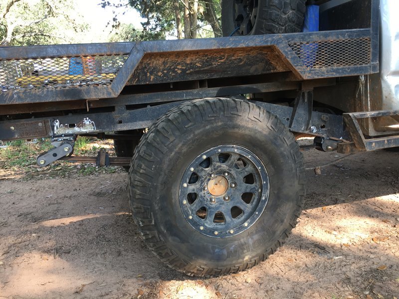

    Gotta move the front hanger forward tomorrow to center the wheels a little bit better but it's pretty much spot on. Moving them forward will help the rear angle.

    Doneee. I gotta cut the bed to fit 37s at full stuff so I just notched it now for the flex test. But it's gonna work. Angles and everything all work well.
