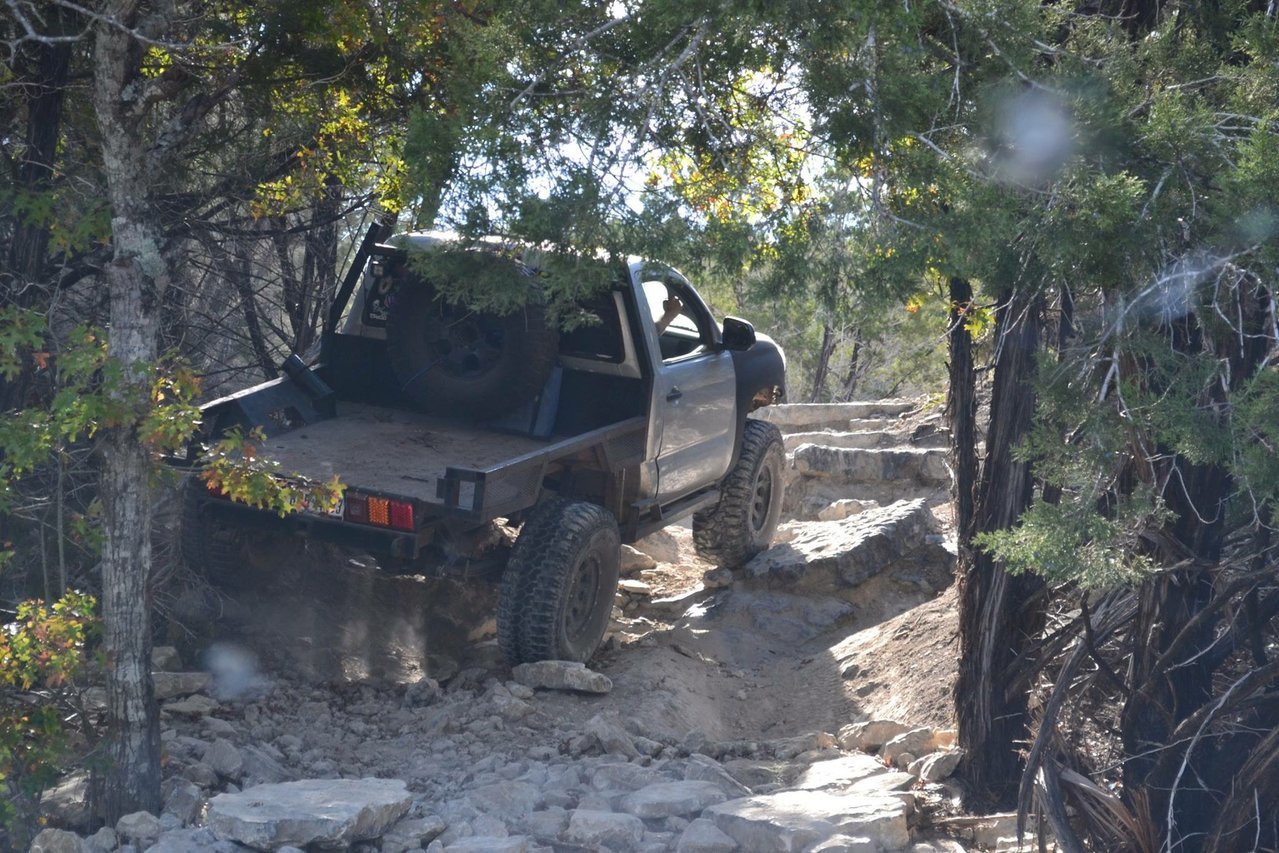

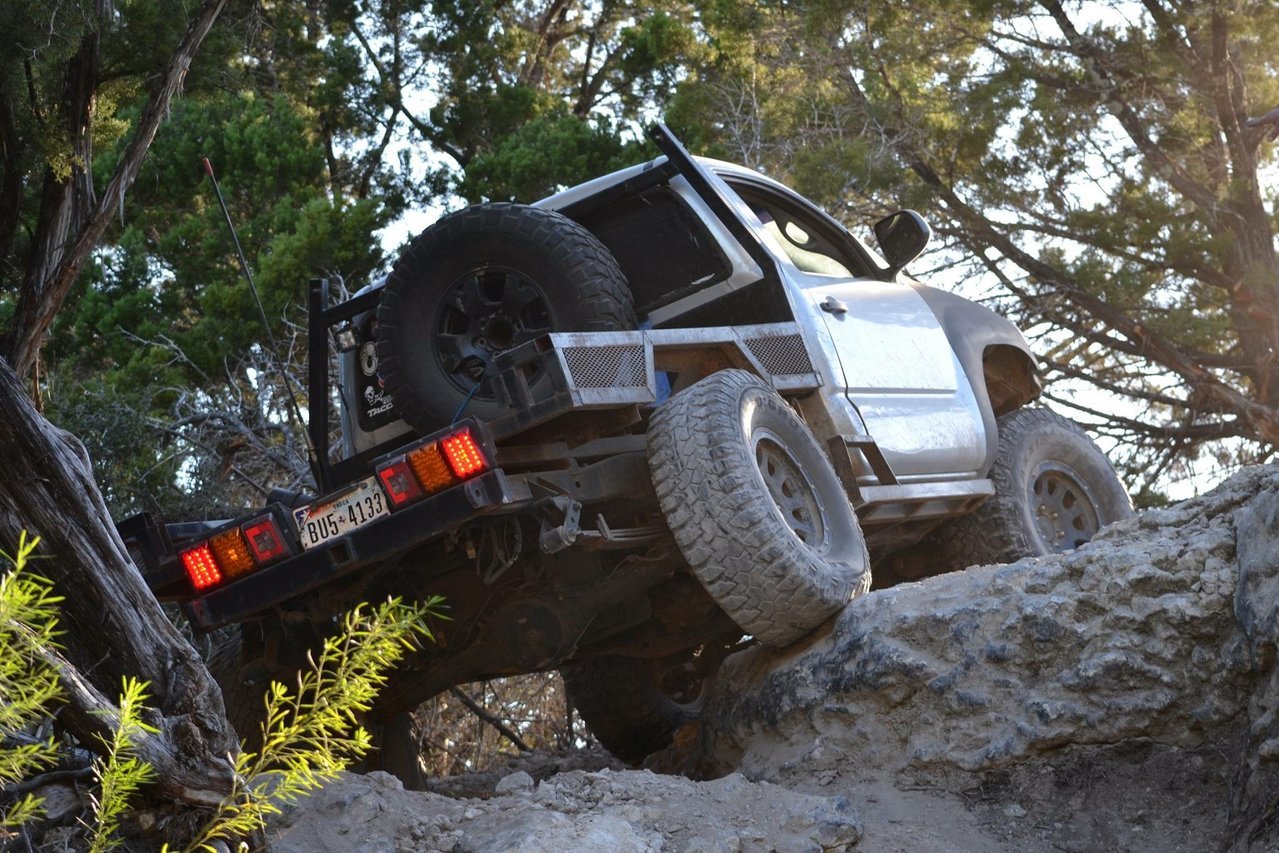

    Truck is back... wheeled it thanksgiving weekend lol

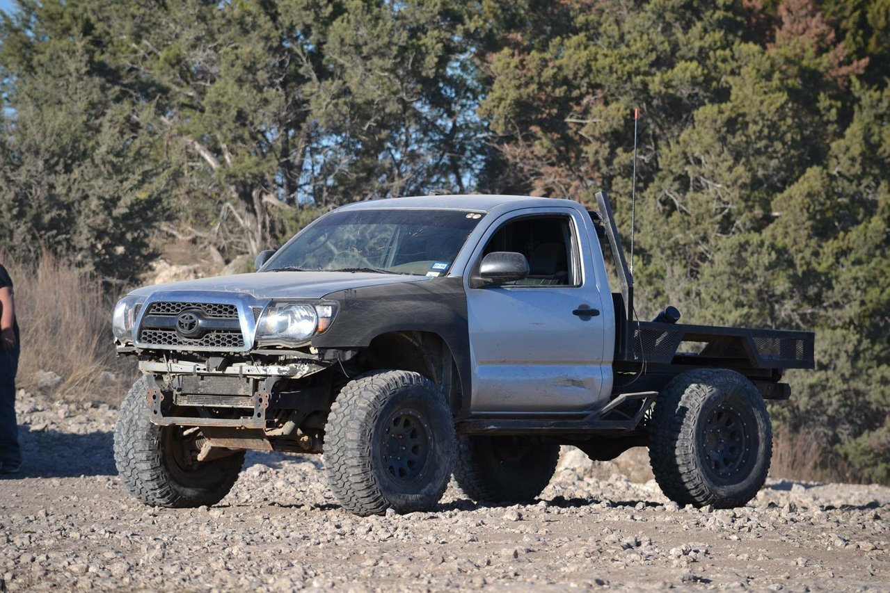

    Always a sucker for a single cab Tacoma, always. Dig em big time, dig this truck. Liking that flat bed.
    How ya like wheeling the single cab?
  11. Dec 2, 2017 at 3:34 AM
    #31
    weldertaco
    weldertaco [OP] Mr.13%bodyfat
    Dec 16, 2014
    #144371
    13,299
    texas
    TrailRunner
    4wd to 2wd conversion
    Oh man I love it. The wheelbase is amazing. It's only hurt me a few times. Being a standard kinda sucks sometimes as well but usually it's just a blast to wheel. Love every minute of it.

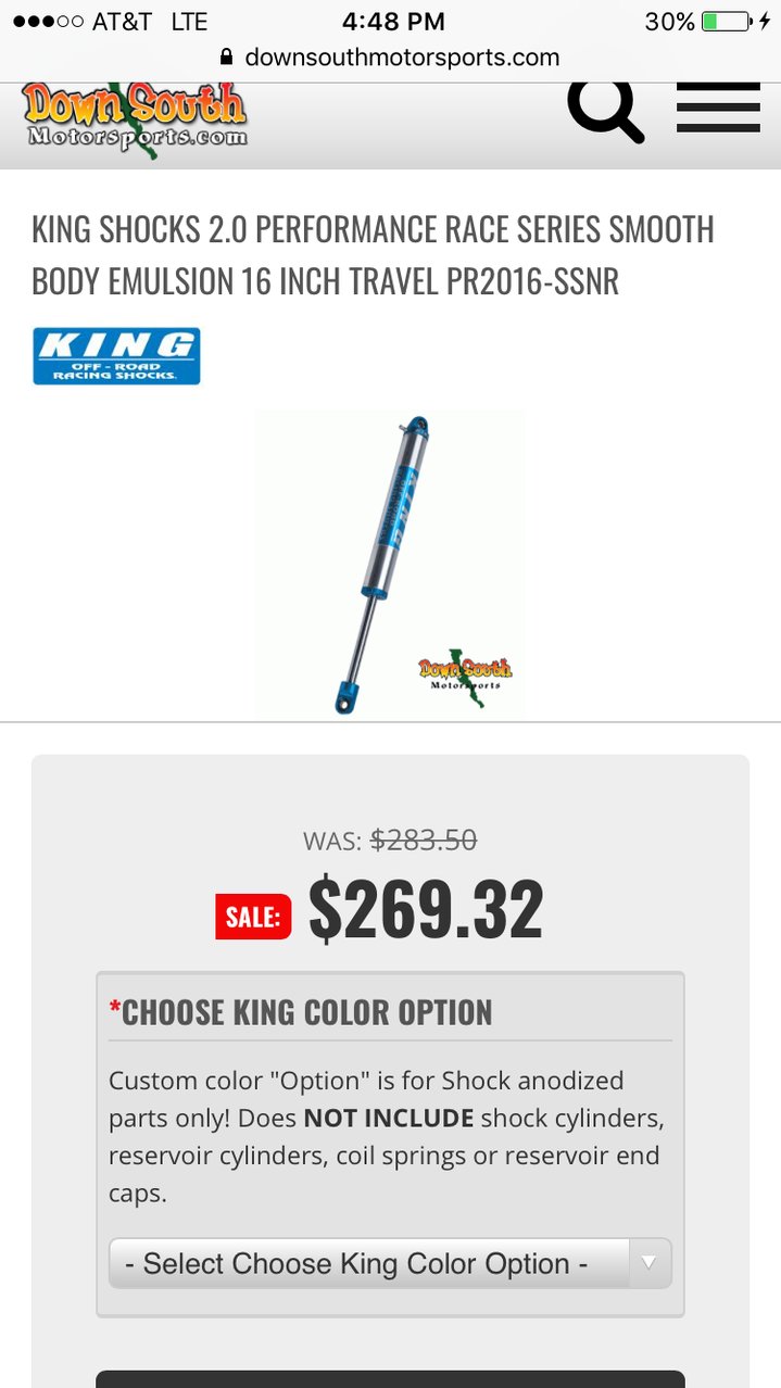

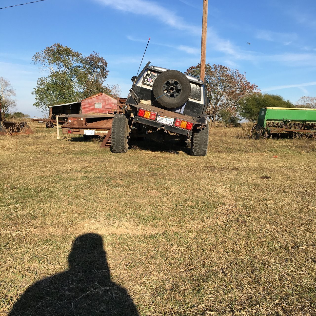

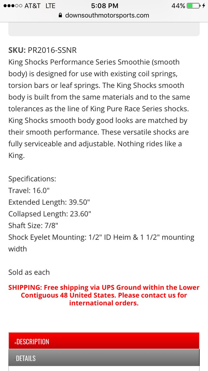

    Went out and flexed the taco after chopping the bed some(I'll finish it later and make it look decent again). While stuffing one tire on a ramp I got most of my numbers. I was measuring from the stock shock mounts to above the bed 4" cause it gave me the most even numbers. It's all relative but basically I came up with the fact that I need 4" bump stops and shocks 14"-16" shocks since I'm getting 12-13" of travel. I may get more droop in certain situations so I'm gonna allow some tolerances. Now to find some shocks that get close to what I need and start thinking of how to mount them
  15. Dec 2, 2017 at 2:59 PM
    #35
    weldertaco
    Dec 16, 2014
    #144371
    13,299
    texas
    TrailRunner
    Probably gonna order these 16" shocks. It'll give me a little bit of allowance for forced travel on the trails

    Putting this here so I don't lose it or forget it. The numbers are perfect for what I need

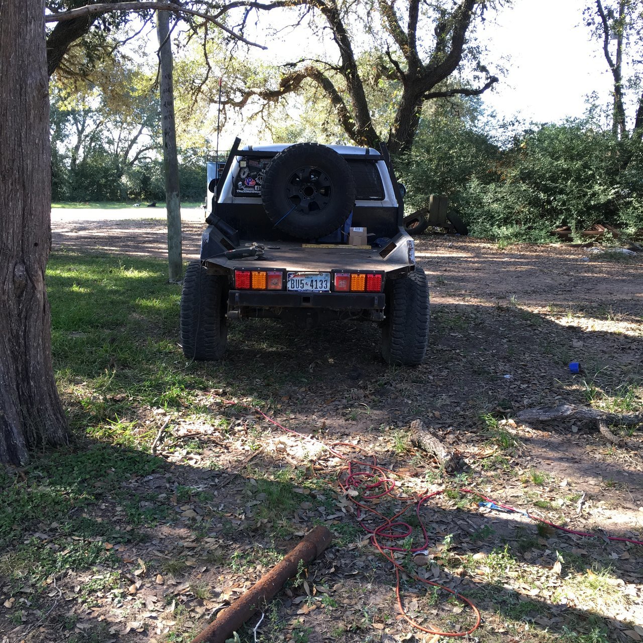

    I also dovetailed the bed. I need to fill in where I cut out but it's gonna look decent when done
