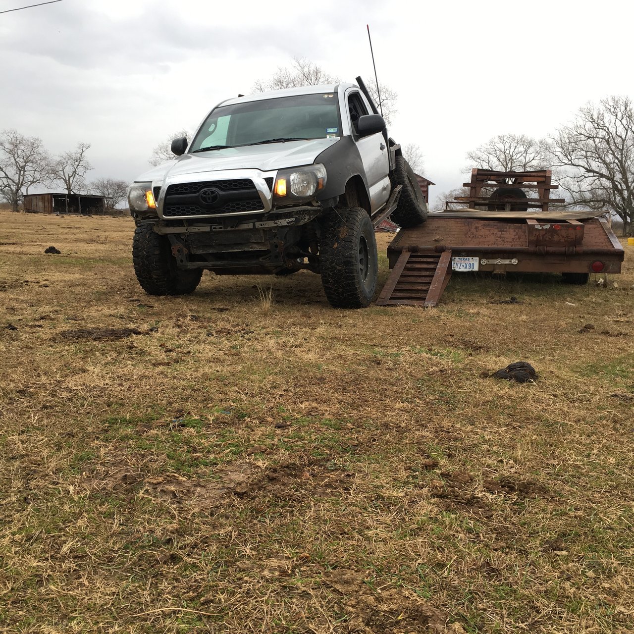

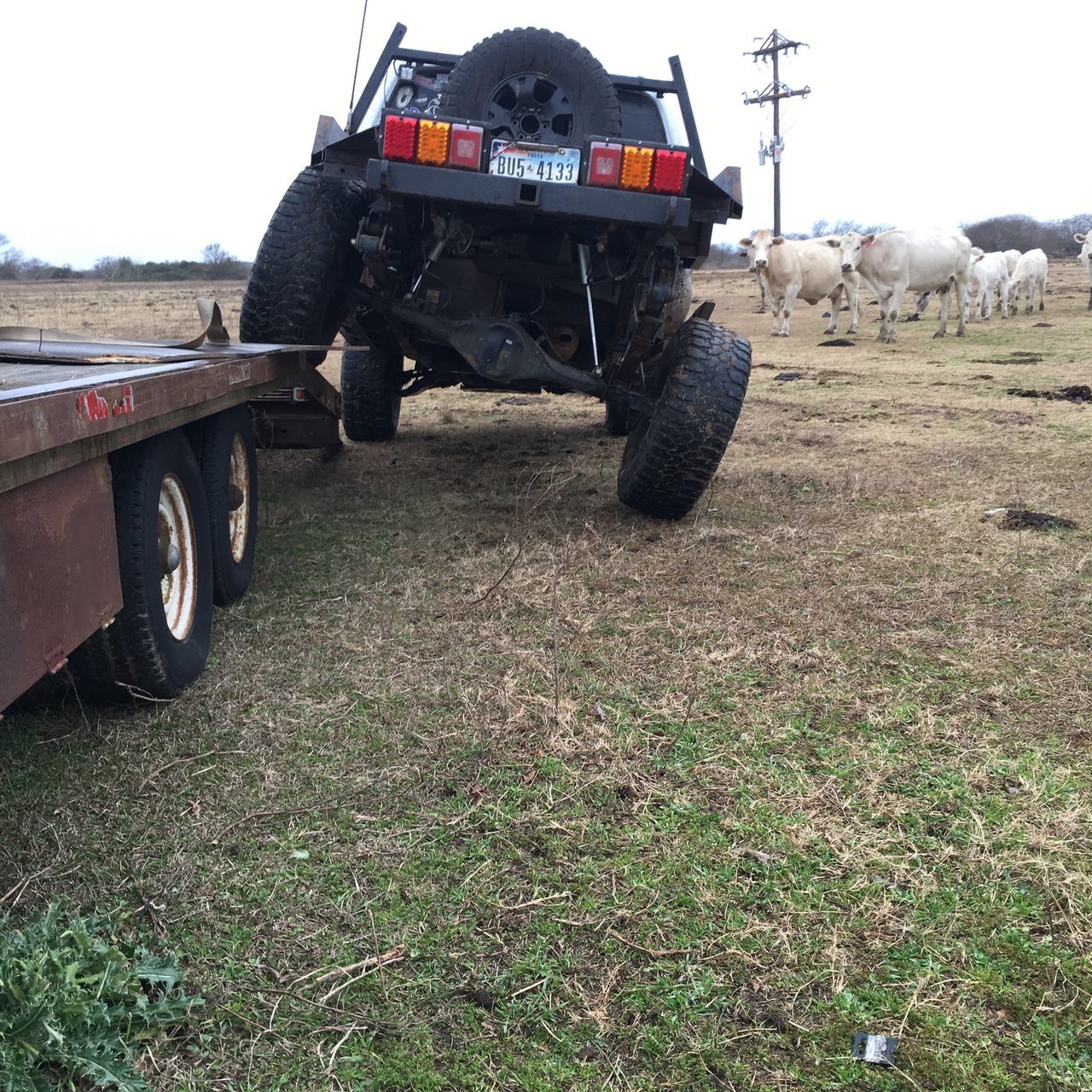

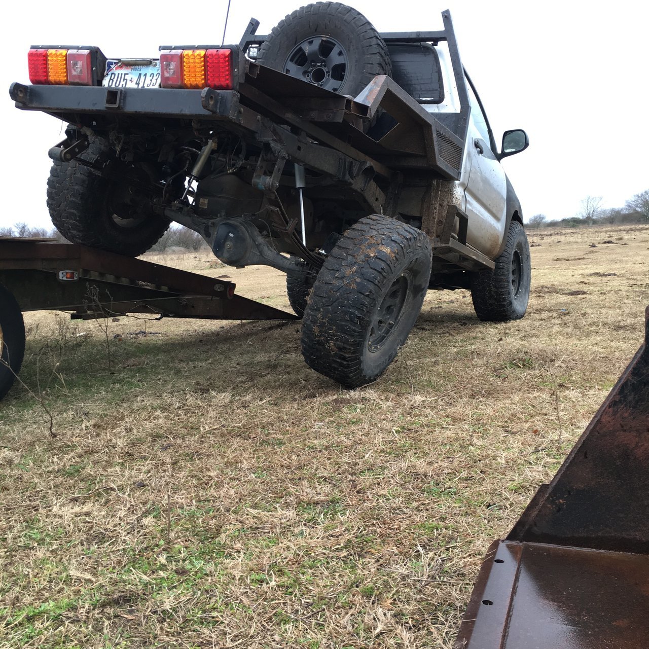

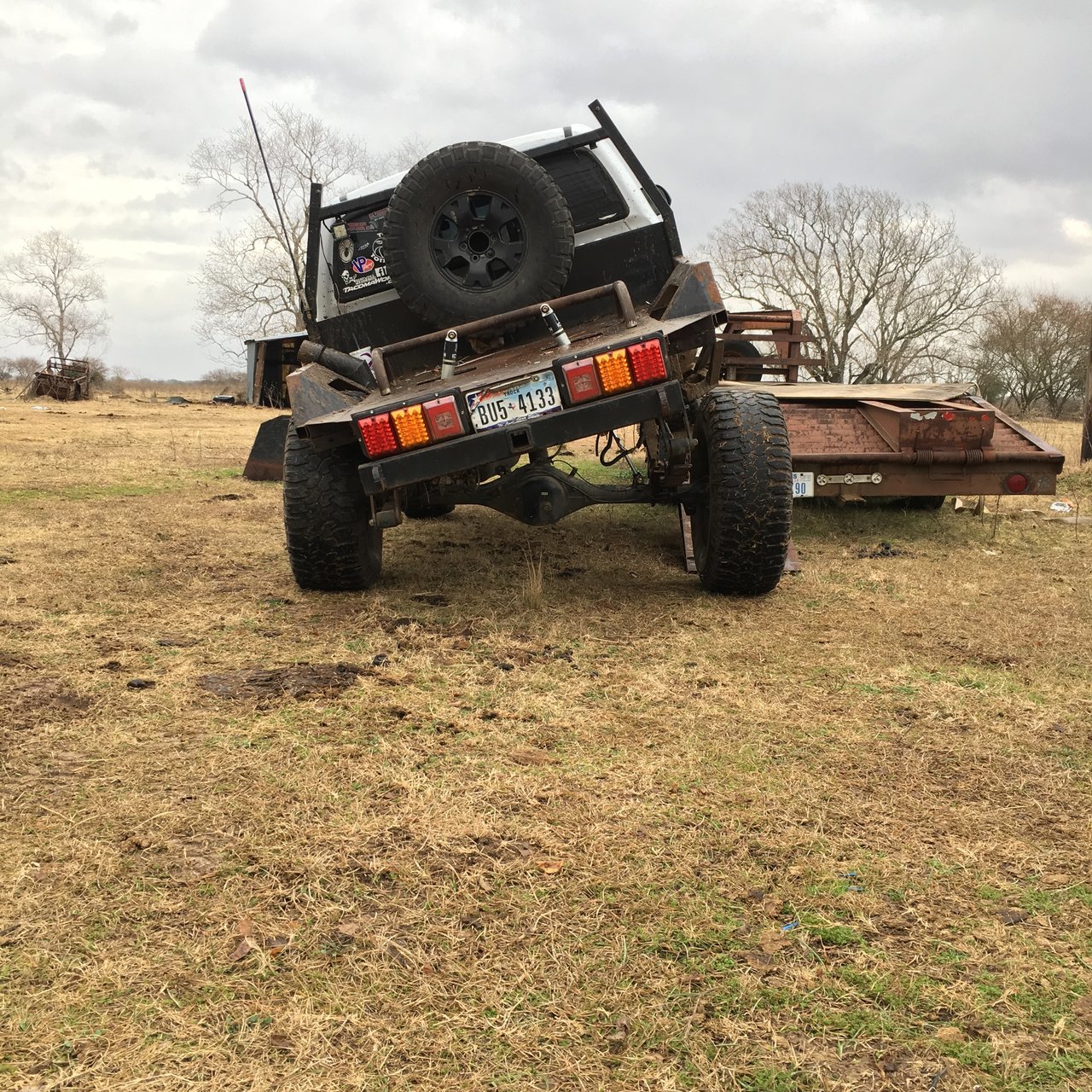

    With a 110 welding machine and tube bender with a hitch mount lmao.... I finally finished up the rear end on this truck. I got everything tacked up and flex tested. Just have to weld it out and paint it next.
    This was a pretty simple, fairly cheap and flexy setup.
    15" icons. Chevy 63s. 4.5" soft bumpstops.
    Camburg 1.25 UCAs. Shitty OME coilovers. Wheeers superbumps.
    Maxxis bighorns 315/75-16 on MB 352 Wheels.

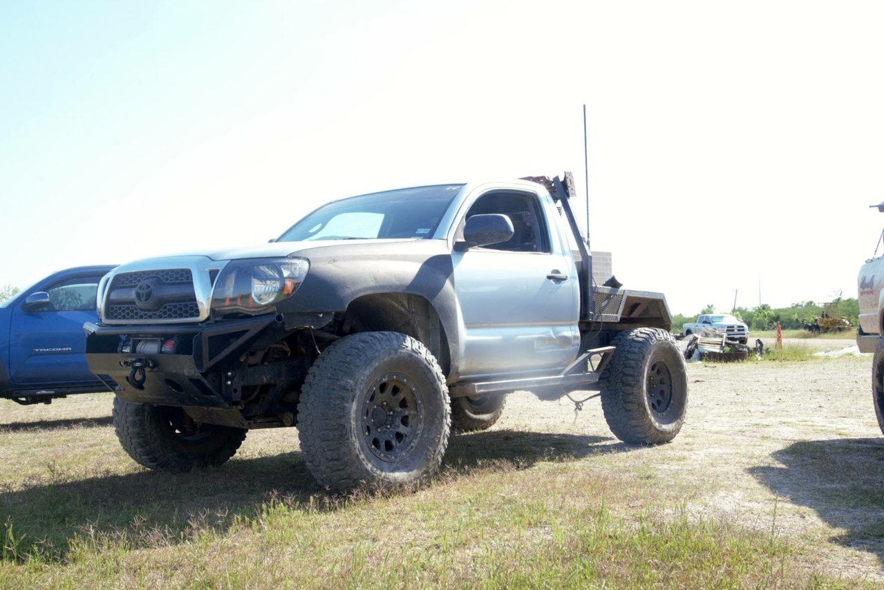

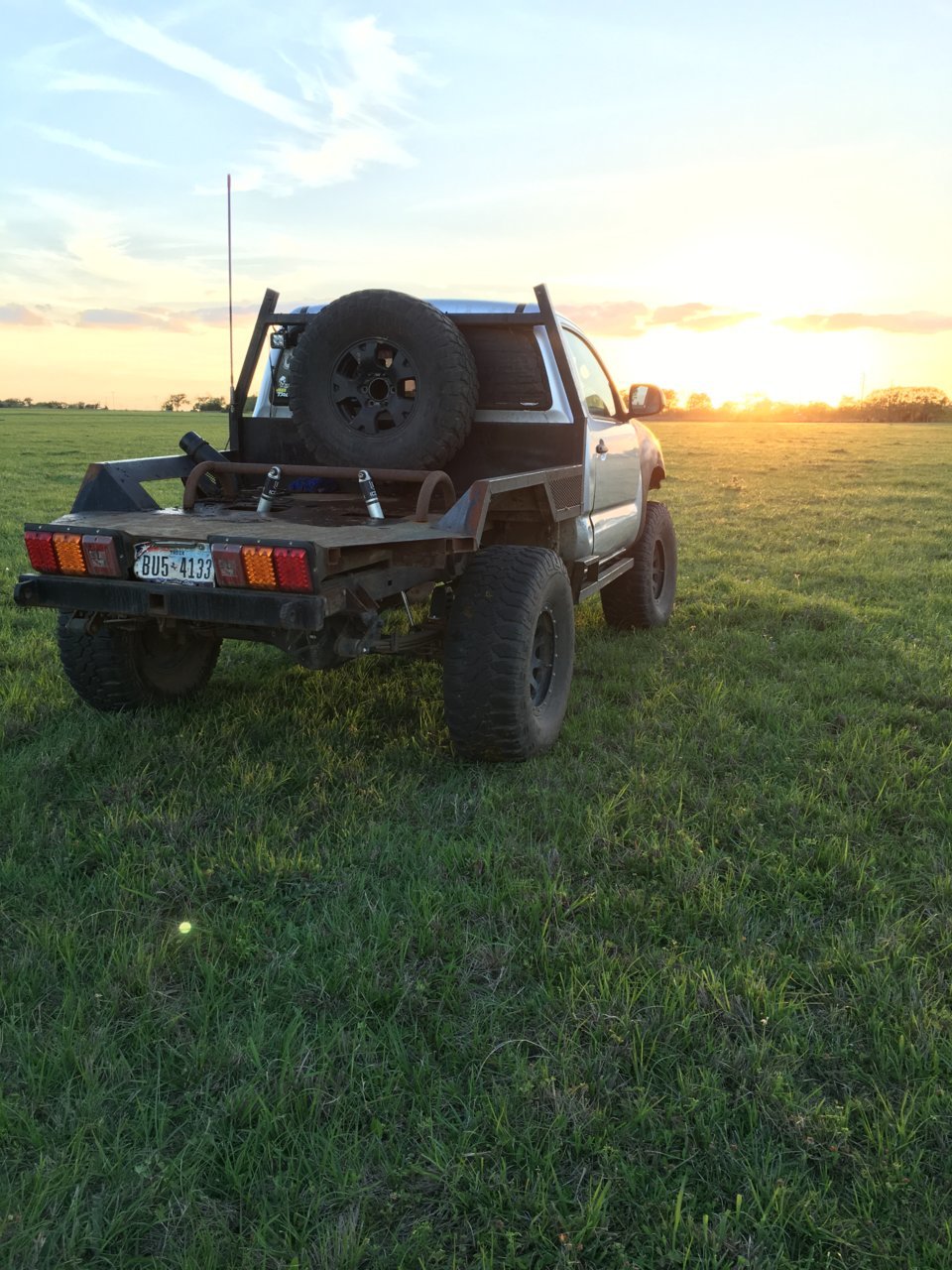

    Took her for a cruise the other day. Got another crawler project going on and working on the tow pig some too so she hasn't got much love.
