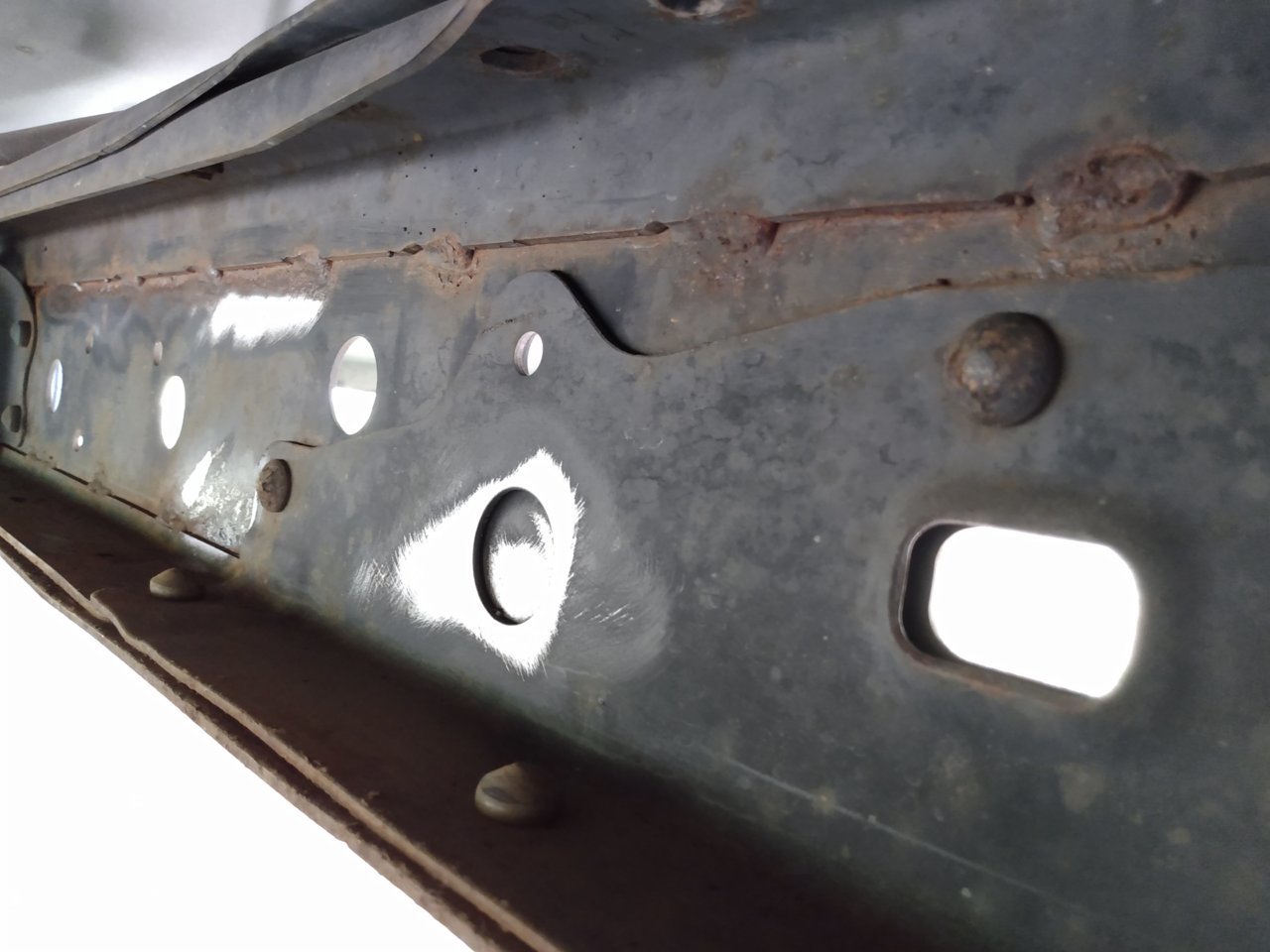

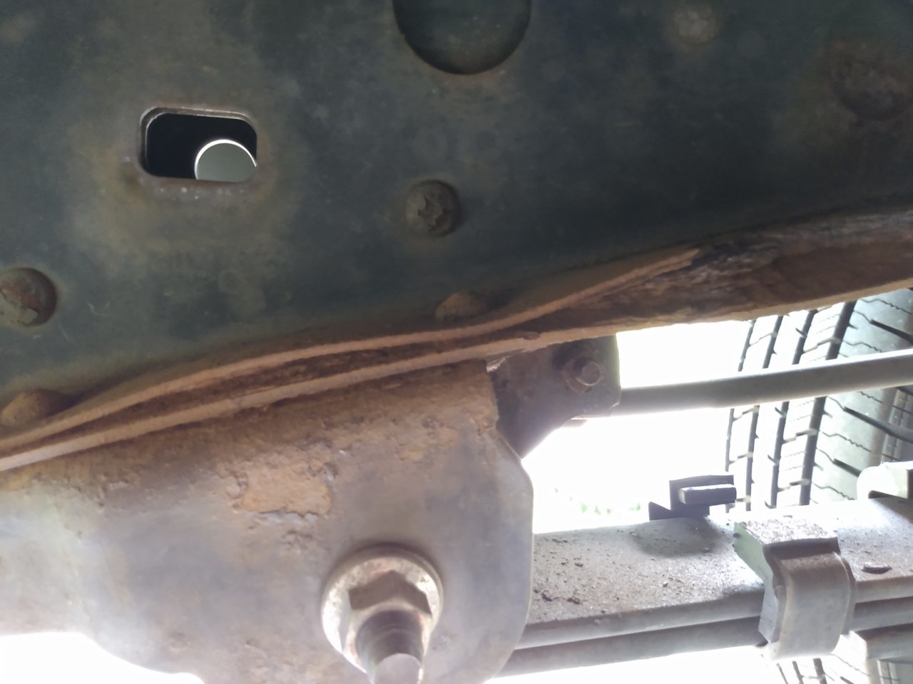

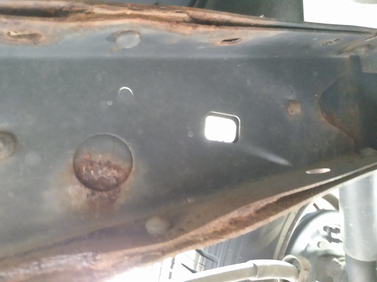

    Seems like this frame may not be salvageable not without major cutting welding which is difficult to do with the body still on.
    The spaces are so big on this multi pos i can stick a screw driver through in it. Anyone tried Eastwood internal frame coating?
    Trying to salvage this junk if possible.

    It's hilarious to me the OP calling the frame and its design junk when he doesn't have a clue why it's built the way it's built. His 1/2" thick metal was equally hilarious. I see a train coming off of its track.

    If the design is not junk then explain why Toyota had only the biggest frame recall due to premature rust ever.
    Theres no way in hell if this frame was all or mostly one piece it would have rusted this fast, are you a engineer do you work for Toyota?
    Also the two pieces of metal together are a half inch (measure calipers told me this) have you ever tried to weld two pieces riveted together or you just troll about things that are hilarious ?

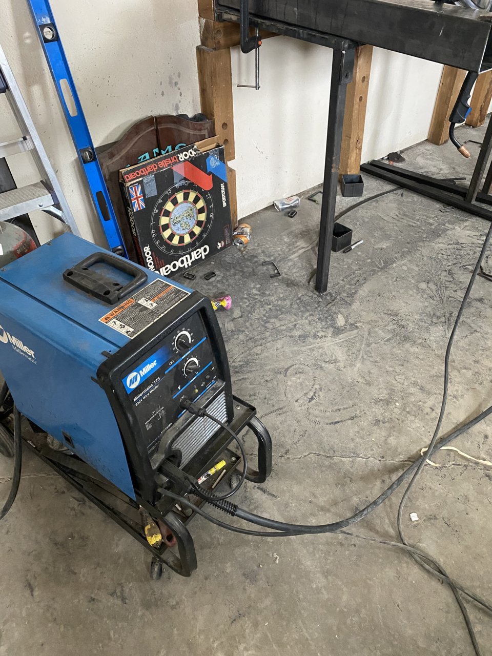

    I have this one in the photo. :thumbsup:
    So much nicer with the super flex hose and 200amp flex head torch from CK Worldwide.
    Came with a free helmet from www.cyberweld.com
