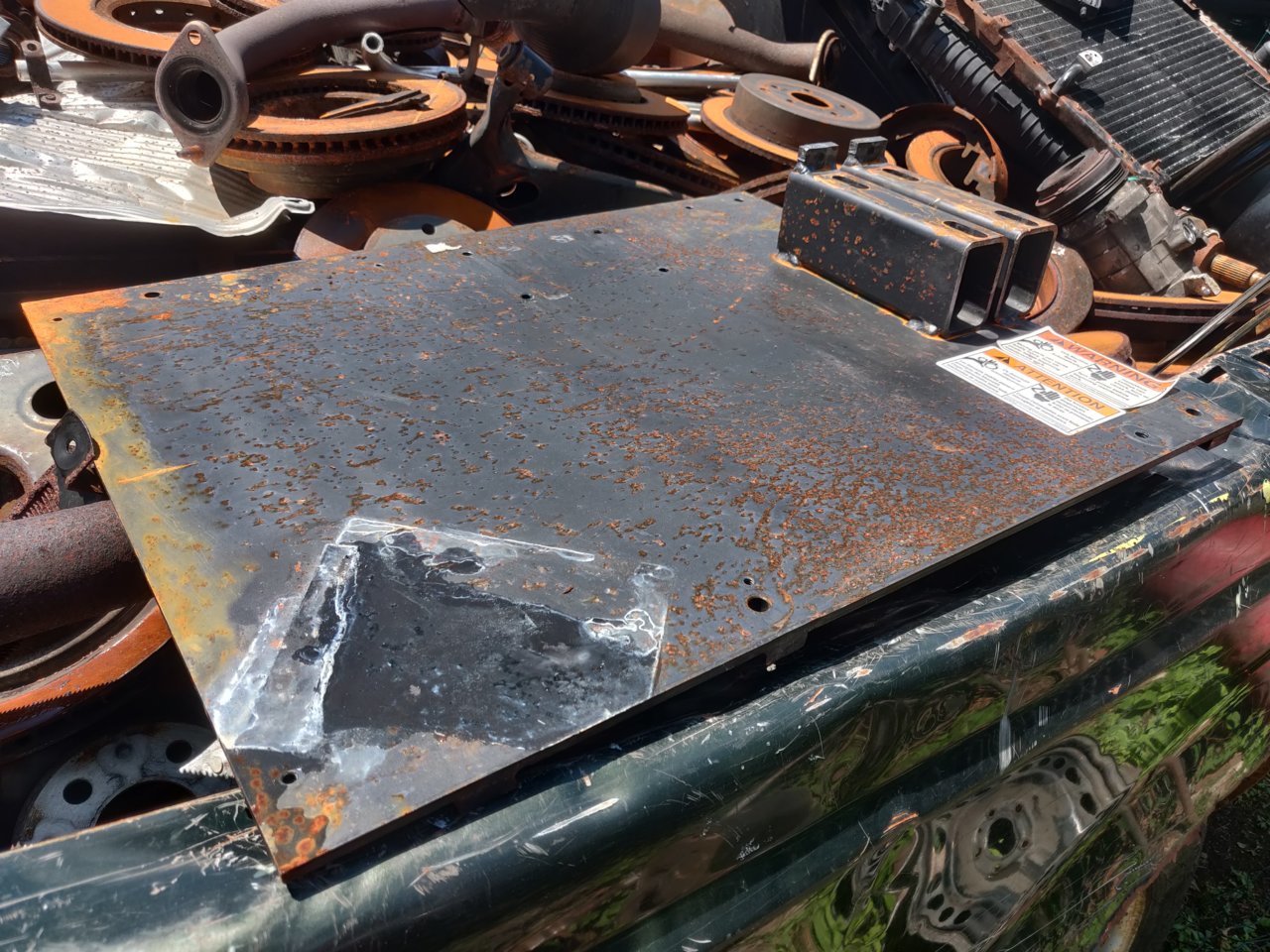

    I found this today at my local mechanic's scrap pile. It was sitting right on top of the full bed of a pickup....PERFECT practice piece.
    Needless to say I have practiced a little but not enough. I went to the local metal supply place and they wanted to charge me $45 for a flat bar stock that was about 1 x 3 and only 1/8" thick. I said thanks but no thanks.
    I can cut this up and practice making right angle welds and also just practice making straight beads. Woo hoo.
