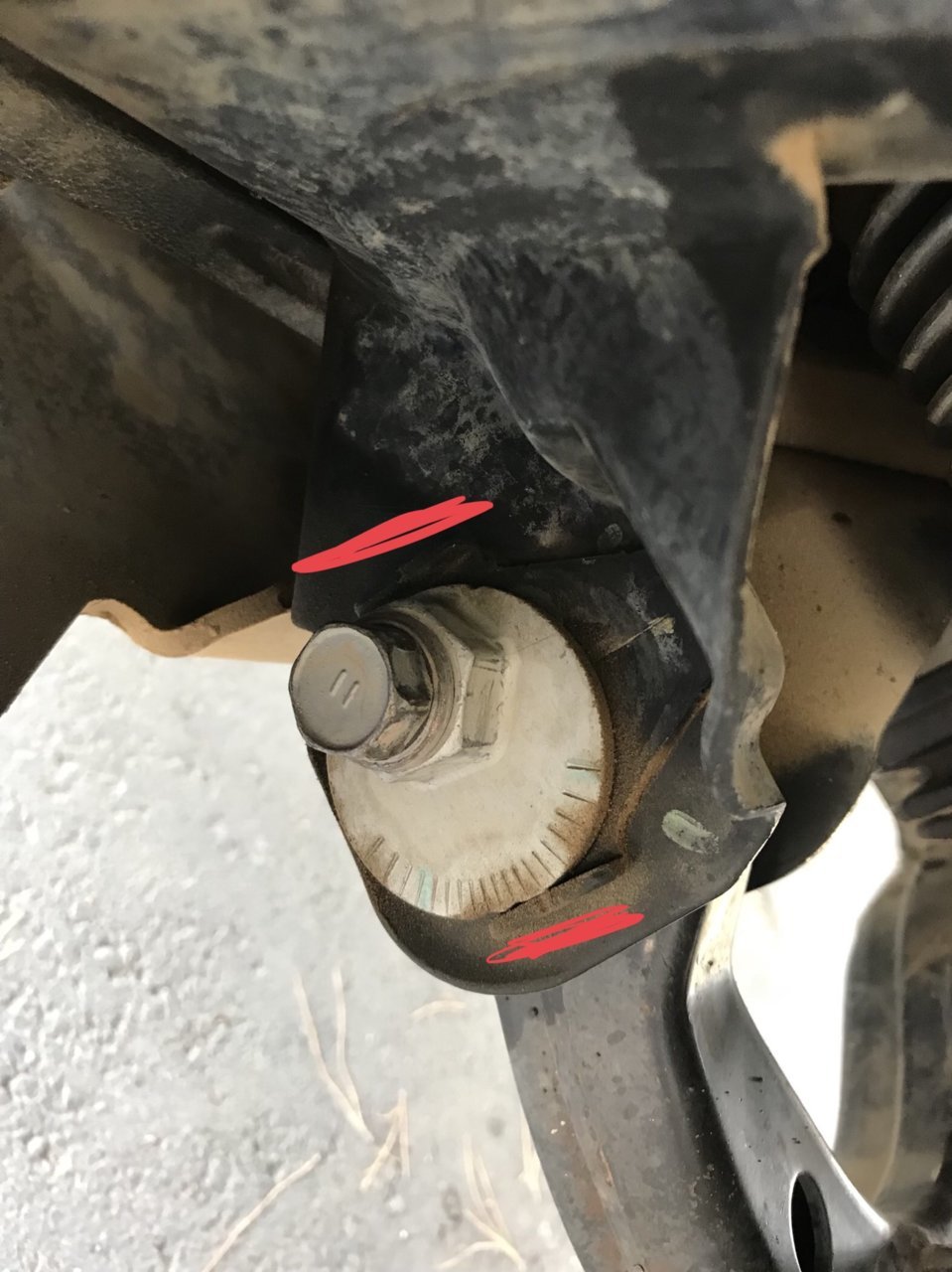

    I’ve read about people welding a support to these cam tabs instead of replacing them with TC ones.
    Has anyone done it? If so, how well does it hold up?
    Only 2 of my tabs are bent, but I’d like to reinforce the ones that are still good.

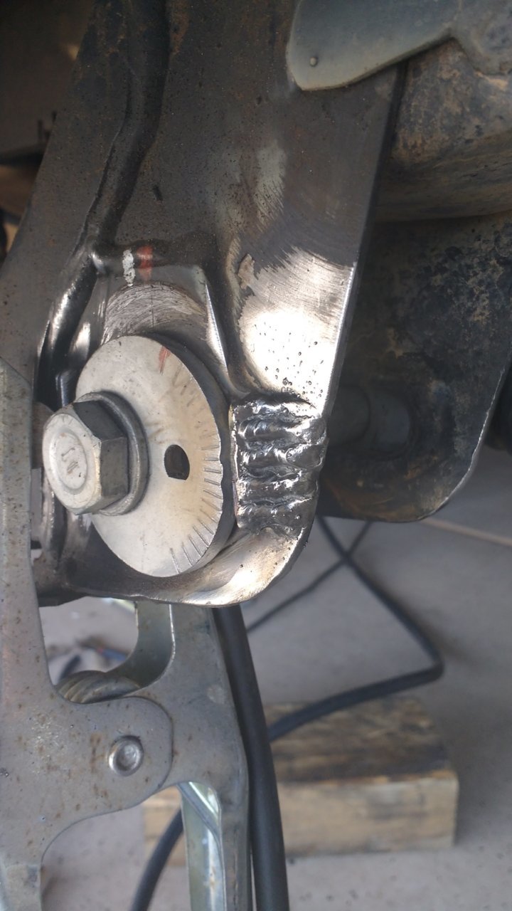

    I did them on my 2000 and on my 07 .No problems at allIMG_20170610_120727539.jpg

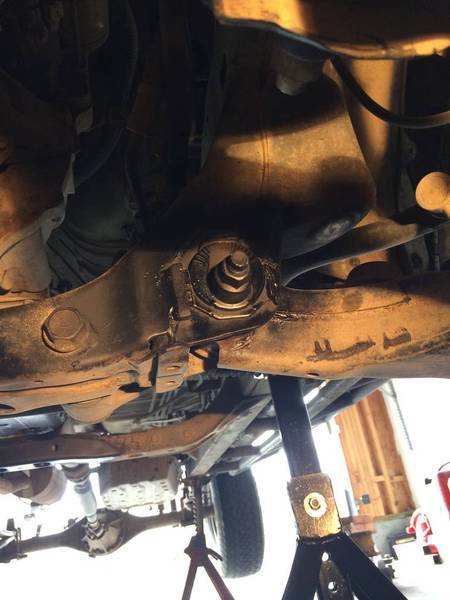

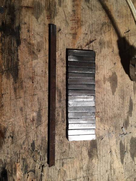

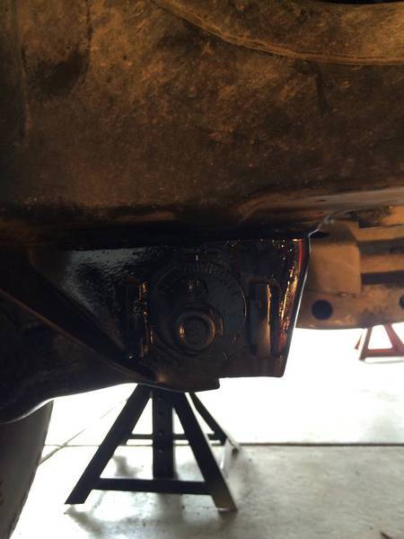

    Got my supports/gussets for the cam bolts tabs in. I pick up 3' of 5/16" for .50 cents to make these. I cut them all about 1 1/2" long. I welded them to the original tabs and to the frame. Cleaned them up and painted them. I did 12 out of 16 because of the steering rack. I do those when i put the suspension in. Hopefully these hold well. If not then i'll remove them and fab up full gussets for those sections.
    On this one I just ran a few beads along side of it. I'll see how it does. If it doesn't work then i'll just make something else to go there.

    I welded mine without removing anything. It didn’t hurt anything. I just laid 1 or two downhill beads

    I completely removed mine because I didn’t want to risk burning the bushings.

    I'm looking at doing this on my 3rd gen. I need to get under the truck again but it looked like a couple of the tabs were at the end of the material so there wouldn't be a place to put a reinforcement weld on the outside of the tab. Did I see it wrong?
    I was planning on dropping the LCA and then greasing the cam bolts but I'm running out of time and my new tires and alignment are scheduled before I will have an entire day to do that. I'm tempted to act like it's body work and go slow and cool it with air to save the bushing. Anyway, I just found this thread so I figured I would comment so I wouldn't lose it
    Carl_z33[OP] likes this.

    You’ll burn the bushings. If you wanna weld a bead, take off the LCA
