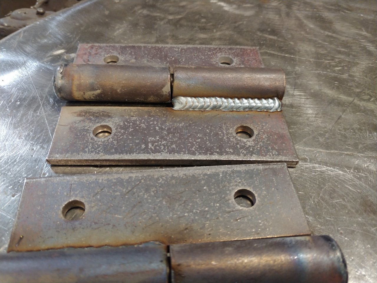

    If he can’t walk the cup then walk away

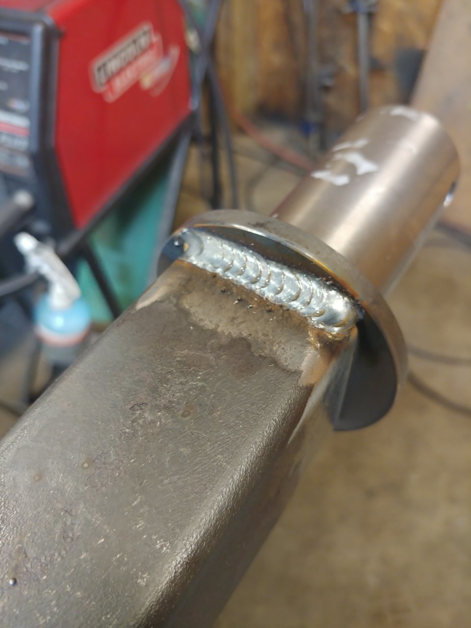

    Who says you can’t walk the cup with MIG the guys trapping glass. It just won’t have that cool cat paw look like you get with TIG but your right it’s just sliders burn them on.

    I do it at work when I get bored. Not great for production jobs, but a fun way to get out of the mindset of bead after bead as fast as possible...
