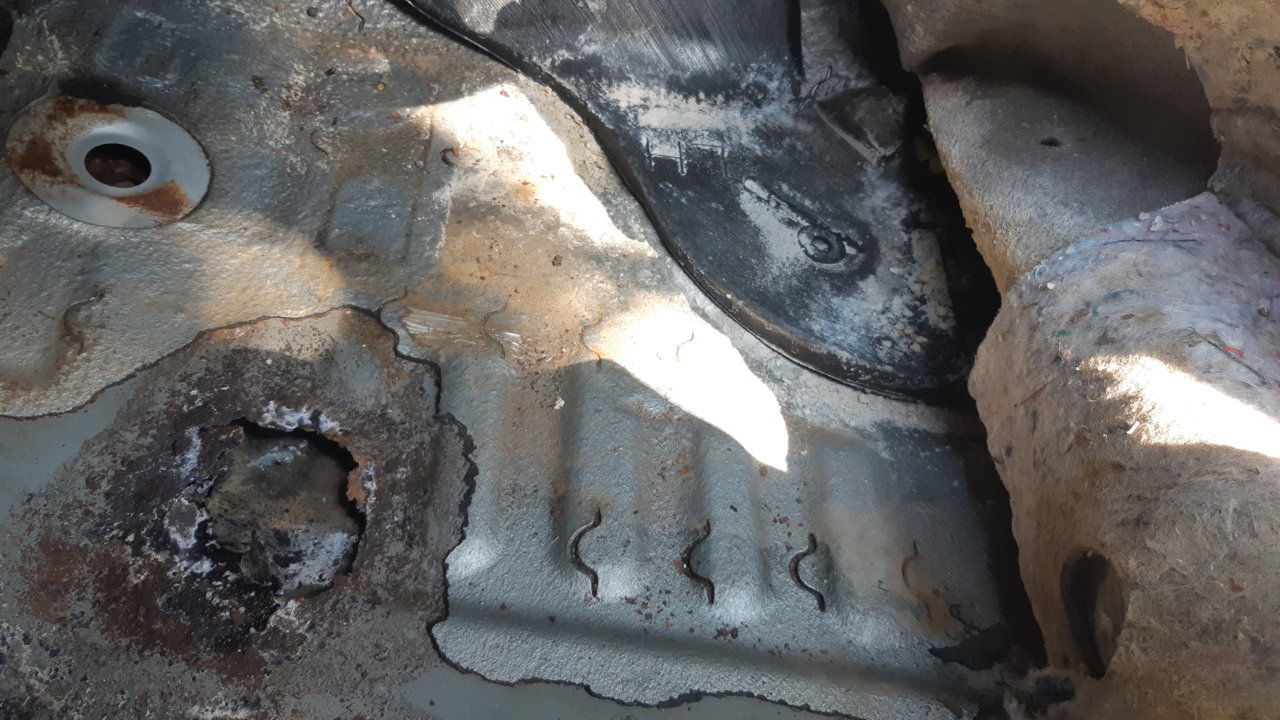

    Mig welding a patch into my drivers side floor - where's the best place to ground the welder?
    Battery is off, red rag underneath will be soaked with water and I have a fire extinguisher at the ready. Anything else I should do?

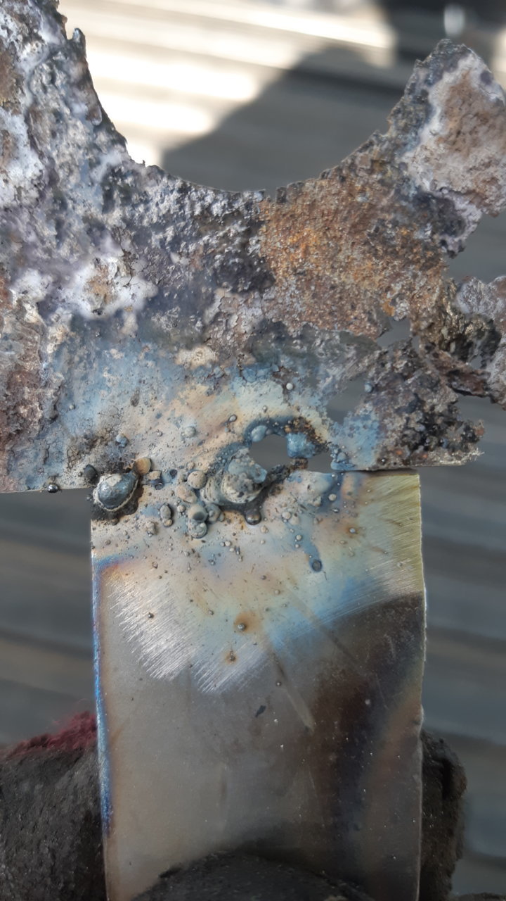

    I plan to get a C75 bottle at some point but yeah, time and money. Good point about the idiot chart - just checked and it gave me the same settings as practice resulted in. Speaking of which..
    Not super confident here lol.

    The tack on the left looks okay..what’s the underside look like? Did you get good penetration?

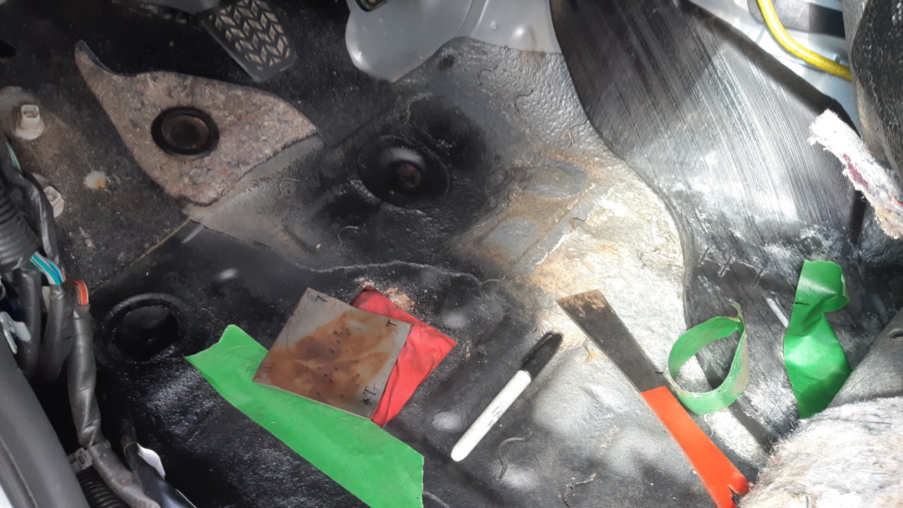

    I just decided this is my practice piece since it will be hidden under the carpet :D

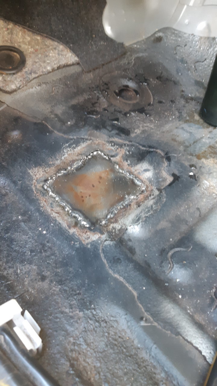

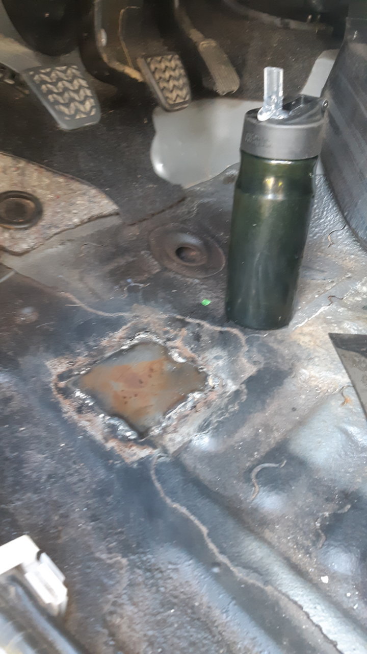

    So my welder has 4 settings - min/max and 1/2, then wire speed 1-10. Tack on the left was min-1, speed 3. Cheat sheet says for 16ga use min-2 and that is the middle tack. Min-1 did not get good penetration but min-2 was blowing holes. I decided to use min-2 and pull back a little but it was still blowing holes so I dropped back to min-1 and turned the speed up a little. Still blew some holes, I maybe should have made the patch bigger to find better steel but all in all not bad for a first try. I'm going to go drink a beer and decide whether to take it to my buddy to finish or just epoxy over it. Leaning towards the epoxy.

    Looks pretty dang good for flux core...make sure to put undercoat or some sort of good paint over it and check for any holes with a flashlight.
