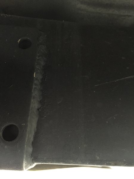

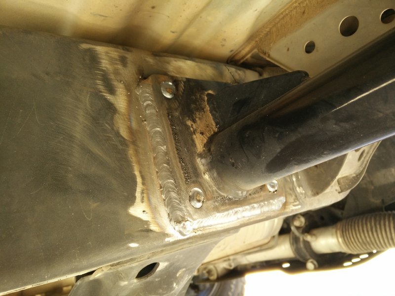

    Found a couple pics of the welds too, before I painted them...
    Seems a whole lot simpler if you're not worried about being able to easily pull them off. Still could always cut them off if needed for some reason.

    Super clean :drool:
    What brand of sliders did you go with? Did you weld them yourself?

    Thanks :)

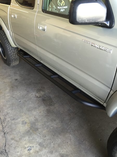

    They are 4xInnovations sliders. I was impatient and rather than wait to weld them myself when I could use the welder at school, (my personal welder is too weak) Badland Bumpers in Ravensdale welded them on for me so I could use have them on before I wheeled the Naches trail.

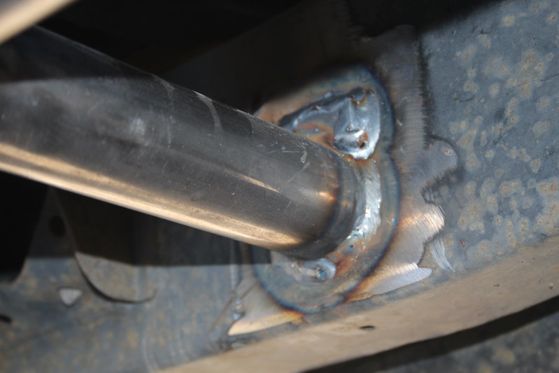

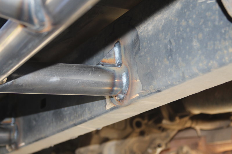

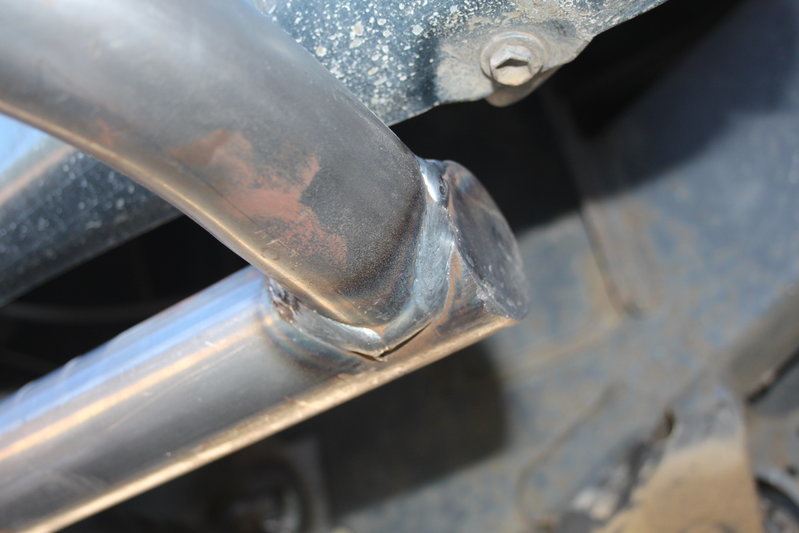

    I welded my all pro sliders on. Just make sure you disconnect the neg from your battery.

    Beautimus! I like the extra effort to rosette weld the bolt holes in the scab plates too

    The All Pro ones look like great stuff too, I didn't know they used scab plates. My 4xInnovations ones came with scab plates but I chose not to install them. Funny how many ways we can make .120 wall 1.75in round tube into the same thing.

    Why wouldn't you use the scab plate? I've seen shock hoops rip off sections of chassis. It'd suck to have the sliders do the same thing. The damage would be worse wouldn't it

    Have a couple friends that don't use them either, and Badland Bumpers doesn't use them on any of theirs. They're overkill for a light truck, I'm not worried about them in the slightest, they're all gusseted too. It's not an uncommon practice to weld the legs right to the frame

    That certainly seems to be the popular thought haha. Mine are welded on the same as @Digiratus and a couple other members.
    We took heat into account @TacoDell and mine were stitched in alternating order to avoid heat buildup. I'm not recommending one way or the other, truthfully I don't care how anyone else welds them to the frame, this was good enough for other folks who wheel their junk so it was good enough for me. I suppose I could always go back and reweld them, but they've held the truck great so far so I'm not tempted to bother.

    I didn't fill in those plate holes with rosette welds...
    primarily because it doesn't need those...
    and will make it more difficult to remove those plates
    if one ever wanted to.
    Instead... after ensuring the plate's hole openings were cleaned well...
    I filled those holes in using a seam sealer.
    I don't plan on ever removing my scab plates...
    But if I needed to... adding rosettes would make it more difficult IMO
