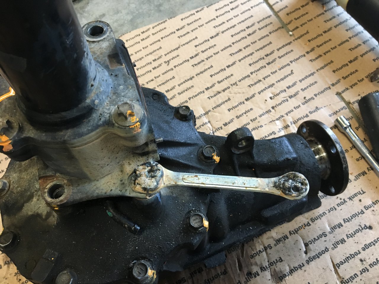

    This is how I got this stripped stupid E-Torx bolt off of my front differential when I was swapped the ADD axle tube and jack shaft for a Manual Hun axle tube without the ADD actuator. I tried welding nuts to it to no avail, presumably because the steel was Zinc plated or something.
    I ended up welding a Chinesuium 1/2 inch Harbor Freight “dropped forged” wrench to it and it worked perfectly.

    2003 Tacoma 4x4 5-speed 3.4 TRD SR5
    How? You could only get a 1/4 of a turn before you hit diff with the wrench. I don't doubt you, but I'm failing to comprehend some aspect of this.

    01 Tacoma TRD
    But once you turn it ccw any at all you can cut the wrench of & turn it on out.

    Flux Capacitor
    Once I got it loose, I cut the wrench off and turned the remenants of the bolt off with my fingers. The wrench was just to have enough leverage to break it loose.
