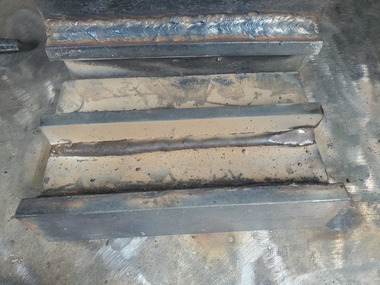

    We had class today to make up for last Thursday being Thanksgiving.
    The guys in class were excited about the news and one of them even suggested I do a technical test-so-to-speak.

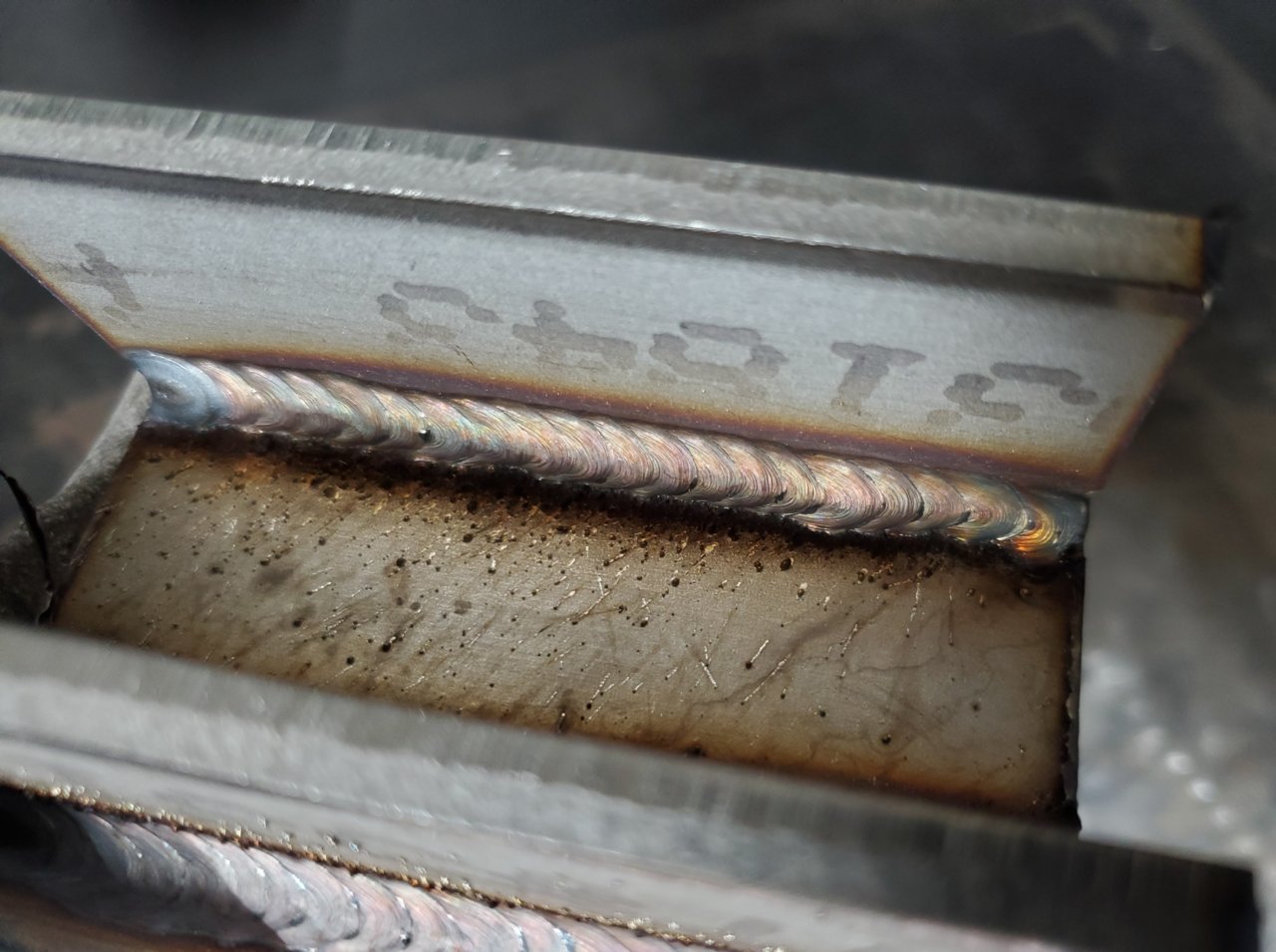

    Open root weld, 60 degree, 1/8" landing with an 1/8" gap. Weld must penetrate the backside but not exceed 1/8" and after the hot passes, must not exceed 1/8" from the top.
    Those pics were of my first attempt.
    I cut out 3" wide pieces as well so we can run on the bend test but didn't have time to do so.
    The guys wanted me to keep my MIG welding up so that was really cool.
    The main instructor was impressed and will be leaving the official WPS for me Monday so I can test if I want to.

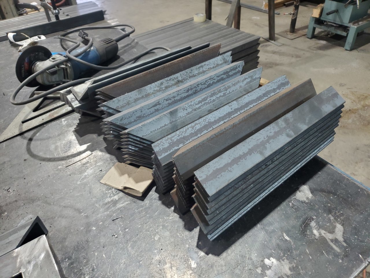

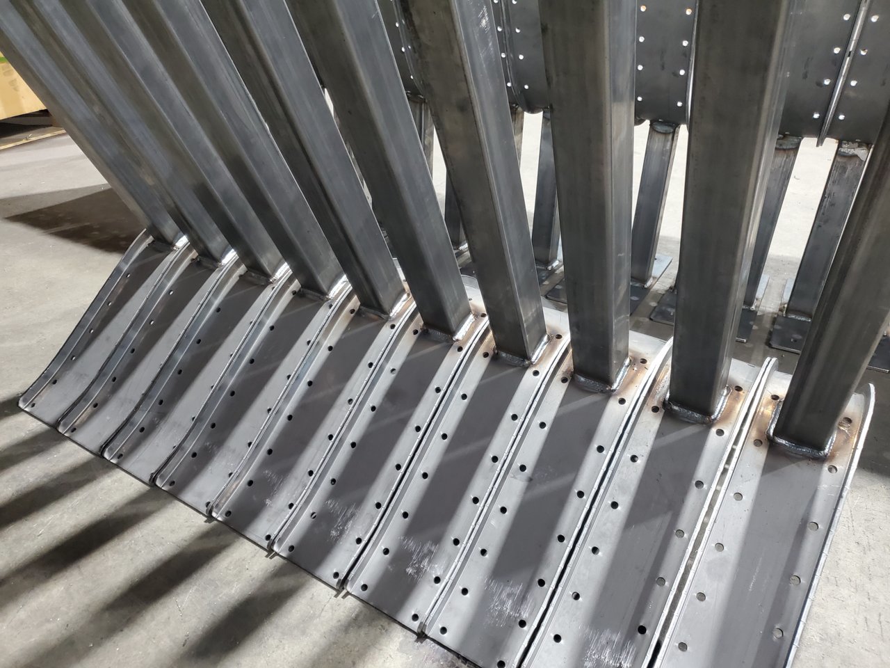

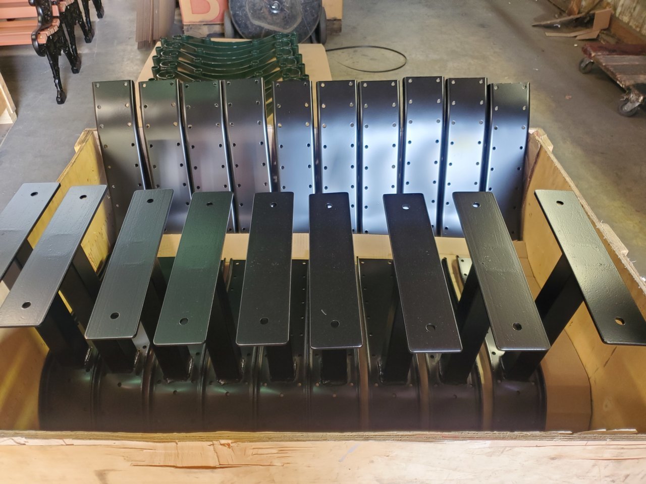

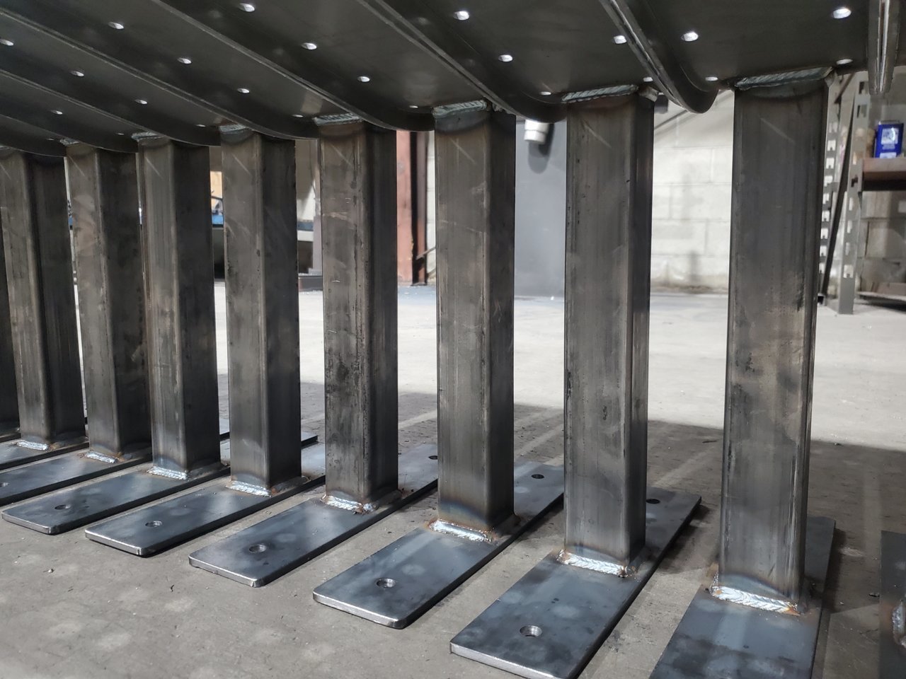

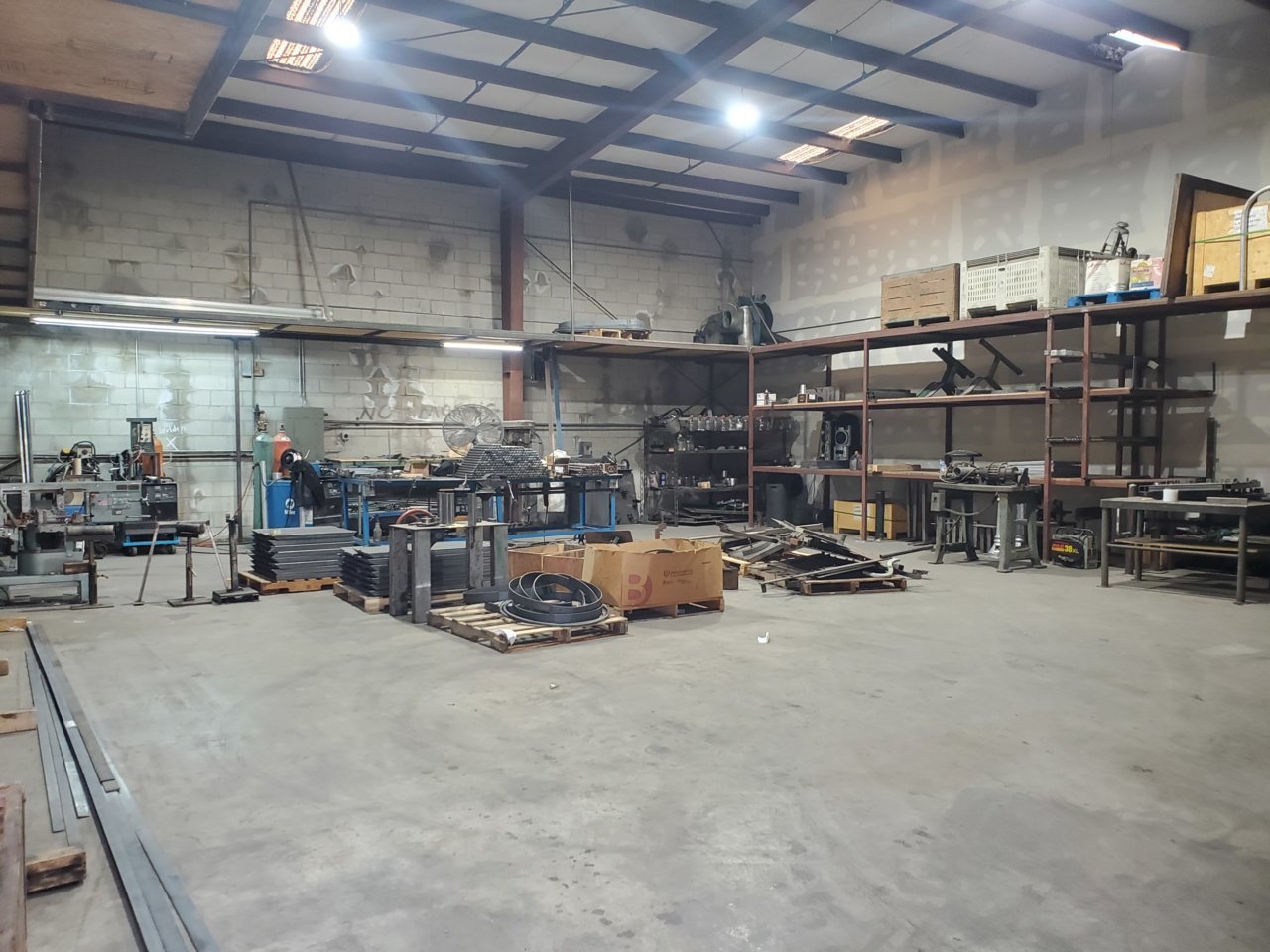

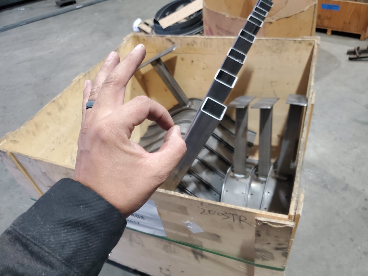

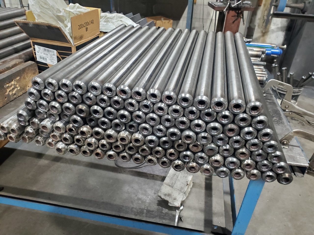

    And to whoever has been keeping up with the thread and my progress; I WORK AT A FABRICATION SHOP AS OF YESTERDAY :laughing:
    Pretty awesome to have been picked up right on the spot after a short interview. I won't get into all the specifics but here are some cool pics of the shop -
    and the big Miller I expect to be using -
    the brackets I worked on yesterday running holes in each one (there's another larger stack I didn't snap a picture of) -
    and the legs I drilled holes in and grinded down -
    and the many legs I have left to do -
    Come Monday or Tuesday, once I'm done with all the legs, we'll be making a jig to weld all those brackets I drilled up.

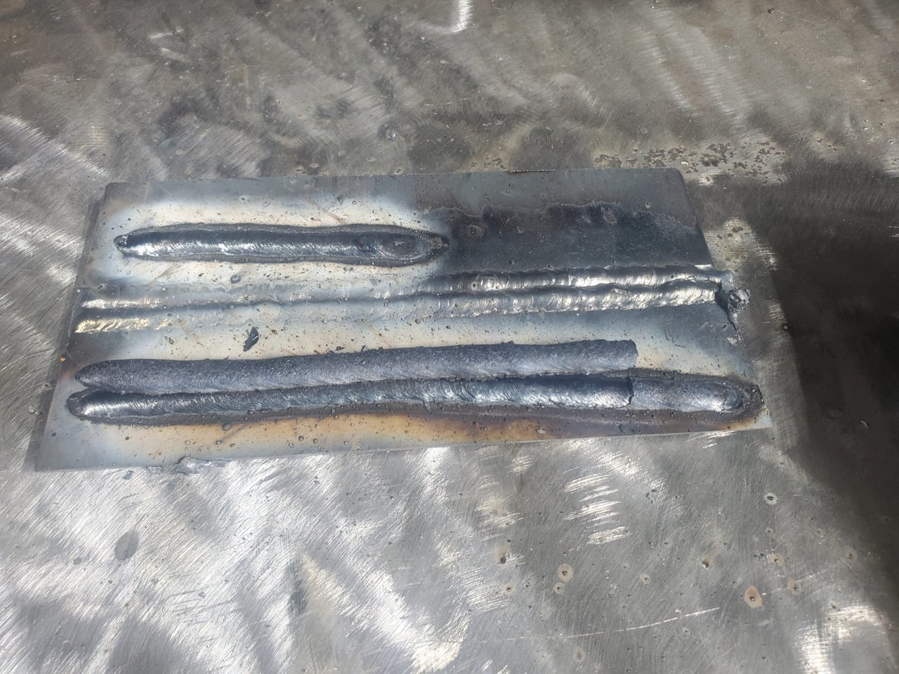

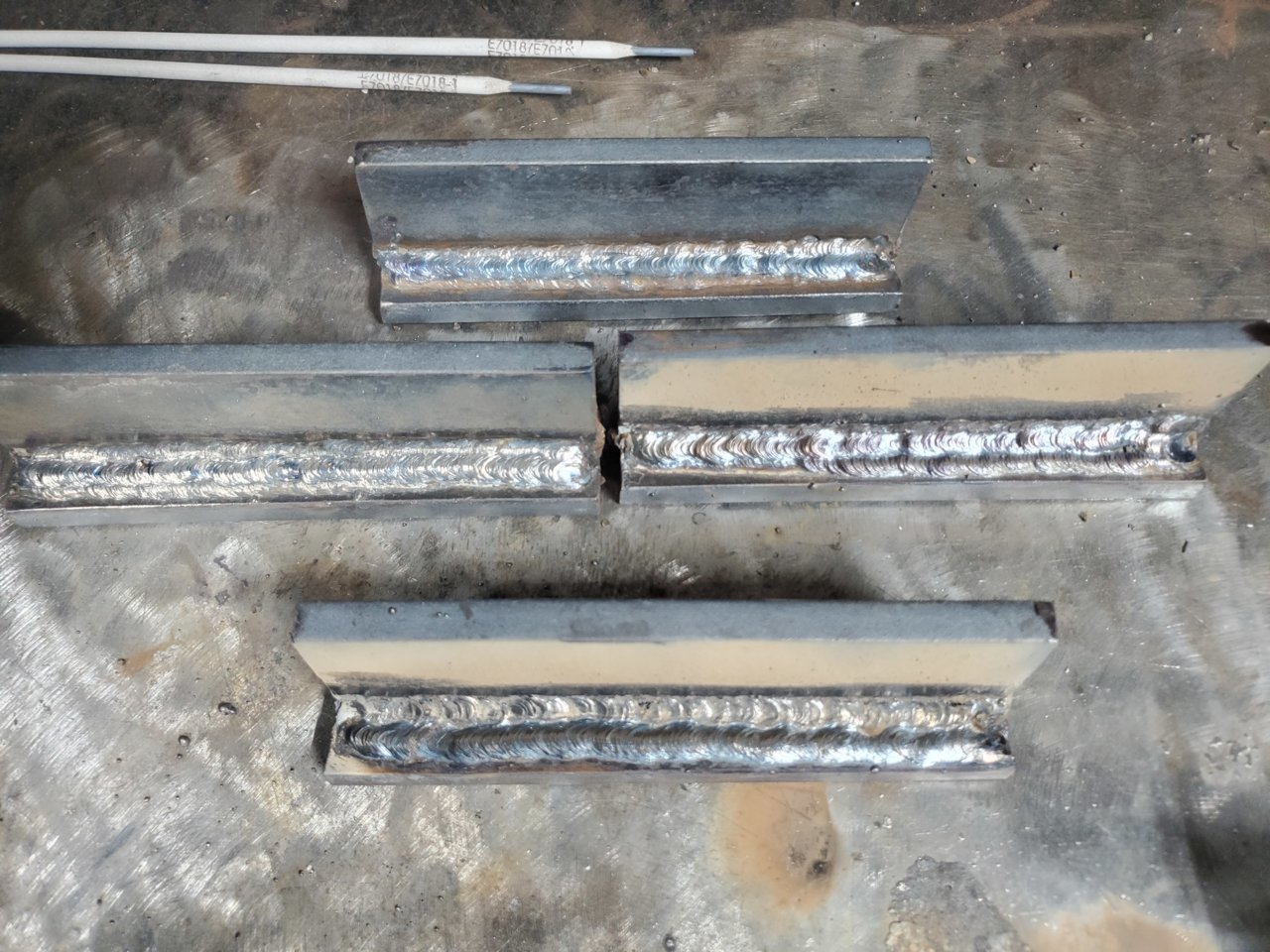

    Week 12, what a busy 2 days it's been already!
    I promise I didn't forget my own thread!
    Monday was a nice surprise, both in and out of class.

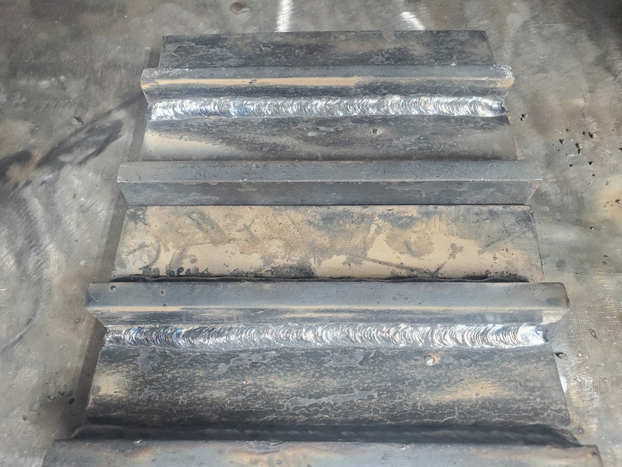

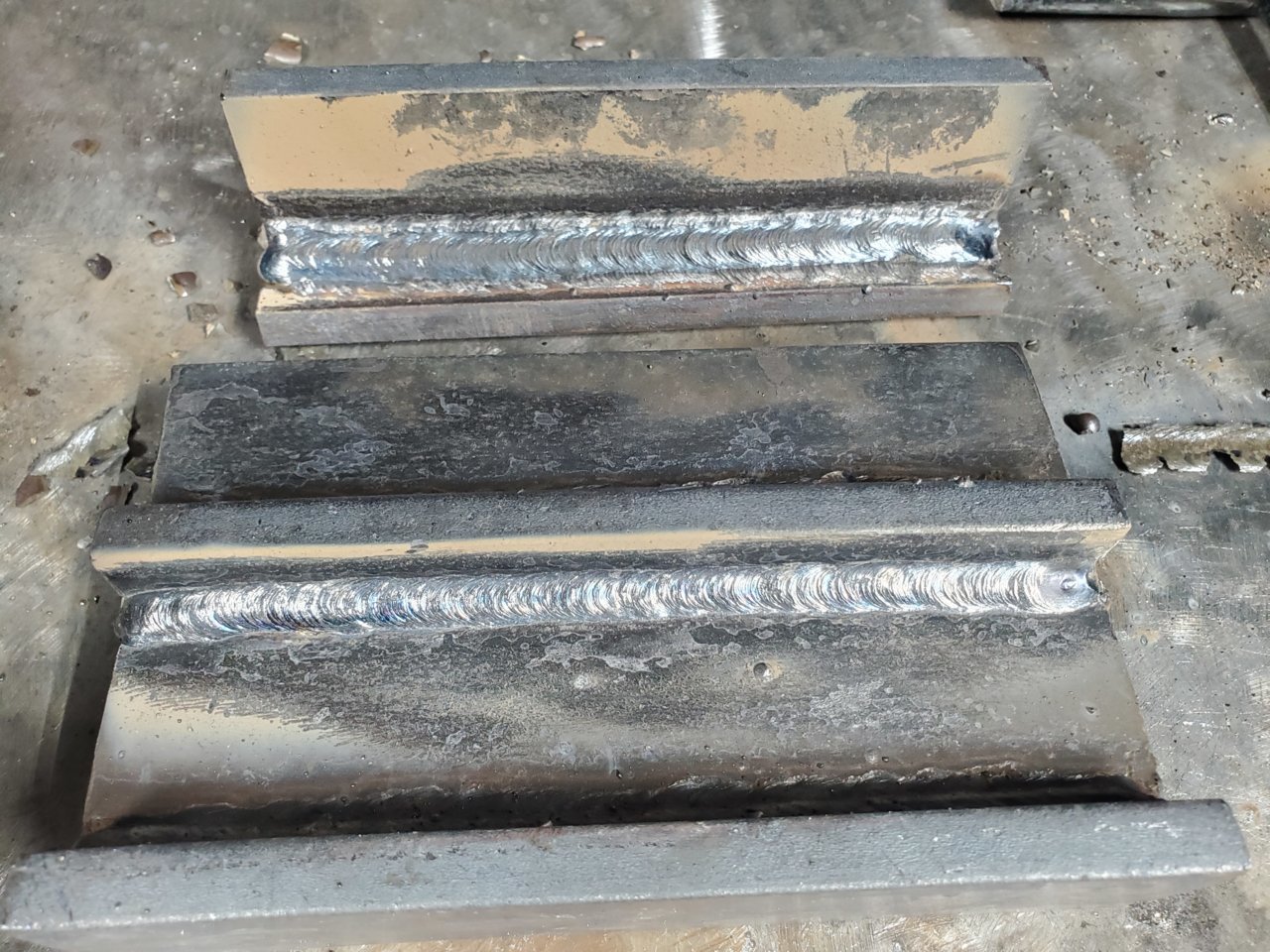

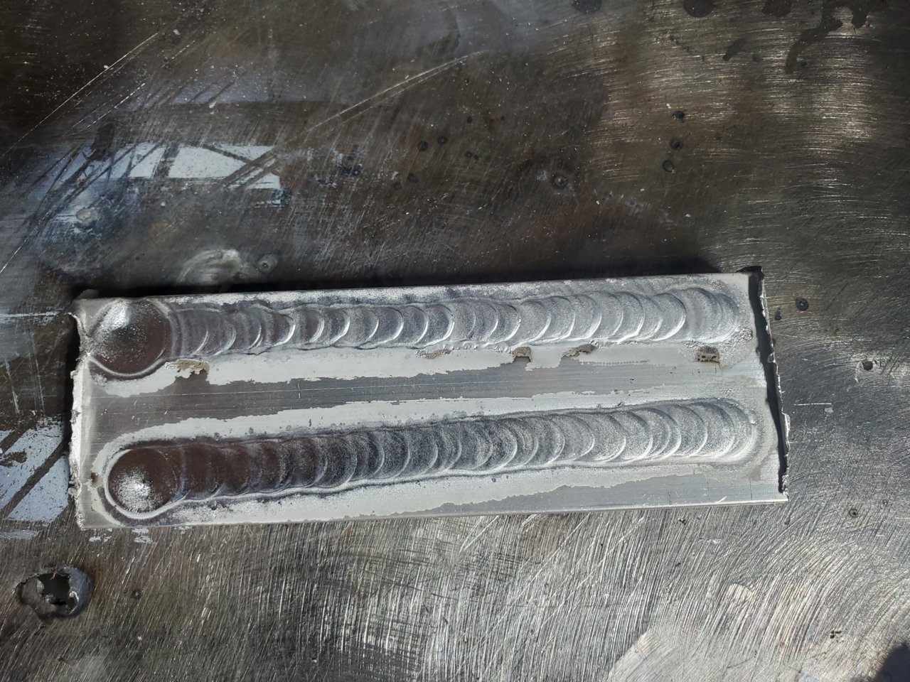

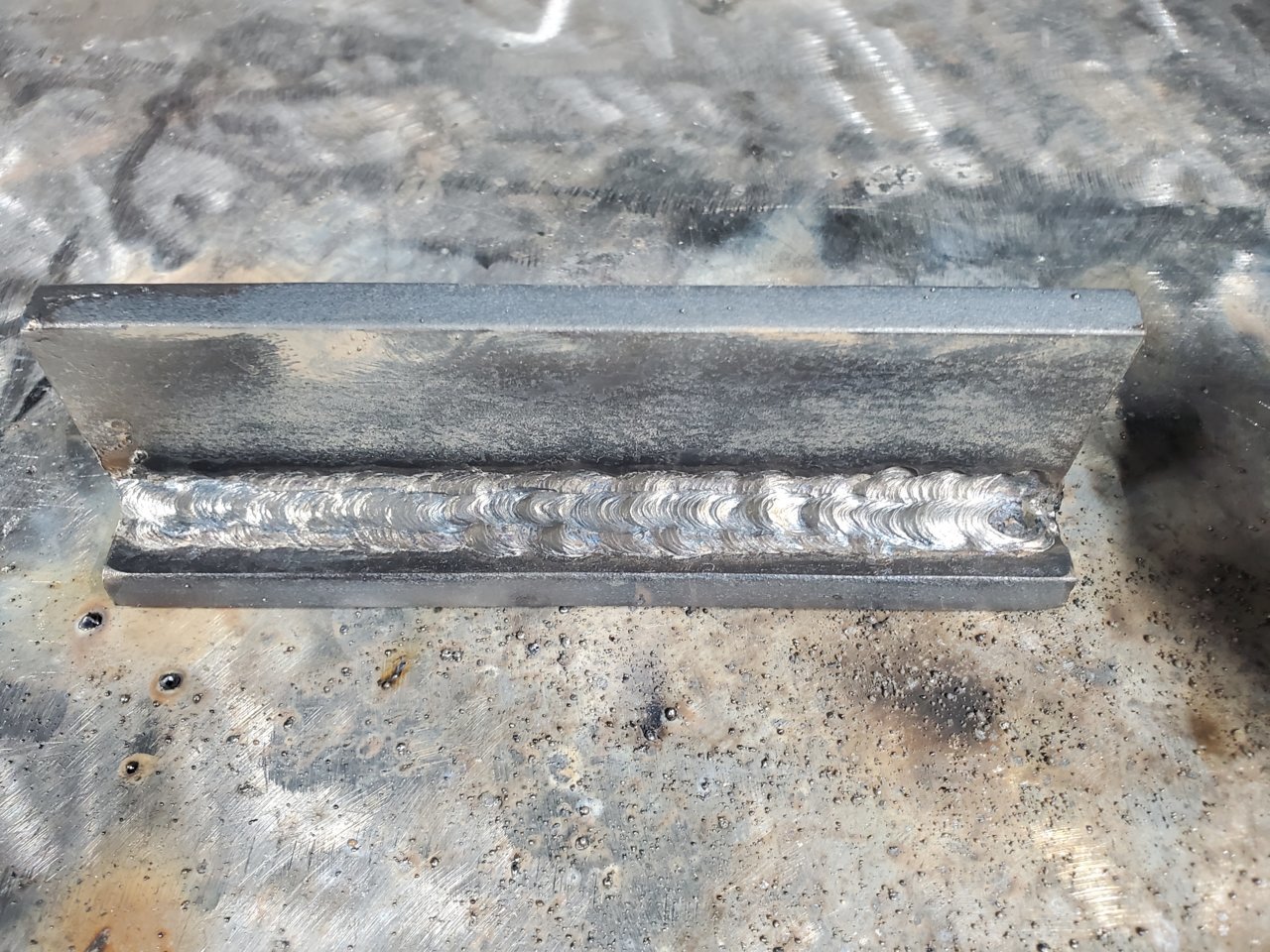

    For starters, since I missed a module of stick welding (since I started school 3-4 modules after everyone), the instructor is having me do T's and the sort with stick only.
    Doing a 6010 pass, then running 3 passes with 7018 and so forth. I'm about posting my welds, not just the good ones but the bad ones too -
    Stringers, stitch, I'm messing with multiple rods too.
    Today I laid some nice ones after yesterday's runs -

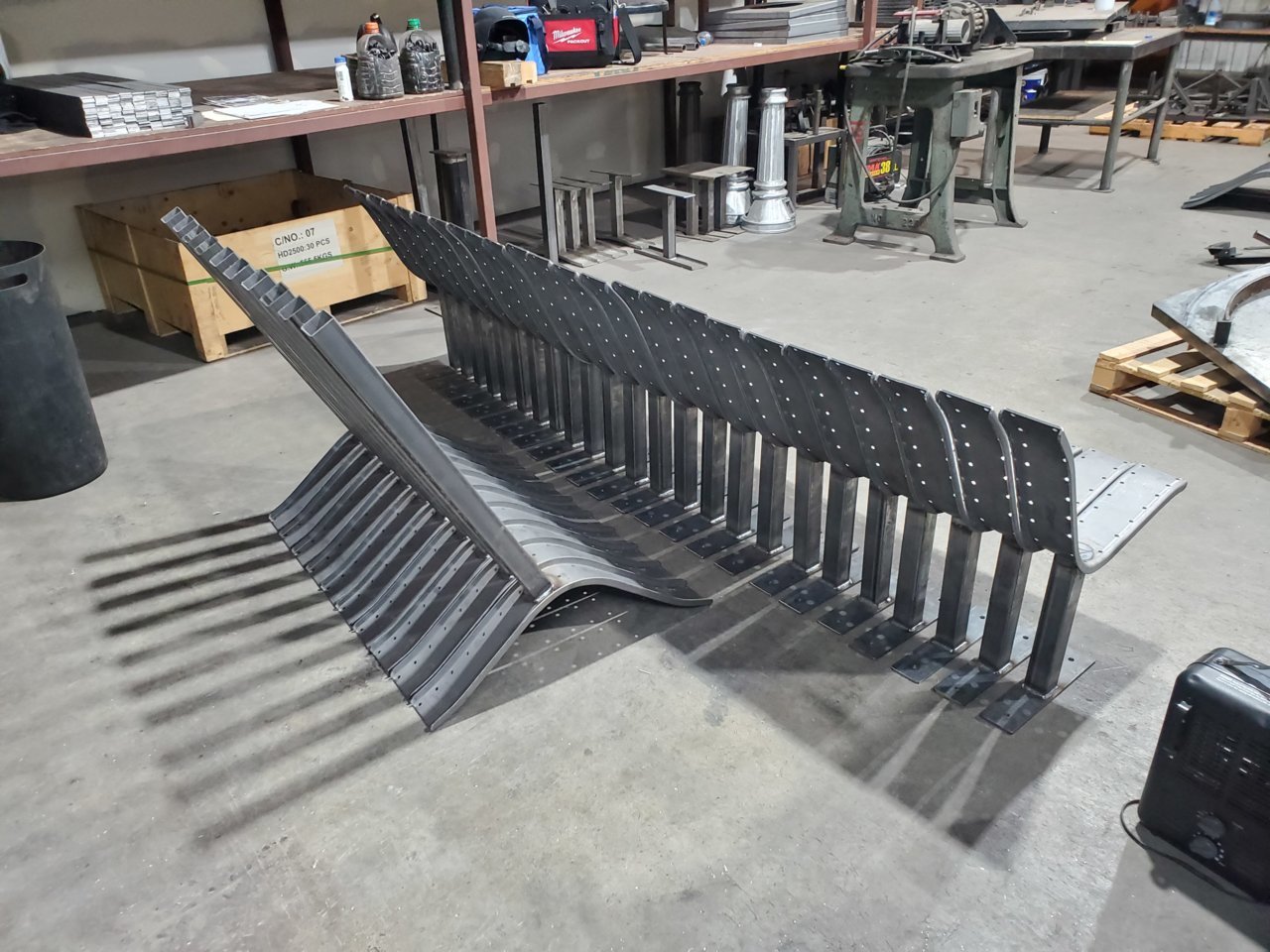

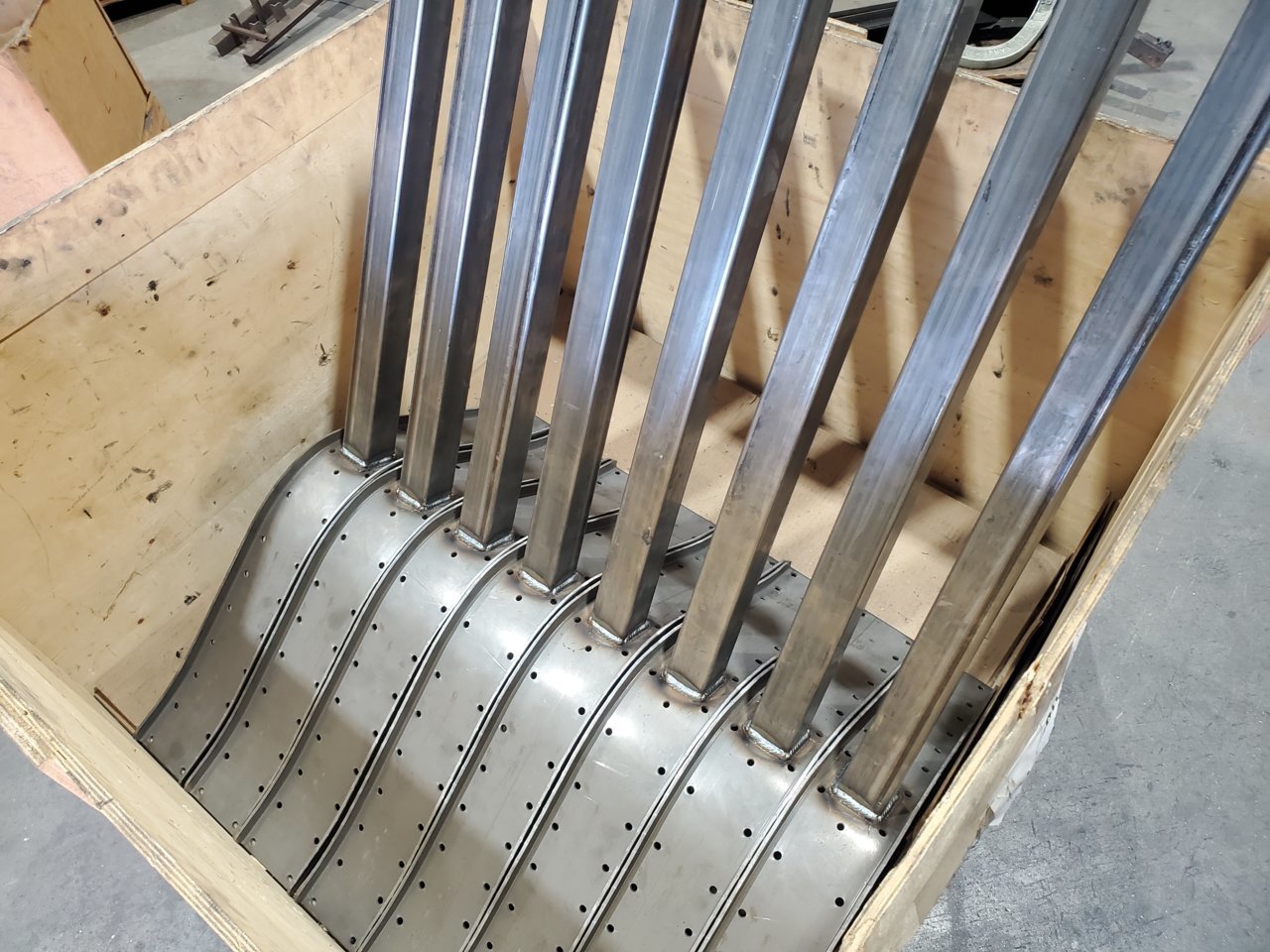

    Monday, rather than having to work on those legs I started on last week, they had me weld some 18 bench frames together -
    And today, another 6 not to mention 20 (10 done) benches without the bottom plate since they get attached to the ground -

    You are so right; due to the odd curve/shape of these things, I'm slightly out of position welding the seat bottom portion.
    After doing a few, the rest come easy. Nothing I would've been practicing at school really.

    When I got to work today to check out the other shops, I was surprised to see this -
    Those are the benches I made Monday night.
    Was told we had another order soooo...
    Always something to do at the shop :welder:

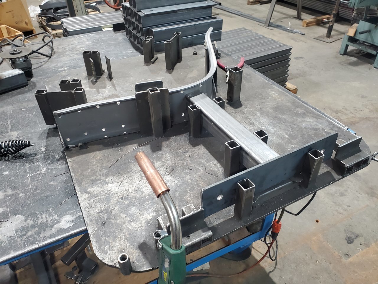

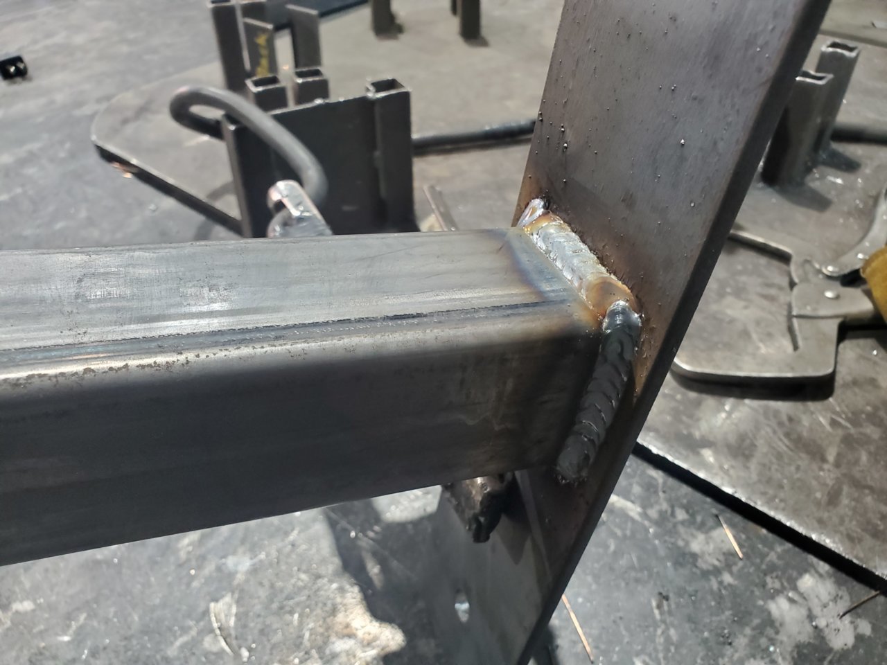

    82,888
    Fresno County
    4 run, 2 don't
    Man, it's just awesome learning each and everyday...especially at work.

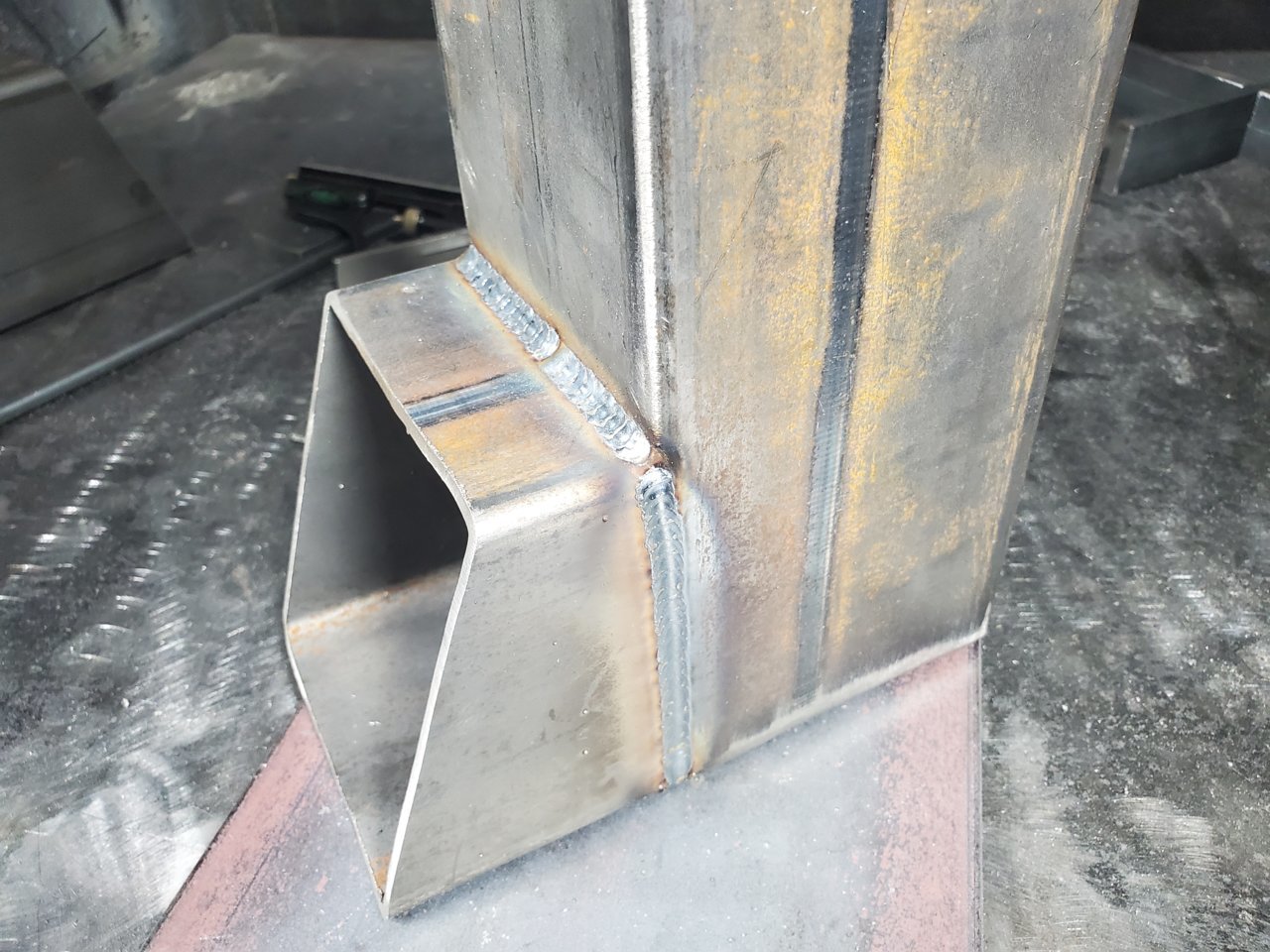

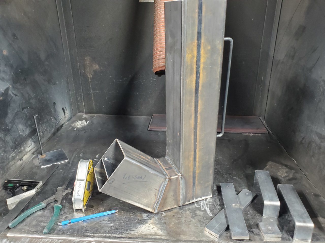

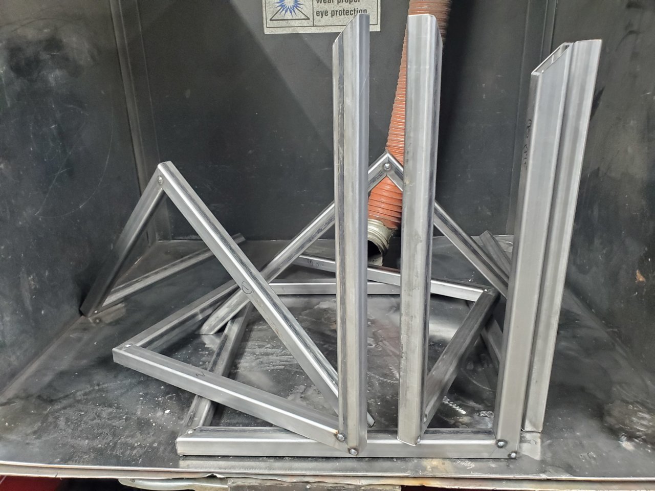

    Those 120 brackets I drilled last week?

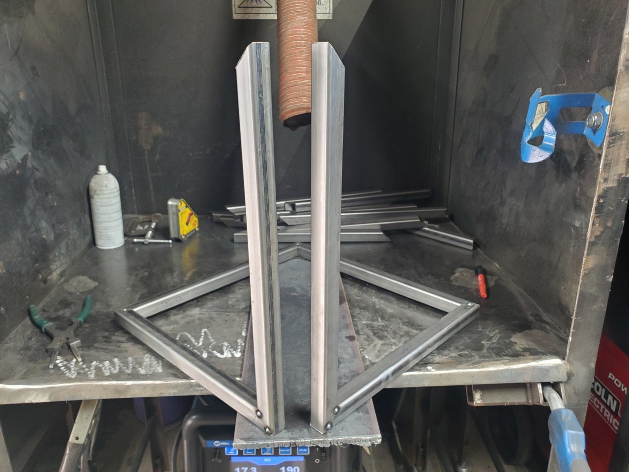

    Well, I have to weld them up either starting tomorrow or next week. So I got one together and decided I need to make a jig -
    Bare with me as I've never done this sort of thing. I'm sure there are better ways to have done this with less steel.
    Here I laid some pieces out after having pictured it in my head -
    First pieces laid out -
    All done -
    Because the cuts aren't perfect, I'm hoping this jig would help me keep everything square.
    So far so good -
    GHOST SHIP likes this.
  18. Dec 10, 2021 at 9:44 AM
    #198
    ndmak
    ndmak Well-Known Member
    Nov 18, 2014
    #142657
    316

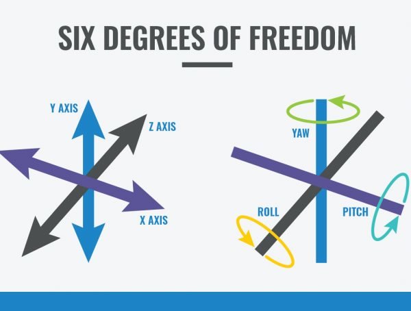

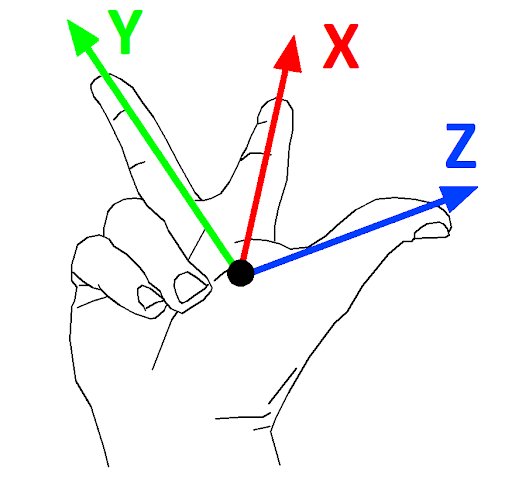

    jig/fixture tooling is an artform in and of itself! from what i remember, that in the fixture you designed, your part would probably be technically considered "over constrained". this refers to the axis of possible motion of the part and the degrees of freedom available to the part. "over constrained" means that you have redundant means in place of limiting movement along one or more of the degrees of freedom.
    degrees of freedom.jpg right hand rule.jpgsome will say there are six degrees of freedom, i usually tell myself there are 12 so i dont forget the negative direction of each one.
    https://www.enerpac.com/en-us/training/e/the-321-locating-principle
    https://www.mecholic.com/2017/11/3-2-1-principle-of-location-six-point.html
    https://learnmech.com/3-2-1-principle-used-for-jig-and-fixture-locating-method/
    at first observation, one may think "well if i have it clamped down and it cant move, thats good, it will prevent/limit distortion" and while this may be true, warping and distortion are always present. its just a matter of how much and where it presents itself. and an operator can use clamping/fixtures to their advantage, it is something to be aware of and to do it on purpose. it is possible to predict/anticipate where the distortion/warping will be, and use that to your advantage by leaving a gap on one end, welding the other end, then the gap closes up for a perfect fit-up.
    another option for you could have been just to make one corner and rotate the part into the fixture after each tack.
    also you are probably already aware of this, but it is usually best practice to tack weld in the fixture, then remove the part for final welding so the warping doesnt lock your part into the fixture.
    but the important thing is that your parts are coming out to spec
    . realistically on benches and table frames, what i mentioned about over constrained probably isnt going to matter much. but maybe sometime in the future if you ever run into issues in fixturing and a part just will not come out consistent, this comment will spark a thought and you can do some more research on fixturing/locating a part.
    i am curious tho about the shop's process selection. are you using short arc? if so, on final pieces is the mill scale removed before welding? some mill scale can be pretty thick and inhibit proper fusion/cause discontinuities and defects. dual shield has higher success of proper fusion without removing mill scale. but many shops use short arc to tack and dual shield to complete the weldment.
    this is all my thoughts and opinions, i hope you and anyone will take it and glean the useful information and productive parts and disregard the other stuff.
    Bivouac, Kwikvette[OP] and GHOST SHIP like this.

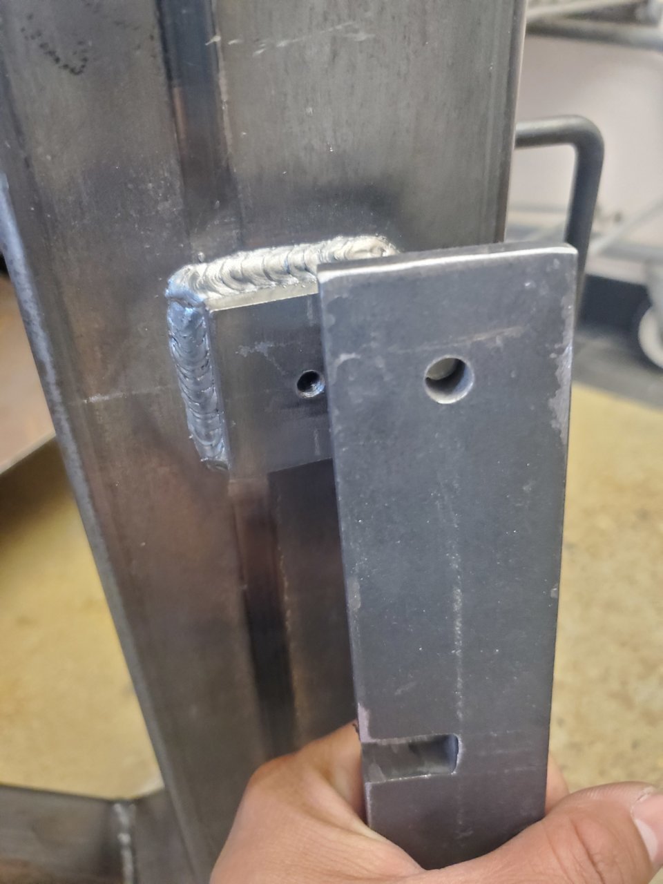

    As of June, I was no longer needed at the fab shopped I started working at in December. It's still available to me, and if needed they will call me. But work is so slow they've let others actually go whereas I volunteered my absence. Flat out said I appreciate the opportunity to continue having me here but I cannot morally stay here, on the clock, and get paid to do basically nothing.
    With that out of the way, onto welding!
    Work provided me with quite the experience...though I'll let the pictures do the talking -
    Working in a small, family owned fabrication shop with jobs that vary from mild steel benches to aluminum light poles and everything in between, I sure as hell learned a lot.

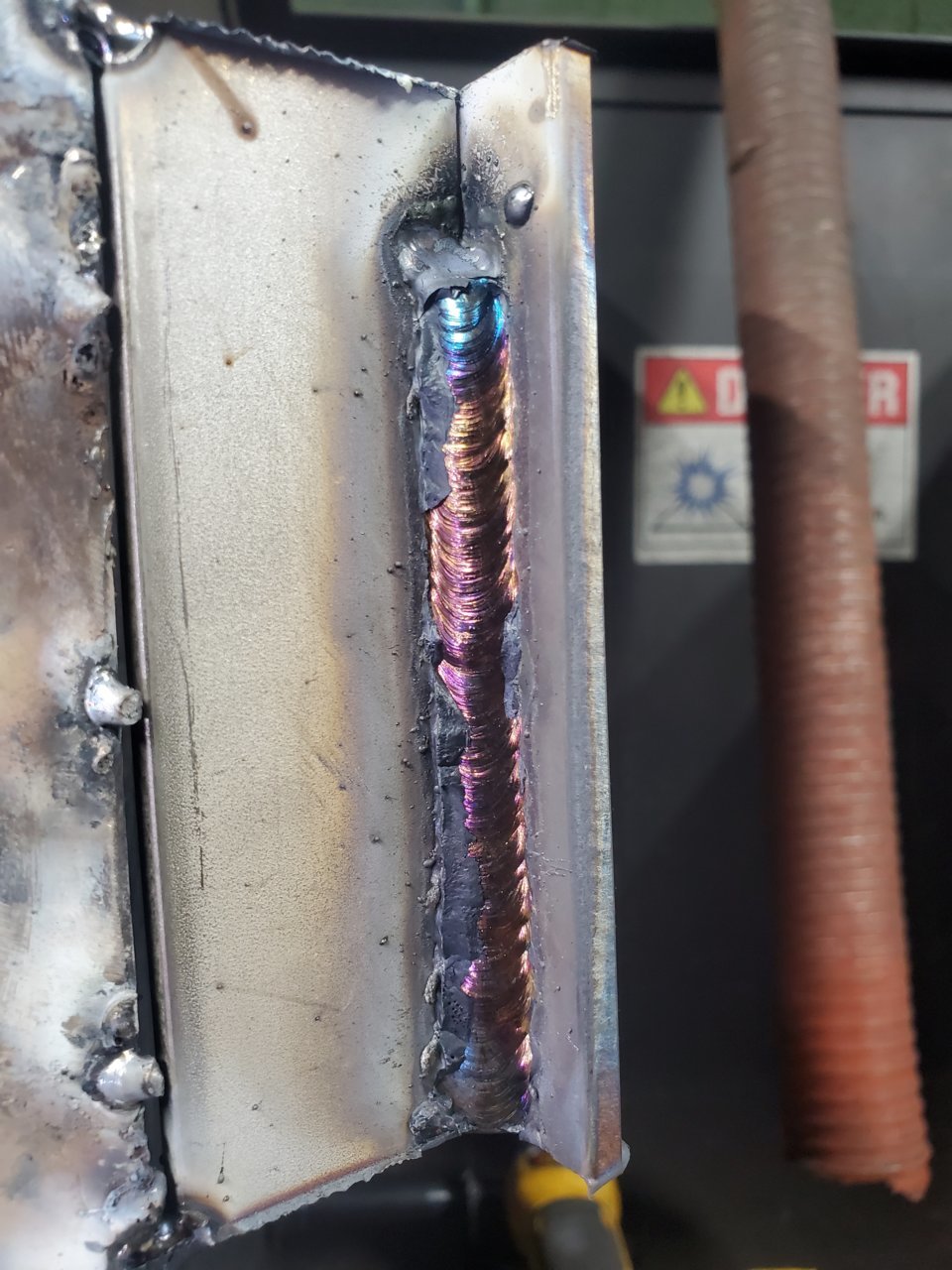

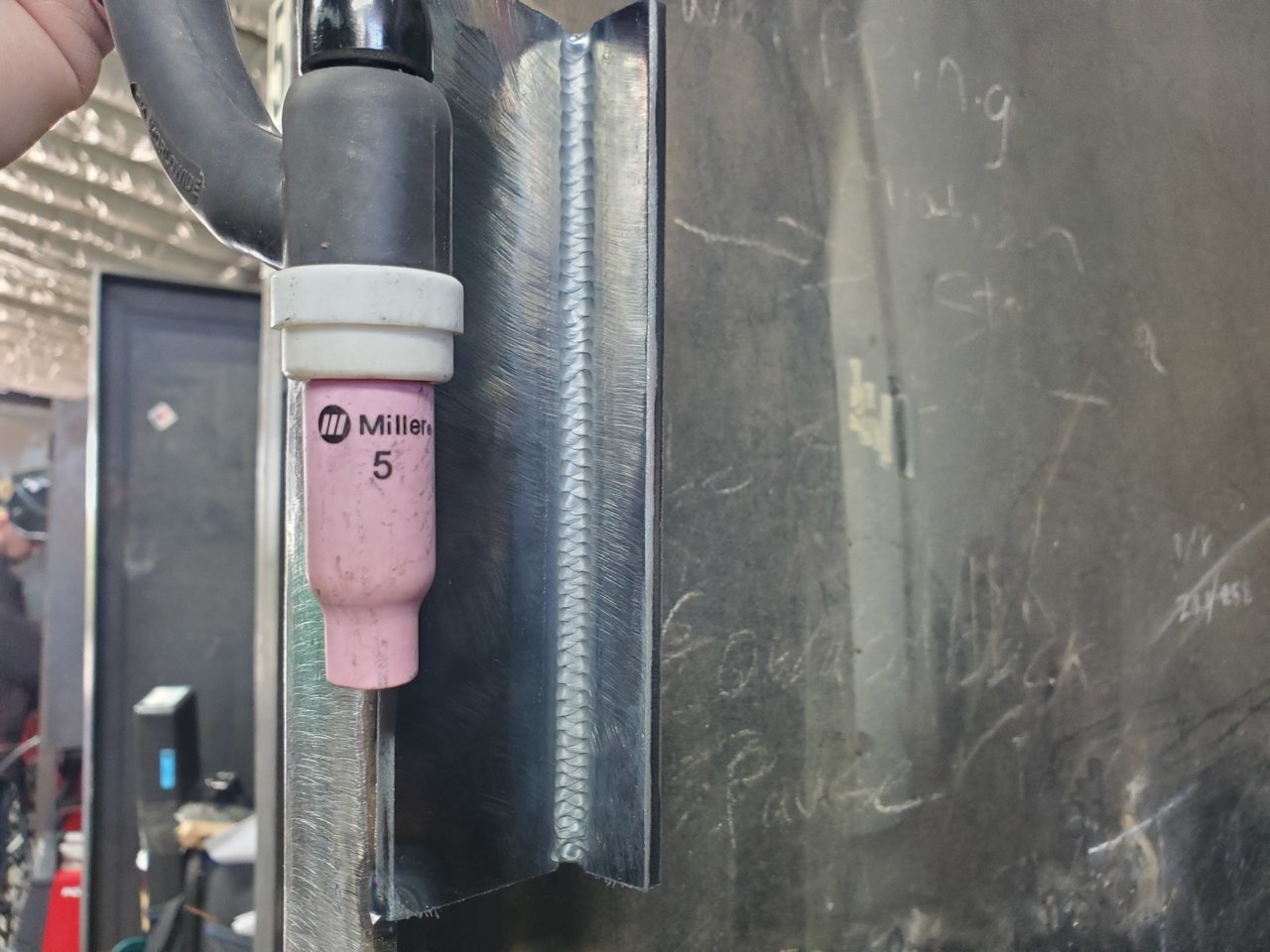

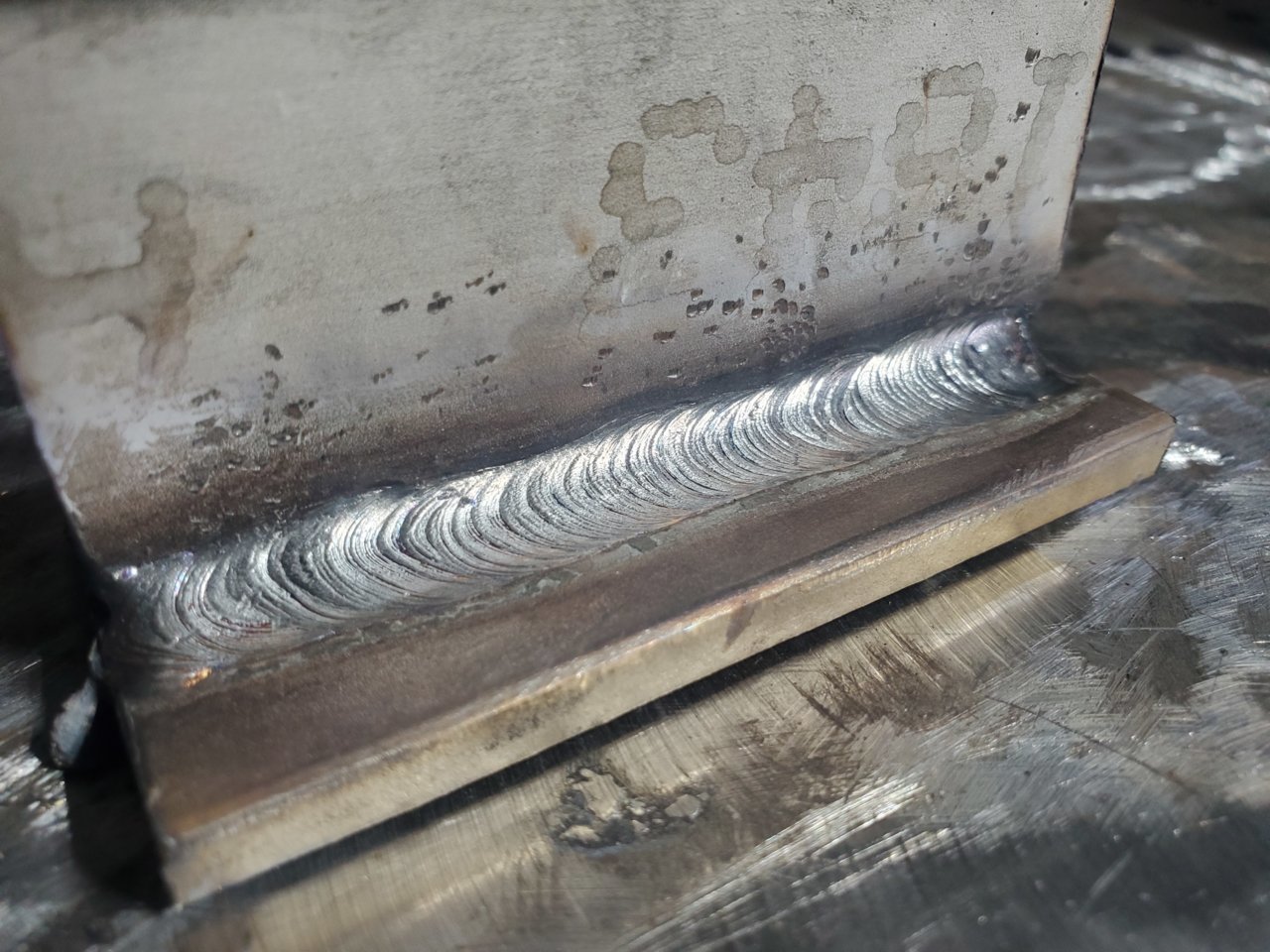

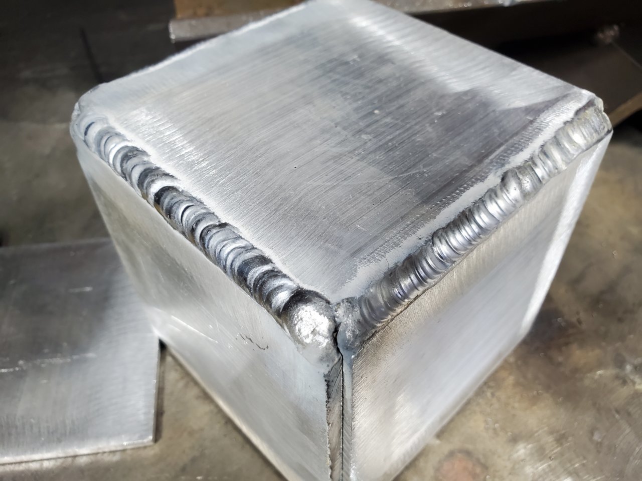

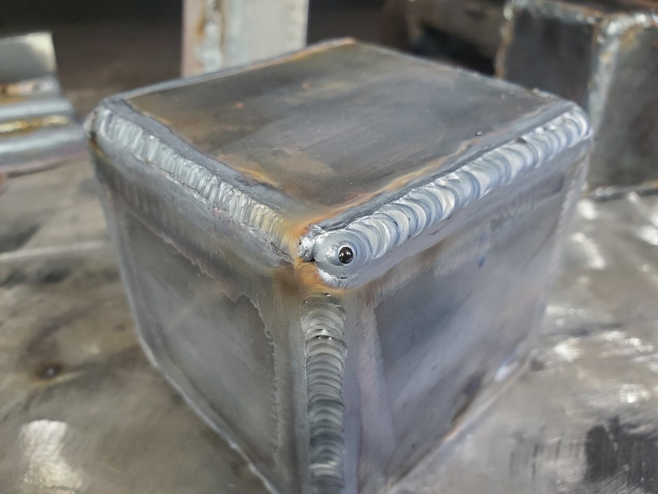

    But let's not forget what I was doing at school too!

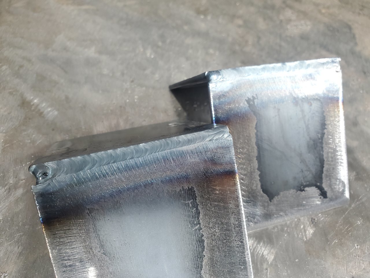

    I had quit posting pictures of MIG because really, anyone can do it. I mean it, if you want to learn MIG, you will.
    Mind you these are older pics and are just a recap from when I left off 8 months ago up until now.
    Stainless MIG -

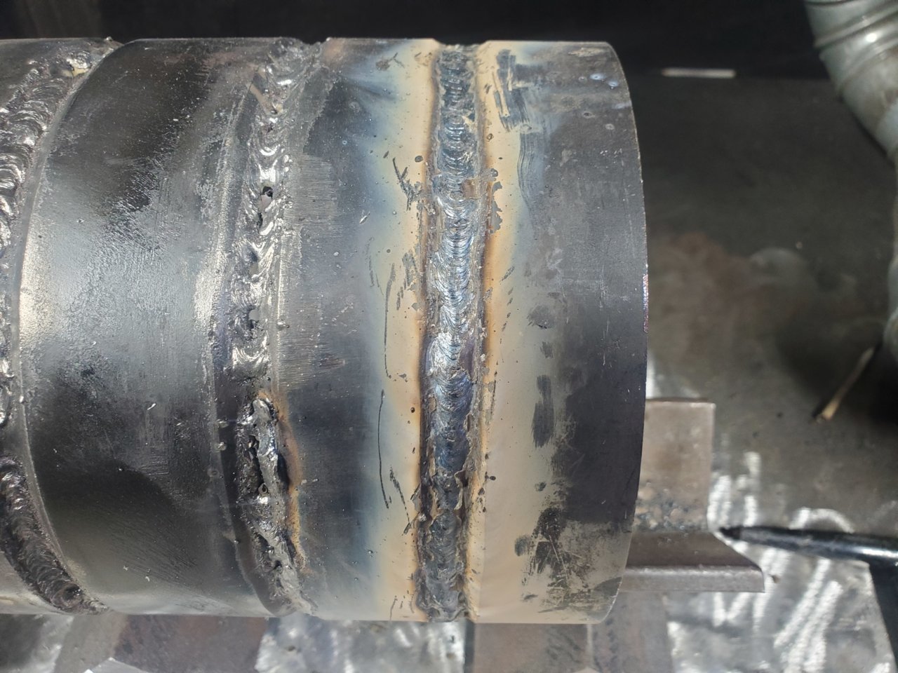

    Stainless stick -
    Stainless stick, but vertical -
    TIG on mild without filler -
    TIG on mild with filler -
    TIG on mild without filler, but vertical -

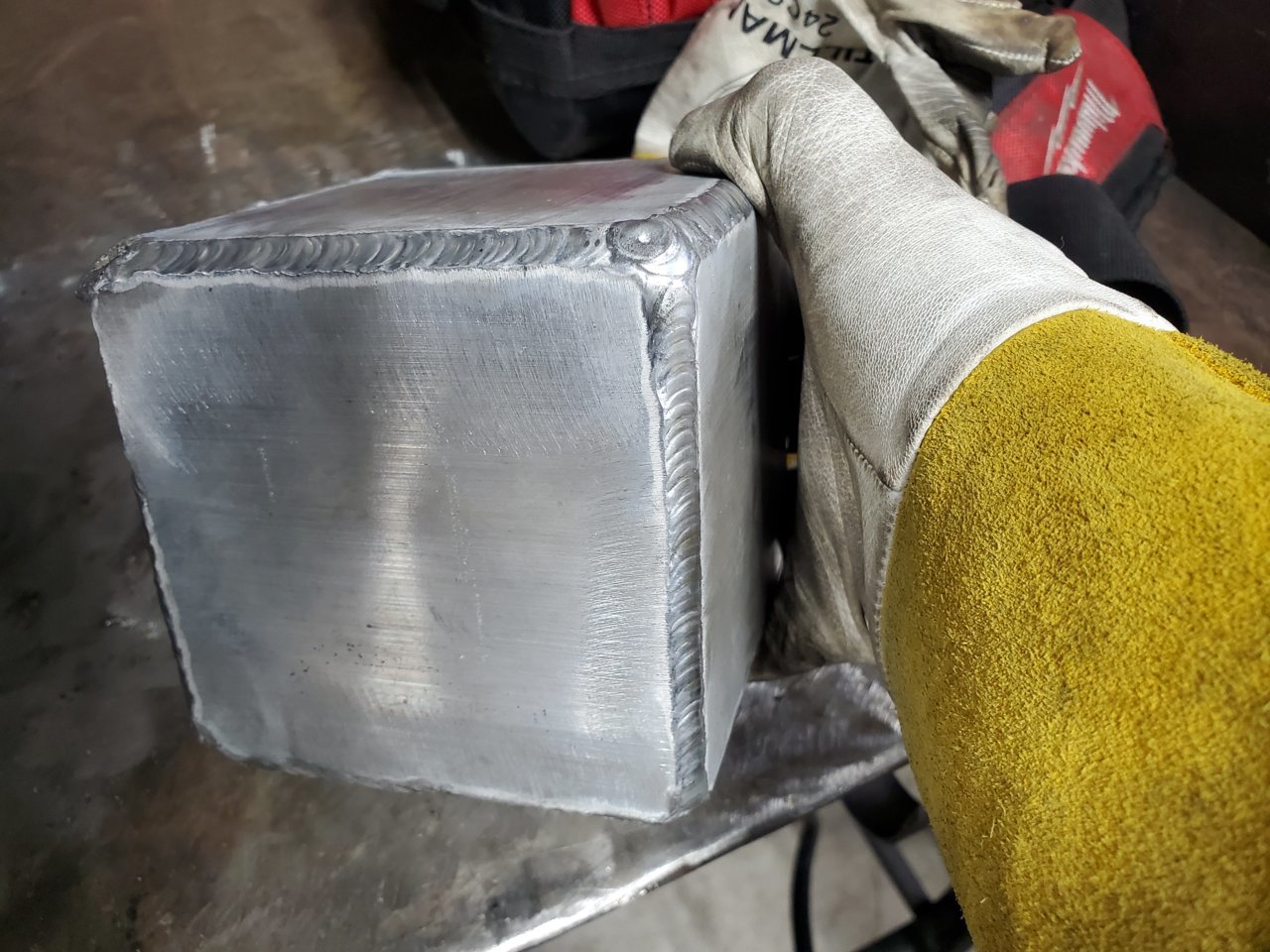

    Aluminum with filler -
    Professional development -

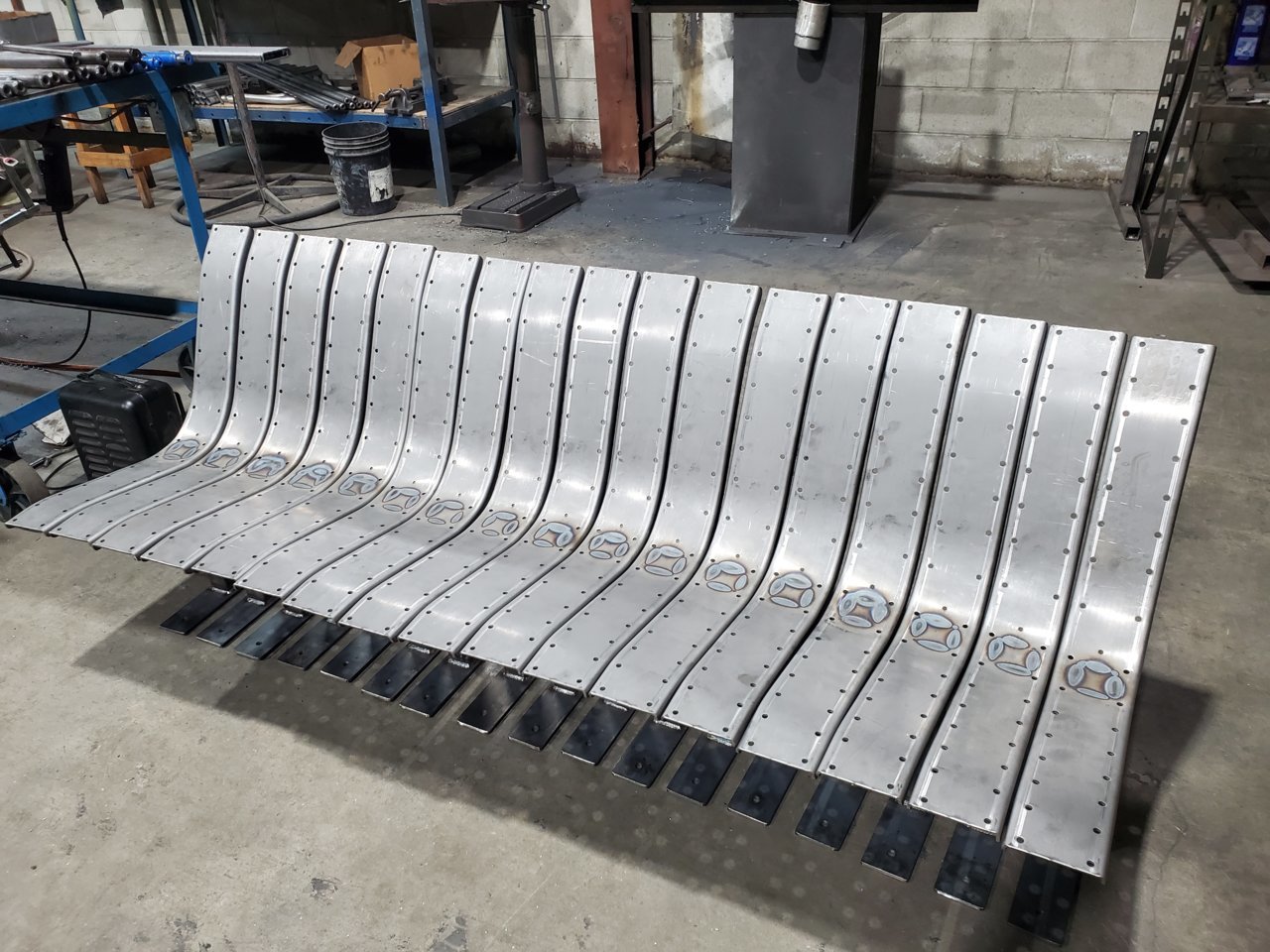

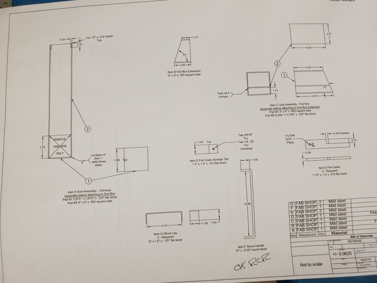

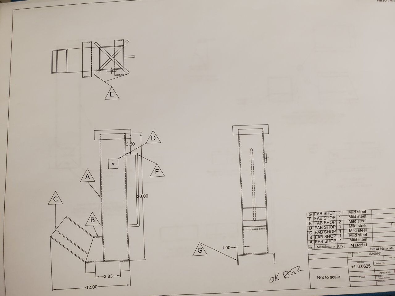

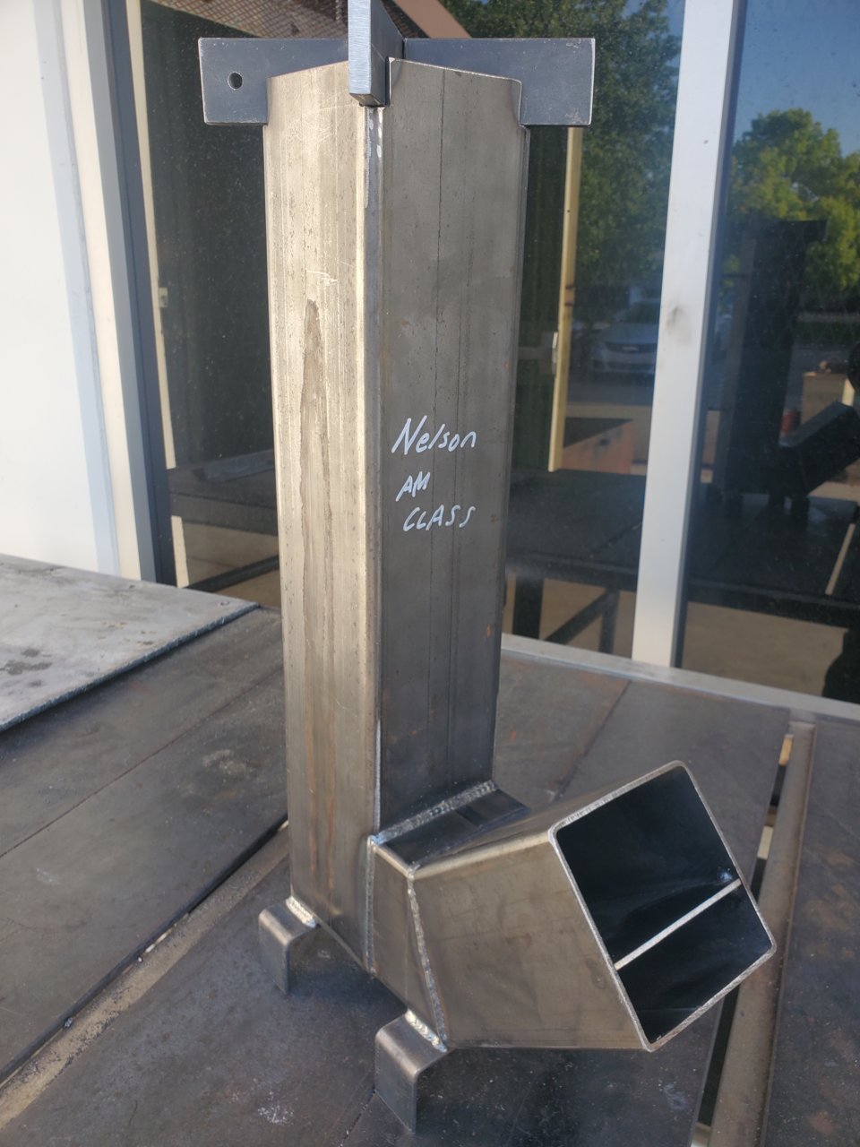

    Skipped cutting some of the pieces, at this point I already had them cut per my blueprint and it was time to weld it all together -

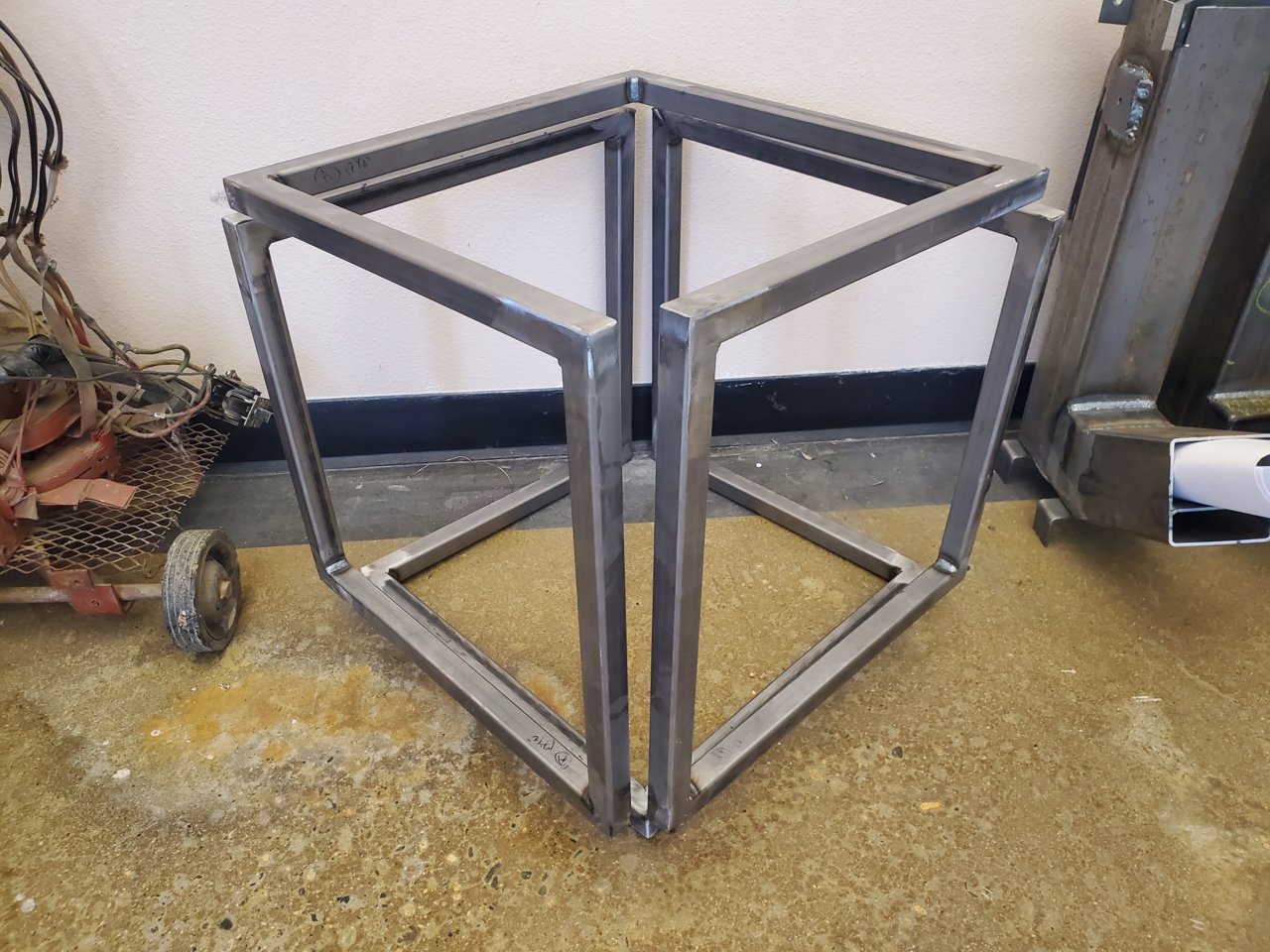

    And an extra credit project that I took on cause apparently my time management is far above and ahead of the other students :rofl:
    Only 1 other student and I were able to do the Infinity Table -
