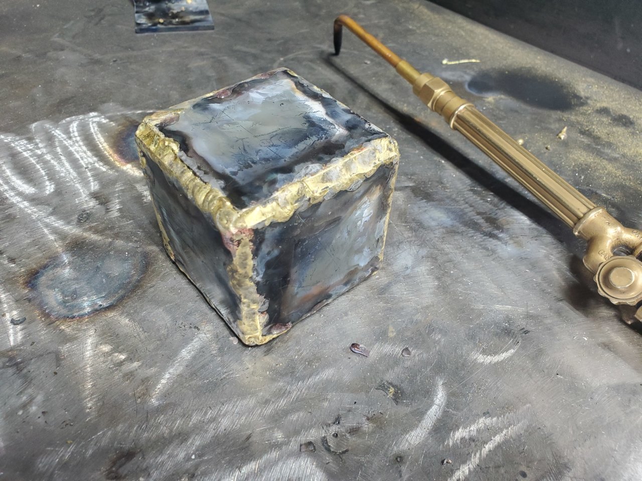

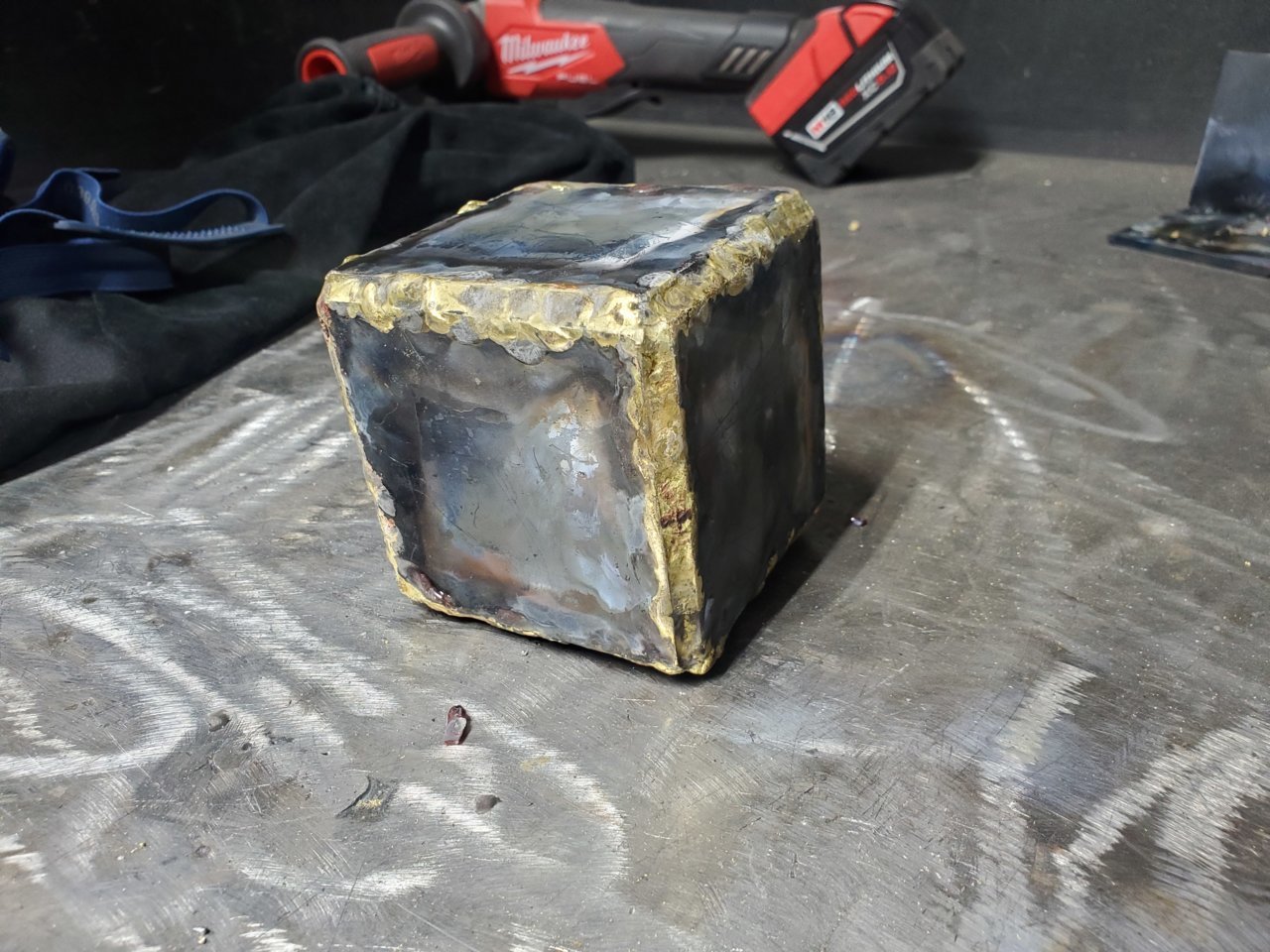

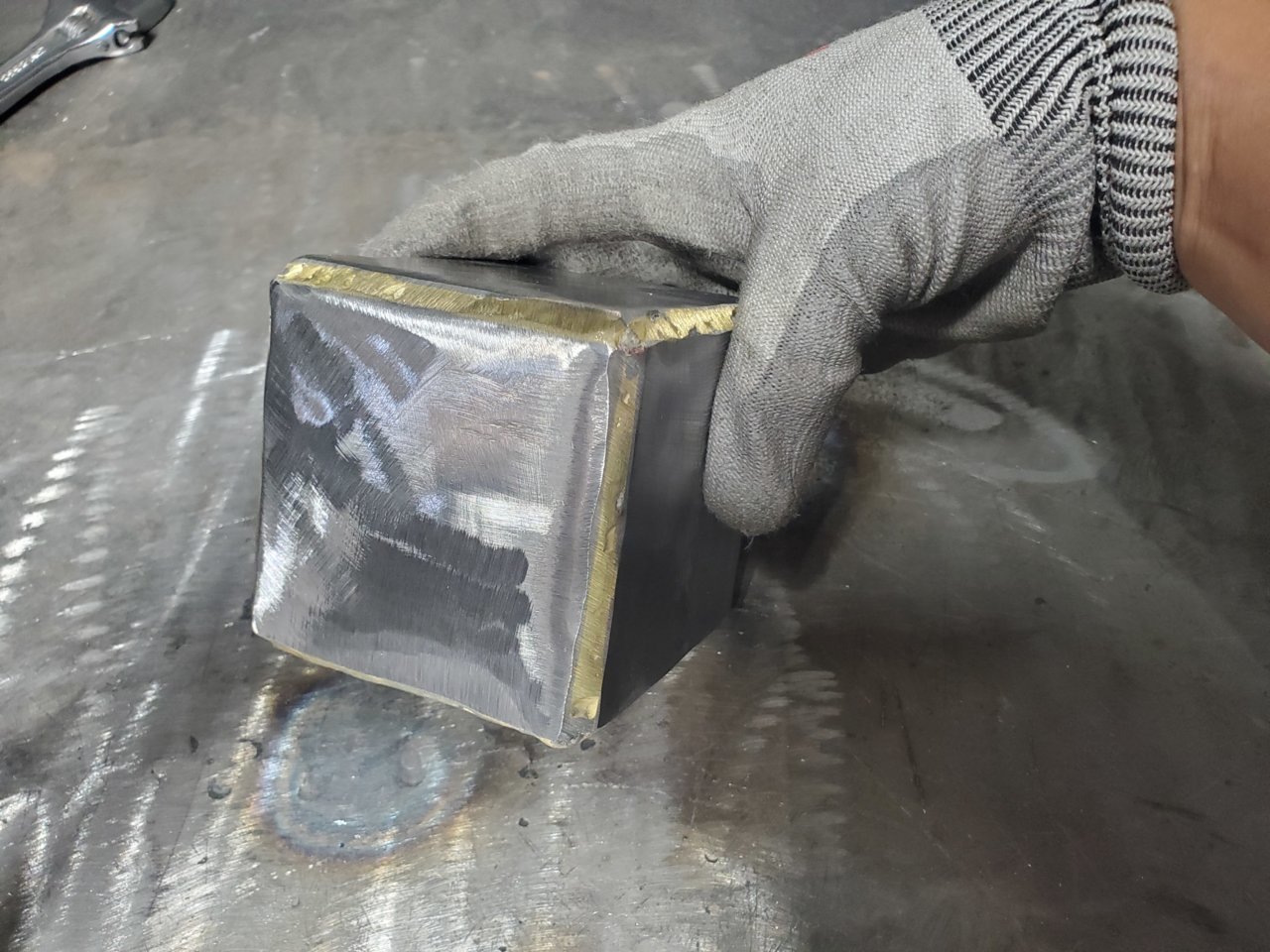

    Took a little bit figuring out my neutral flame only to have a torch that would easily change my pressure if I moved/bumped it ever so slightly.
    I should've just stuck with the same one I had yesterday.
    Anyway I switched torches, found my neutral flame, and went to work -
    Not the prettiest but it held up damn well to a sledge :laughing:
    Now I get to do whatever I want to it; going to clean it up and fill any small holes.

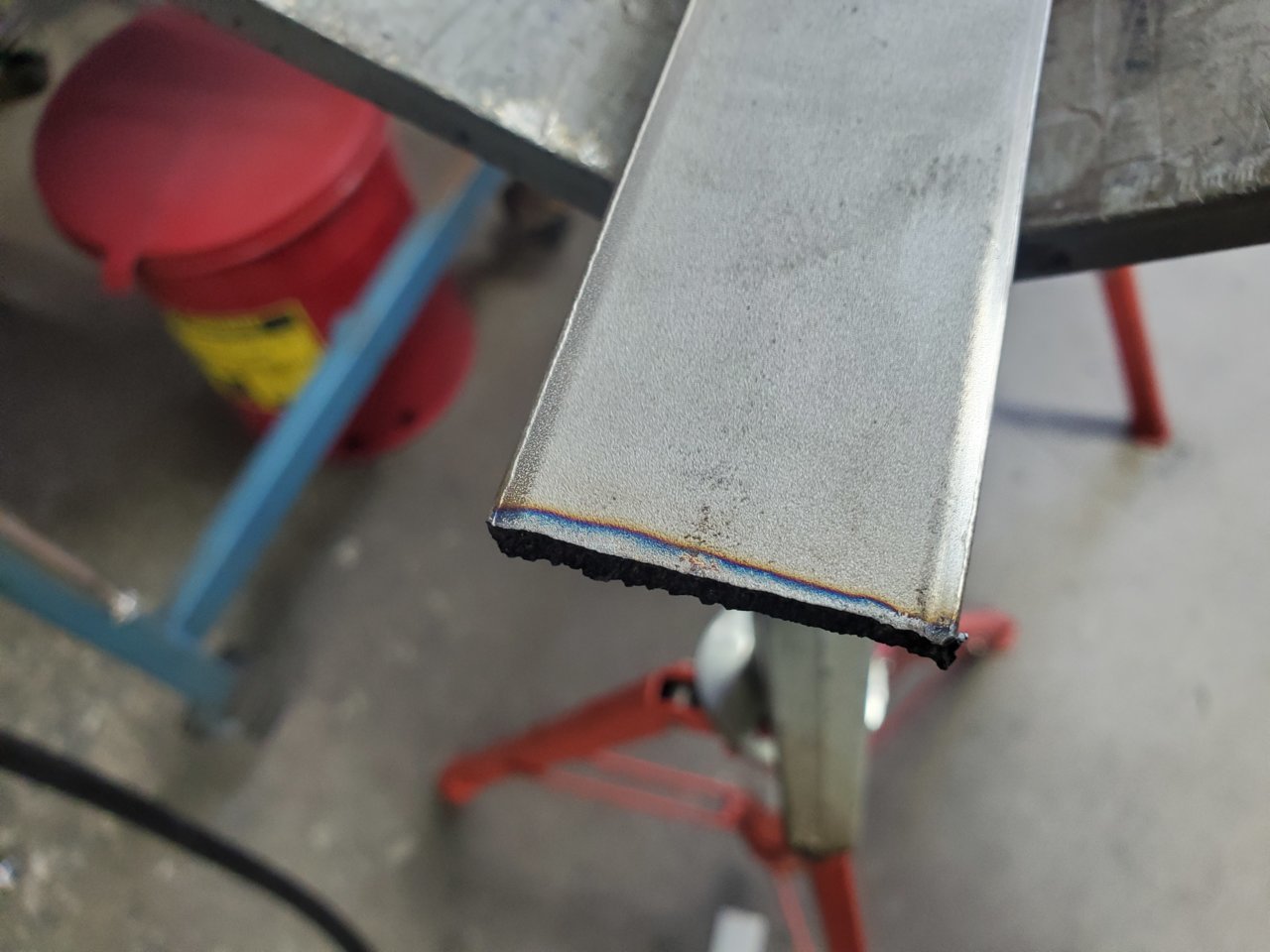

    Week 5: Plasma Cutting!
    Holy shit, cutting with this thing makes anyone look like a pro!
    With what I learned on oxyfuel, in regards to speed and heat, I'm cutting different gauge steel easily on my first pass every pass!
    Playing with 1/8", 1/4" and even 3/16"

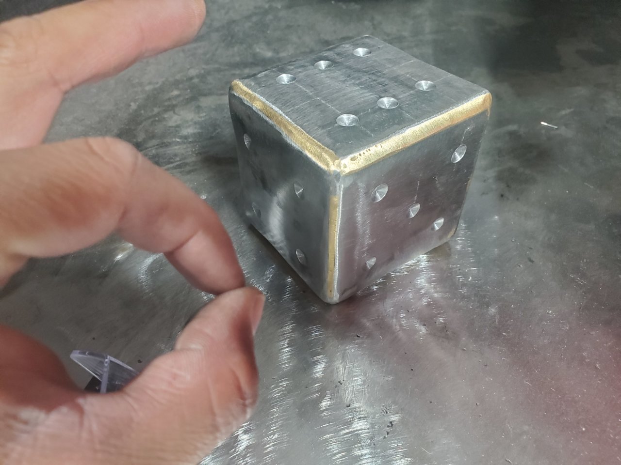

    On a side note, I got to drill the dimples into my dice so that's all done -
    On my own time, I'll go ahead and finish rounding the edges to get it looking good all the way around.

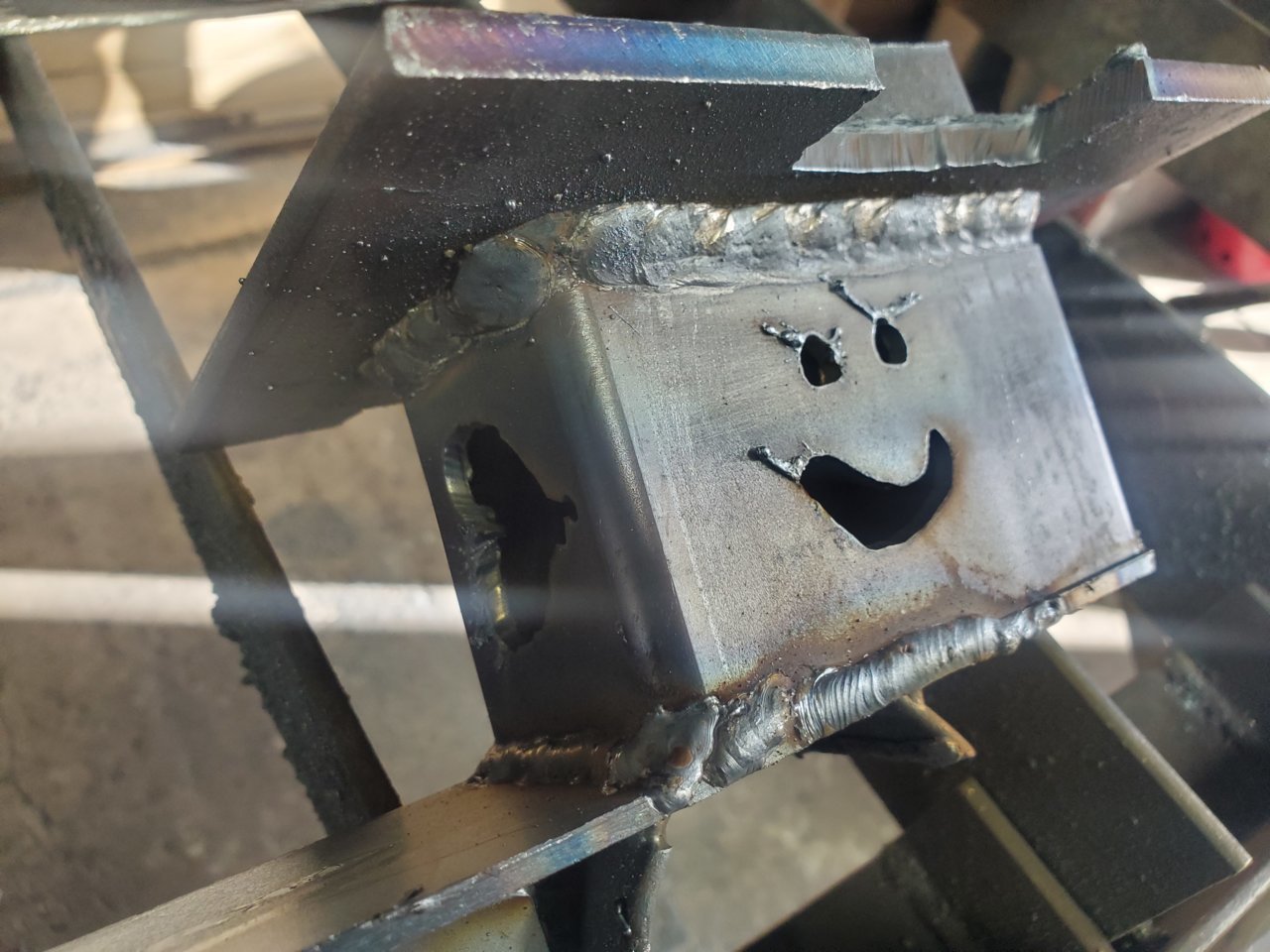

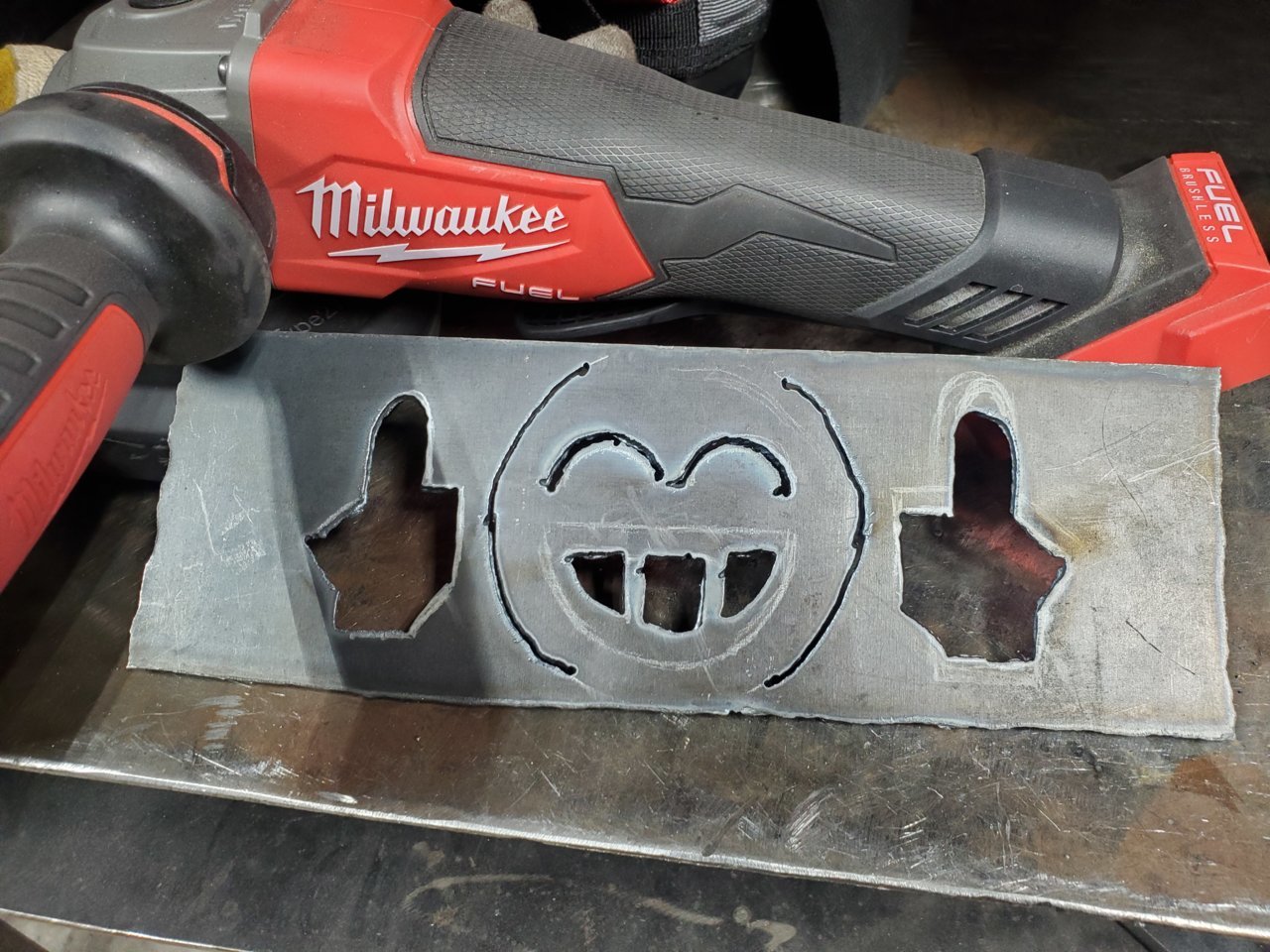

    On another note, this week turned into a -
    Cutting stuff with the plasma for the shop whether it's for scrap, coupons, or even fixing something.
    Also was busy cutting back plates for this storage rack our class built. Went ahead and put it all together too.
    Today, I knocked out my project within 10 minutes of starting which was basically my first project of 2 holes and 2 slots on a 6" x 4 1/2" piece of 3/16ths steel.

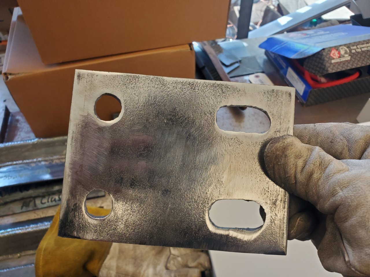

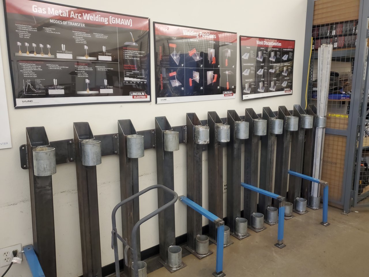

    The storage rack -
    Even with a low powered setup, cutting this stainless is easy and smooth -

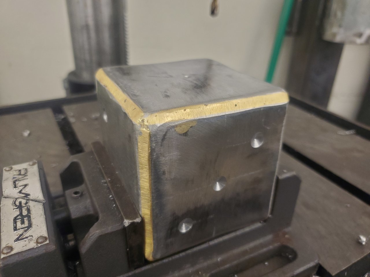

    Also, that project I did my first week of oxyfuel cutting?
    I did it again but with plasma. Only did one quick round with each hole/slot and bam -
    Not found in the syllabus, I went ahead and gave myself something to do because I can :luvya:

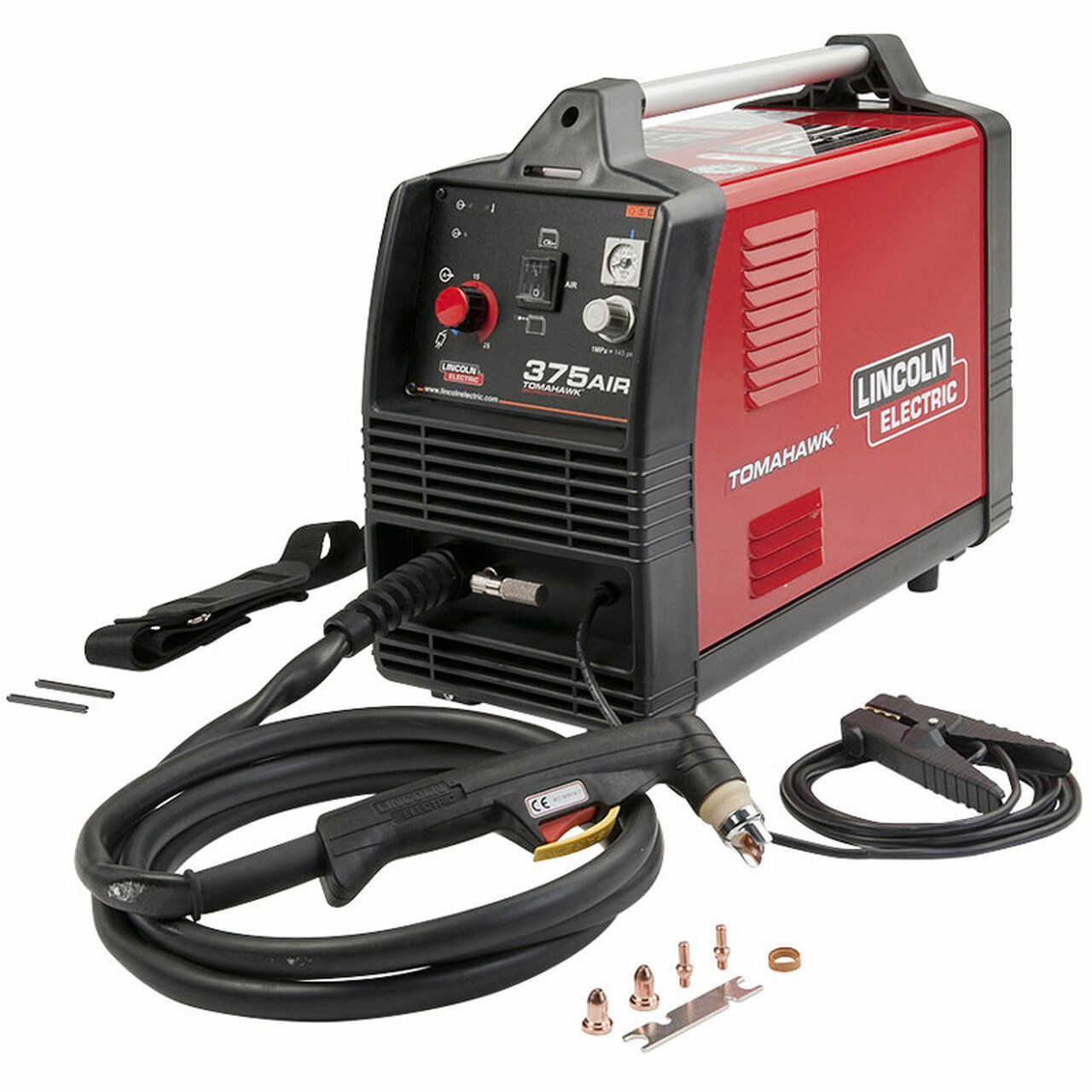

    We have like 3, and the one I was using today is a little Lincoln Electric Tomahawk 375 -
    Rated up to 25A.
    I was using the built-in air compressor which is stupid convenient.

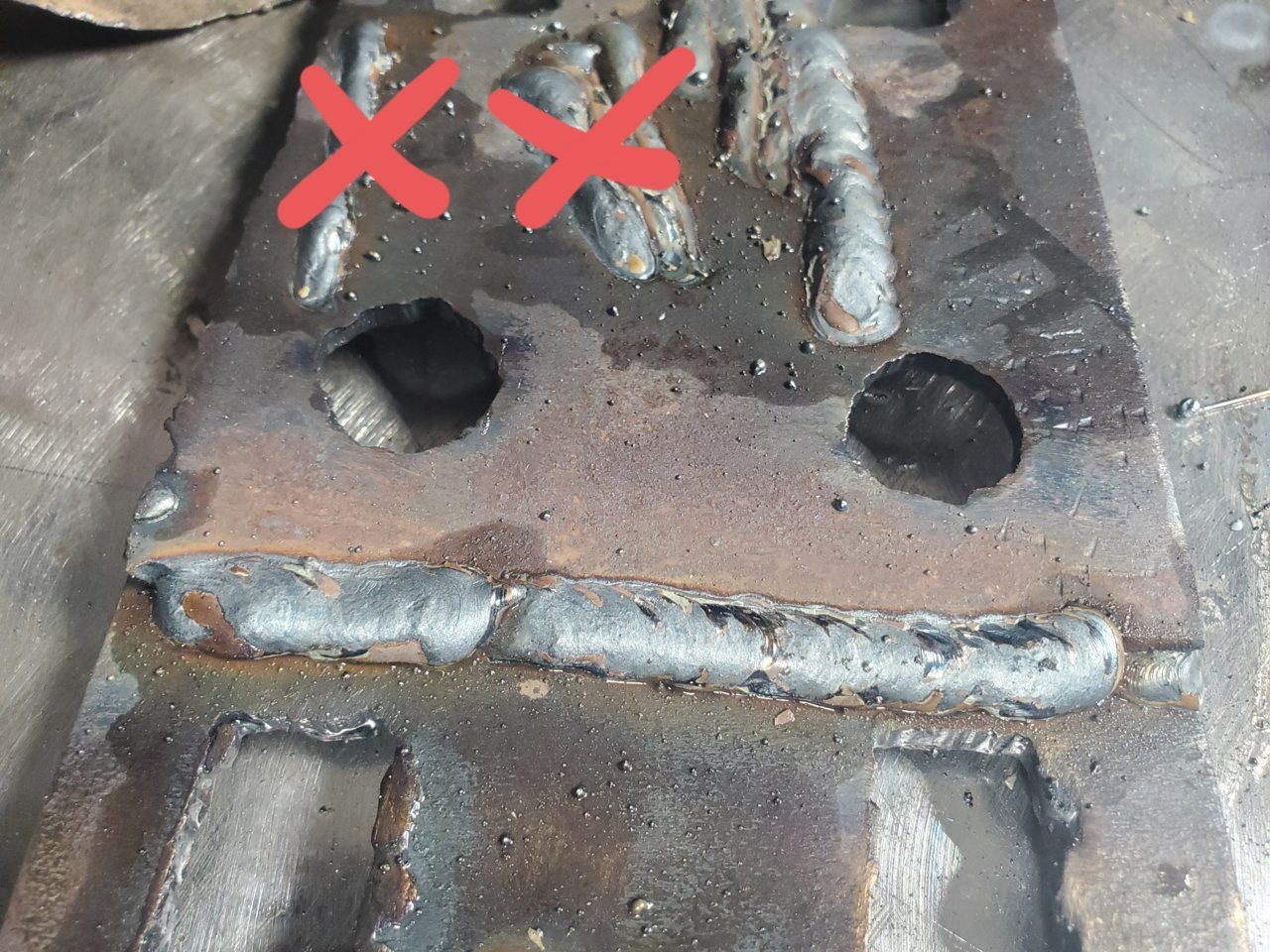

    Week 6: MIG Welding!
    Unfortunately, due to getting a really bad fever, I had to miss 2 days on account of my COVID test results processing.
    With that said, I returned today only to trouble shoot a few machines (as practice).

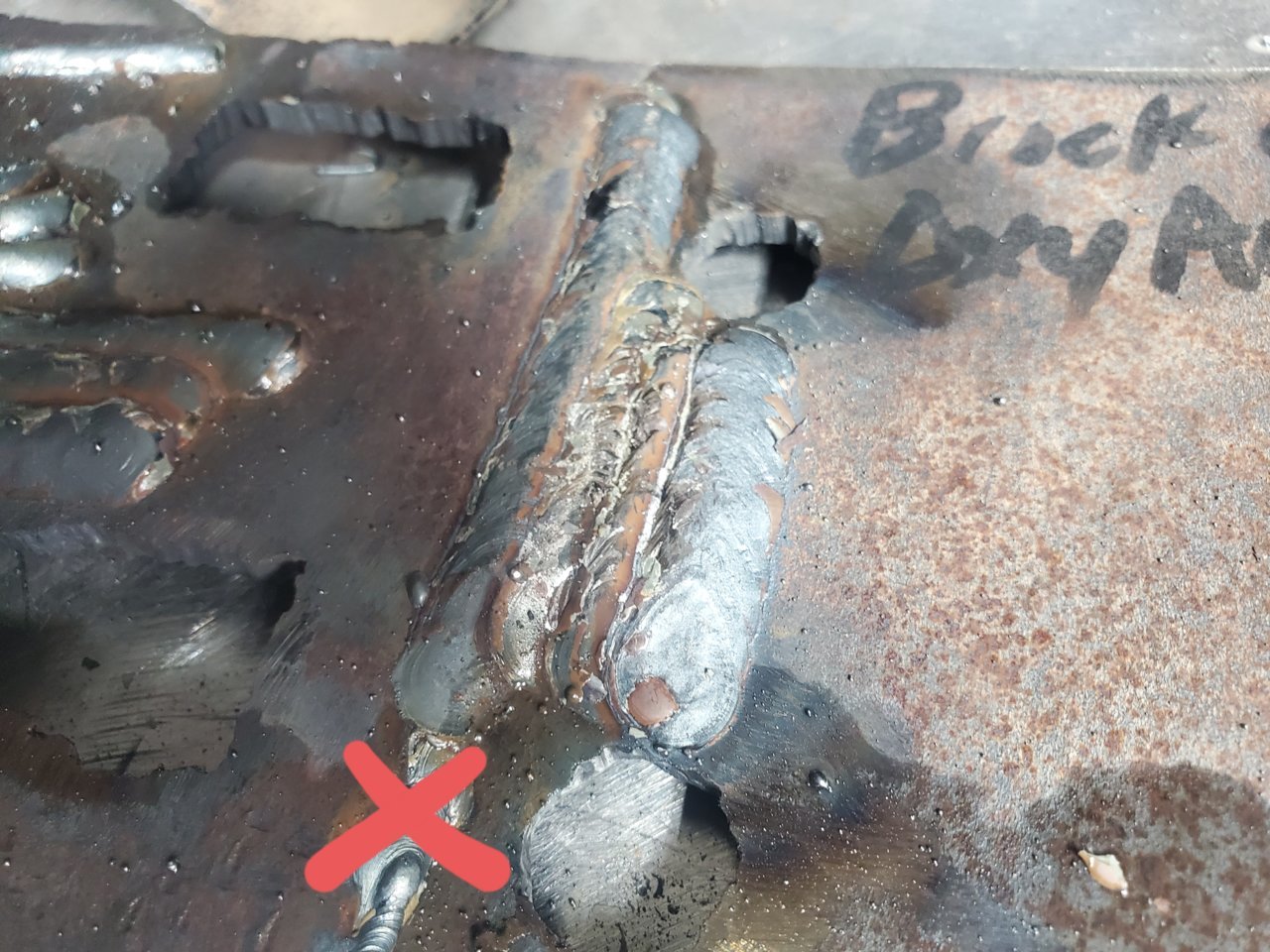

    Ran multiple beads, stringers and all, even stacking my welds. The red X's are the welds left by others as I'm using scrap -
    Here I'm messing with both push and pull methods as well -
    Point of the exercise today was simply to mess with the machine.
    I'm on a Millermatic 255, and I just put in .035" wire and a new Bernard gun to it. It hadn't been used at all by any of the other classes so I had to set everything up for practice.
    Started at 21.5v and 342 wire speed, ended up having to dial down to 20v and 220 with the pace I was going at.
