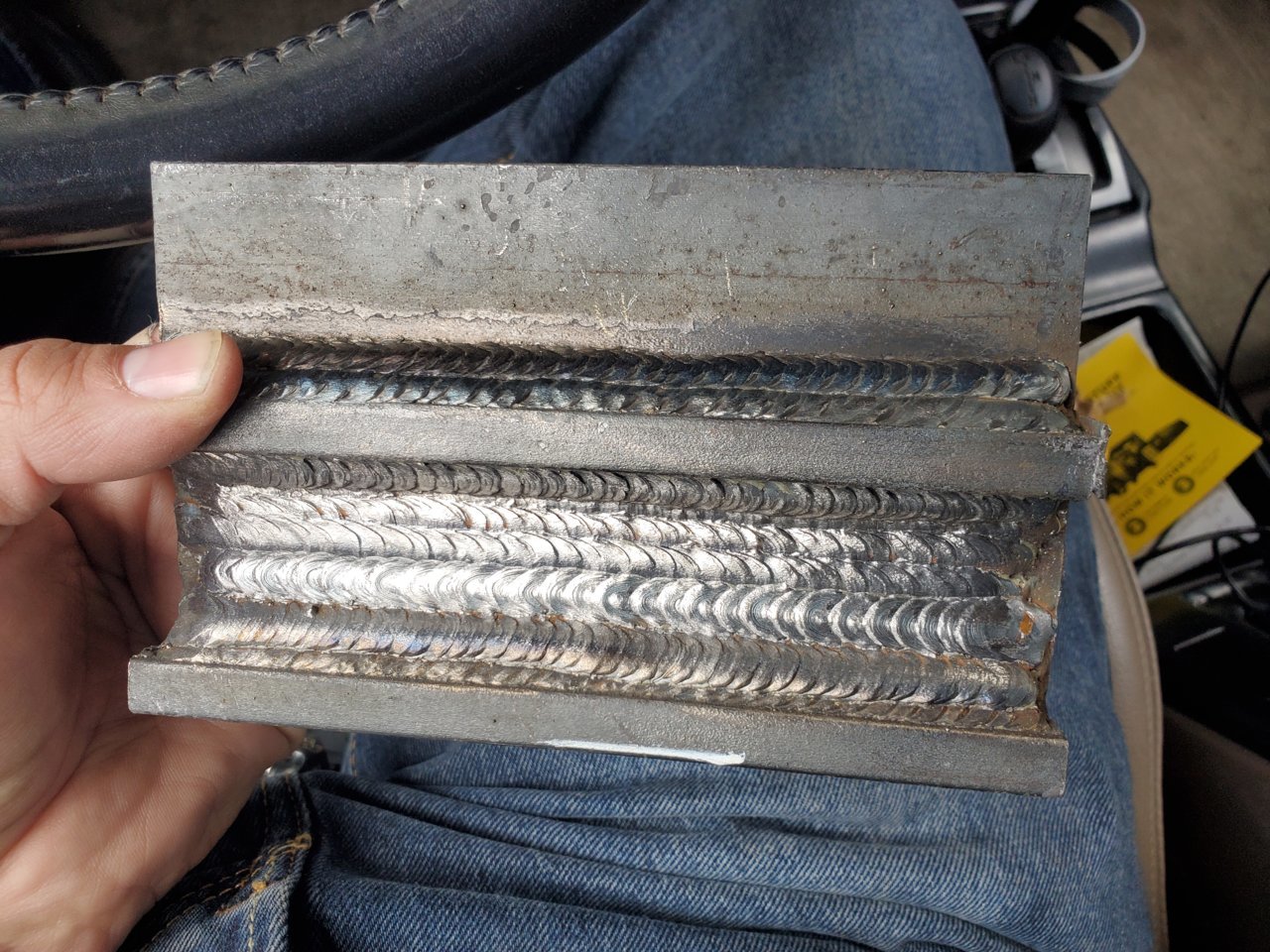

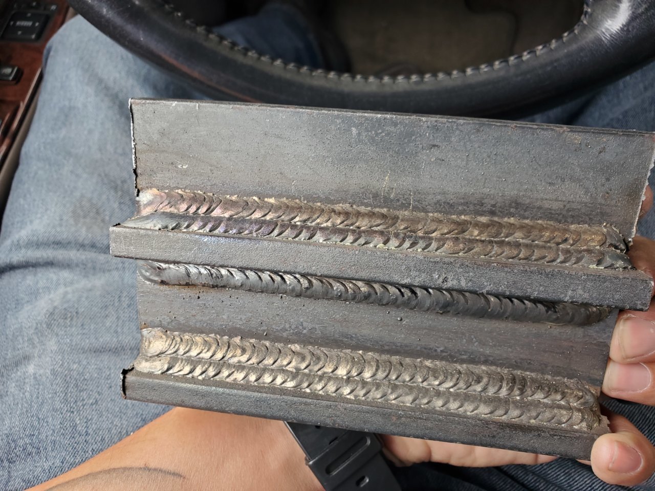

    Something happened that really boosted my confidence - Tuesday afternoon I had run multiple T's. I got lazy and instead of cutting more metal, I got about 23 beads on 2 T's I put together....overkill I know.
    At the end of the day that stuff goes to the scrap bin.
    Wednesday morning, I found said piece on the table of our classroom. I thought it was weird, and waited until the end of the day to meet up with the main instructor. He comes in after our class as he teaches the afternoon/evening.
    Apparently he said it did not belong in the scrap bin, and wanted to know who had done said piece.
    He got technical and even said it's difficult laying the beads on top of other beads, and that there was no undercut or discontinuities anywhere that he could see.
    Suggested I either; keep it and use it for pictures for the portfolio we build later, or let him have it to demonstrate it for future classes.

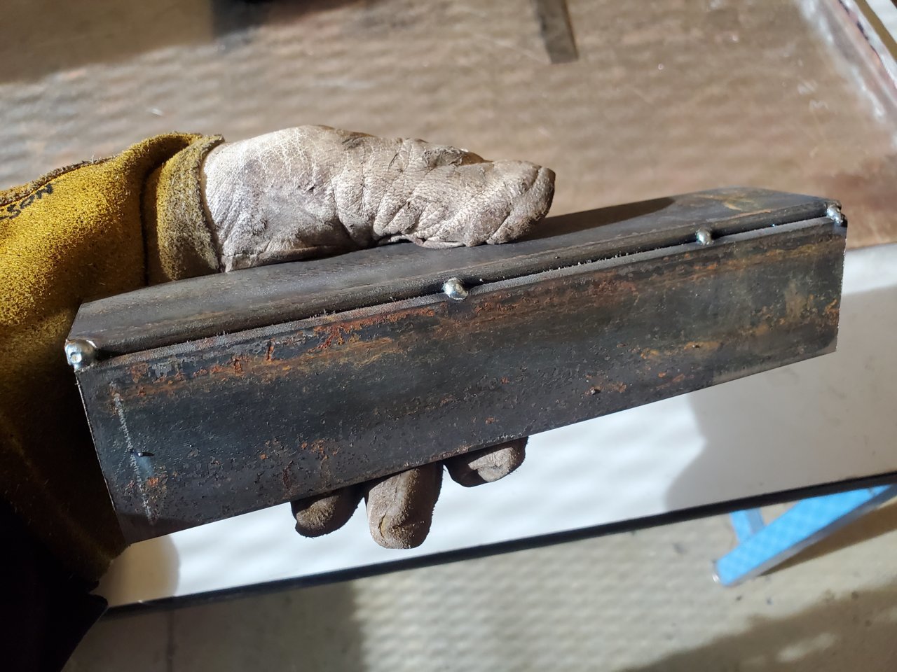

    Seeing as how we can only do so much without a real itinerary, I went ahead and started my first 'personal' project.

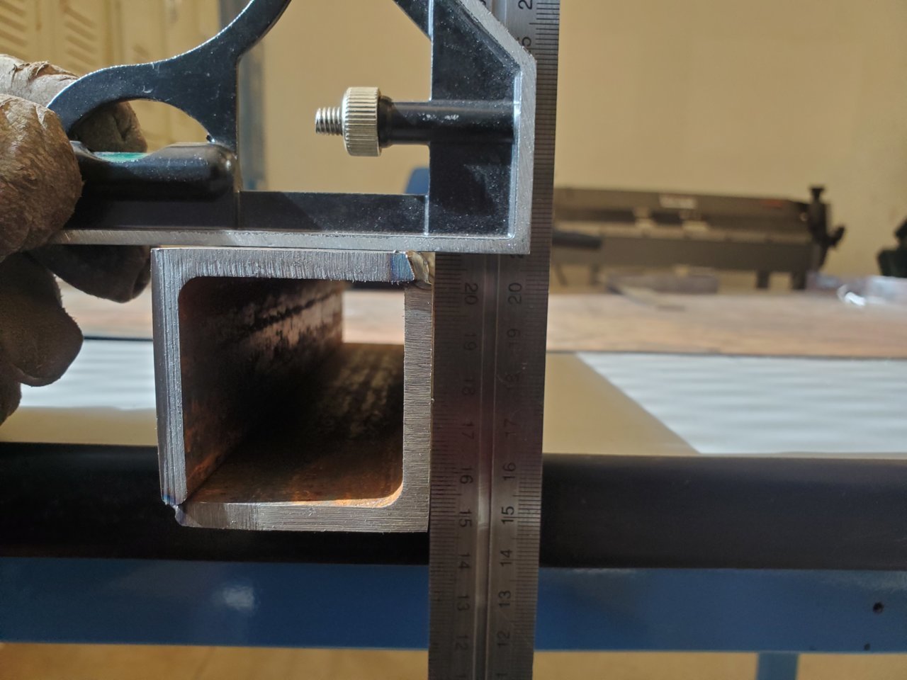

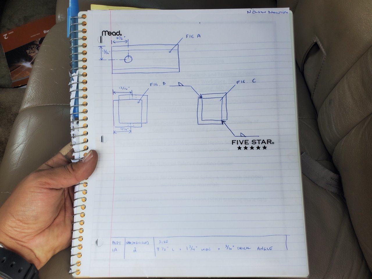

    Apparently, you are allowed to do them but you must take the time to draw out a blueprint and all so I did -

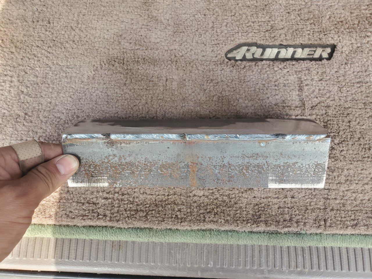

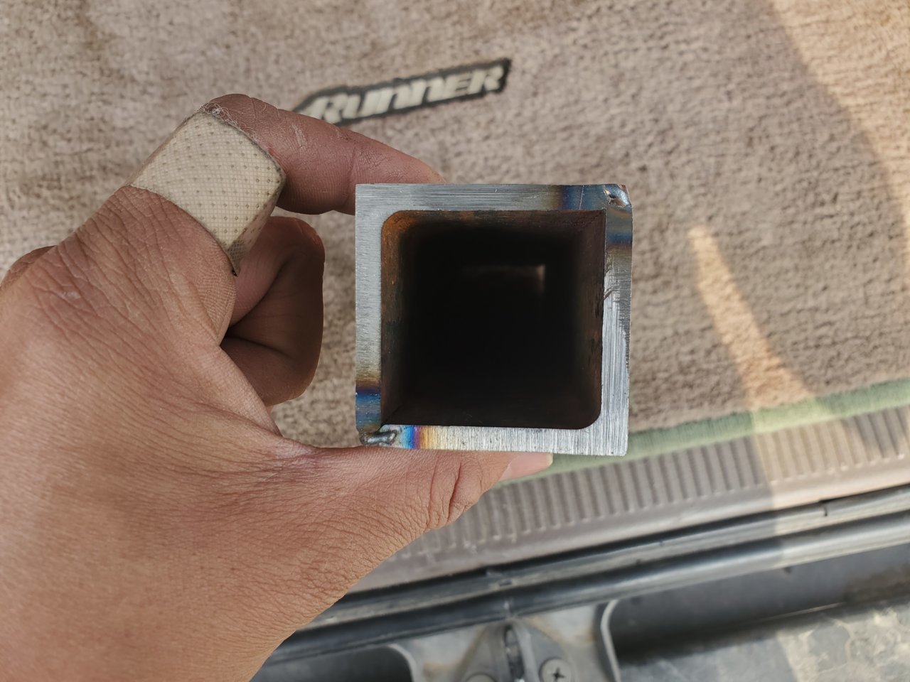

    The small project was just building a sleeve for a Class III hitch. It won't be used for towing or anything, it'll just be the base for a round tube to act as a flag holder when a vehicle is stationary.
    Practiced some real heat management in keeping this whole thing square -
    I do have some slight undercut, where I laid a new bead on top of the old when doing my passes. I realize I could've prevented this by grinding the initial bead first before starting another :facepalm:

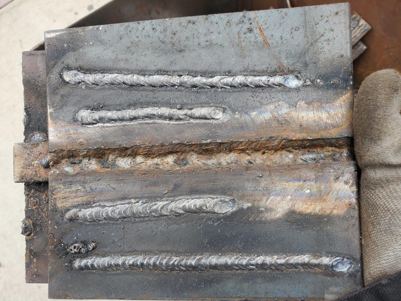

    When it got slow Thursday I took a stab at doing some stick. Being a glutton for punishment I asked "what's the most difficult rod to run"
    The answer was 6010 -
    Not sure why really. I never stuck the rod and those were my first passes trying stick for the first time!

    Yes your doing well but sooner or later your going to go crashing into a Brick wall just don`t let that get you to frustrated it happens to the best of us.
    I myself don`t think 6010 is hard to run at all you just need to know the tricks because it is different then running 7018. If you can master 7018 and 6010 you can pretty much handle anything you need to do with steel .
    When you can run vertical up and overhead in any process that is when you start to excel .
    Why would you not trust your Receiver you made for anything but holding a flag ?? Don`t trust your welds yet ? It would make a good front recovery point .
    Towing I could see then you only need to add a reinforcement where the male part plugs in like on the commercial receivers

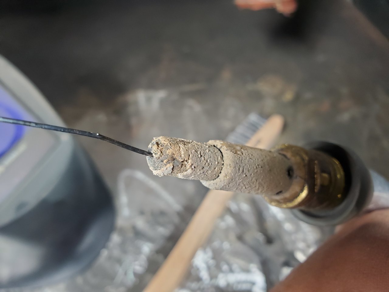

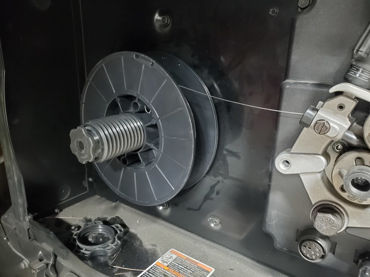

    I know I had an off day for a bit, but come to find out someone had reversed + and - when they switched out my mild steel wire to flux core. I found they messed up the regulator, switched wire, and left me a nasty nozzle and tip. Hell even the wore wasn't secured -
    It wasn't until I said "fuck it I'm going to try stick welding" that I disconnected the cable, and found it was in the wrong place.
    Reverse polarity MIG :facepalm:

    So it's not so much that I don't trust my welds, I'm just unsure of;
    1. The type of steel needed
    2. The thickness of said steel needed
    3. The specifics as to maintaining structural integrity in relation to the hole drilled for the lock pin
    all to create a strong receiver.
    Especially since I just took angled steel, and welded it together to make square tube. How strong can it really be?

    Just as strong as most other mild Carbon Steel the welds are the strongest part .Maybe stronger then HREW be fun to test and find out.
    If I think to measure Most Commercial Receivers are only 3/16" or 1/4" until your using a 2 5/16" ball out side of the reinforcement I have all flavors I am curious now
    How do you think they make HREW square tube run flat stock from coils through dies then seam weld it not really all that different it is interesting to watch if you have never seen it
    Then you have Drawn Over Mandrel Square Tube which used to be about twice the cost of HREW then with metal prices being so crazy who knows any more. Then who you know still plays into the price .How much you order as well.

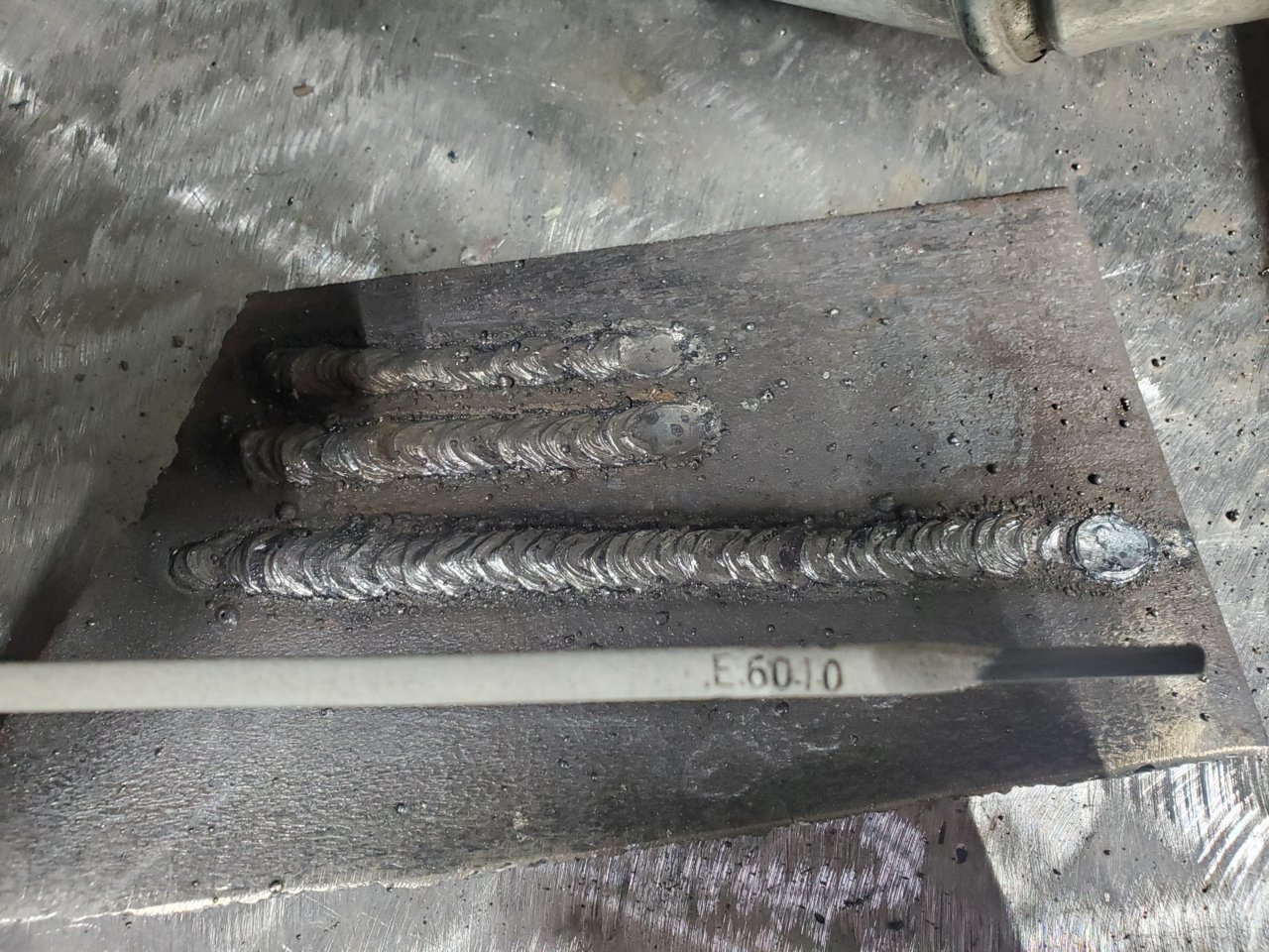

    This week it's been nothing but stick welding as we all have to put a 30 degree bevel on pipe, and weld it together. We have to put a 1/8" landing at the top and run a root weld with 6010. Think we fill with 7018?
    The distance between the two pieces though needs to be 1/8" as well.
    The 6010 can be 3/32" or 1/8" sized rod so we'll see what I use, but most likely 1/8".
    It's funny cause everyone has run a full module of stick welding before I even joined the class yet a handful of guys have issues sticking.
    Here are some of mine today with 1/8" 6010 -
