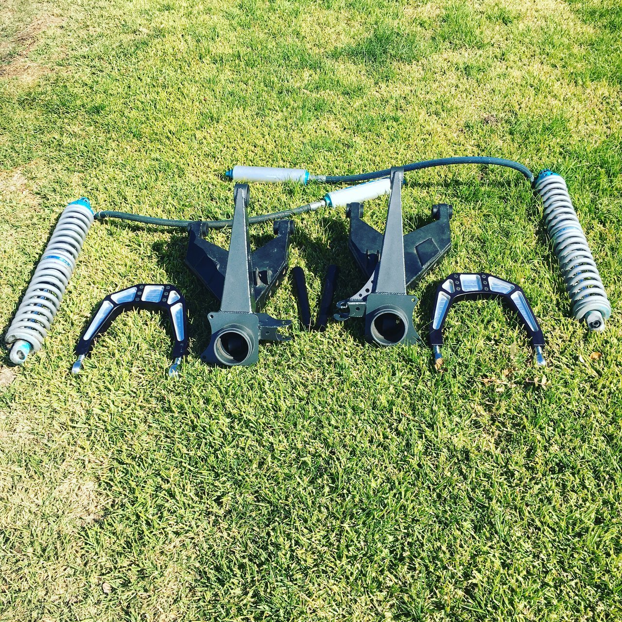

    So this past weekend I purchased a used weldtec designs long travel kit, I really don’t know much about them and I was wondering if you guys could help me out. I bought the kit for $1,400 bucks. It’s 6.5 over each side. And I have to buy hardware. Any experiences with this kit or advice. Pictures coming soon

    Judging that its going on your 03 then its for the 1st gens. I have never seen their kits or work. Never seen they made a kit for our trucks, must be a rare kit. Looks good, have any more pictures? I'm just wondering what hub it uses I'm going to guess a 2.5 Race hub? Or actually the factory hub looks like it , that's a huge snout

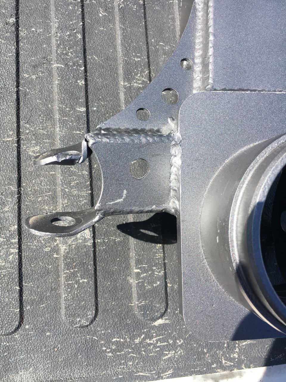

    Yes going on my 03 and the guys says it uses factory hubs. The spindle needs a little work and I’ll show you why. Both side looks like this

    Oh wow, wonder how that happened. Maybe incorrect steering placement, or tie rod heim was binding. Id call weld tec see what they say.Fix it with 3/16" it looks to be 1/8" but could be wrong.

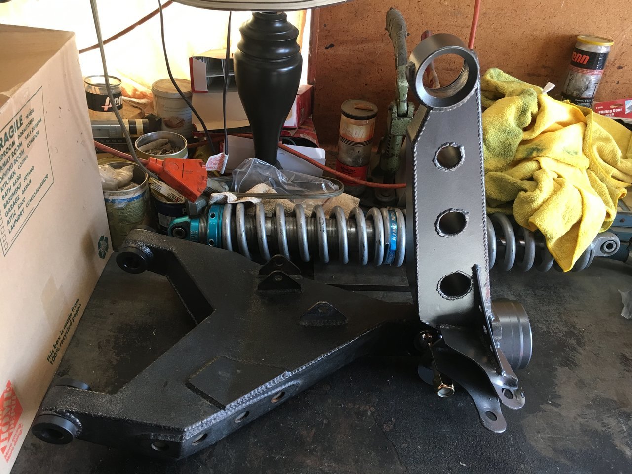

    Here is where I’m at. Need a tool for the uniball to press it in but this is the kit.

    Nice looks exactly like the tundra kit that's searched on google. Also just start gathering all your other parts. Looks like inner sleeves for the lower arms, uniballs, spacers, heims for tie rods. And I don't know if you got it but a billet clevis for the rack and the bolts.

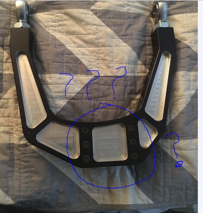

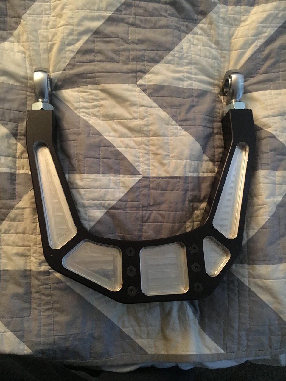

    - Little strange that the steering tie-rod mounts are 1/8" plate.
    - Does the upper control arm have a bracket that bolts on to encapsulate the upper uniball on the spindle? I circled the area in the pic below. Looks like six 1/4" counter sunk screws are screwed into that UCA. I assume those holes are drilled and tapped. The could have designed the UCA to fit a bolt through the upper uniball and not have some sort of bolt on bracket.
    - Kind of strange to see a fully machined UCA and then have the spindle various thickness of plate.
    - What grade of steel is the spindle and LCA?
