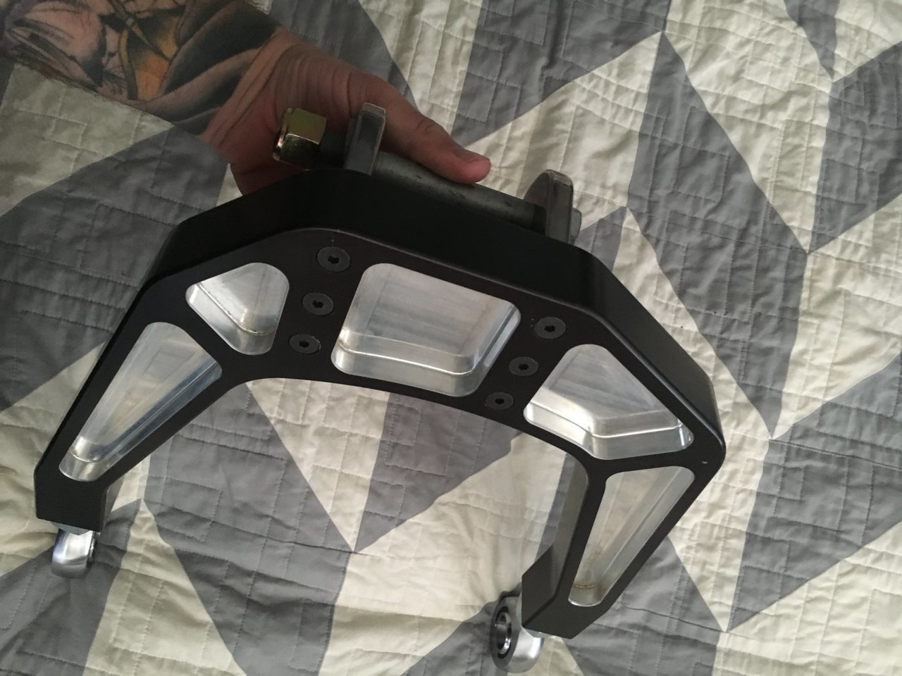

    Yea, the spindle looks the same but the UCA looks like its missing the ability to attach to the upper uniball.

    When I looked up the kit on the weldtec website it says it’s set up for the j-arm. So I’m asumming the a-arm was after the fact. And I have don’t have any clue what thickness the metal is on the spindle. Your guess would be as good as mine haha. I have billet tie rods for it already but I am going to have solo Motorsports correct the tie rod brackets on the spindle with 3/16 metal. If I decide to run bypass later on I’ll have to have the j-arm made. Probably won’t use billet though.

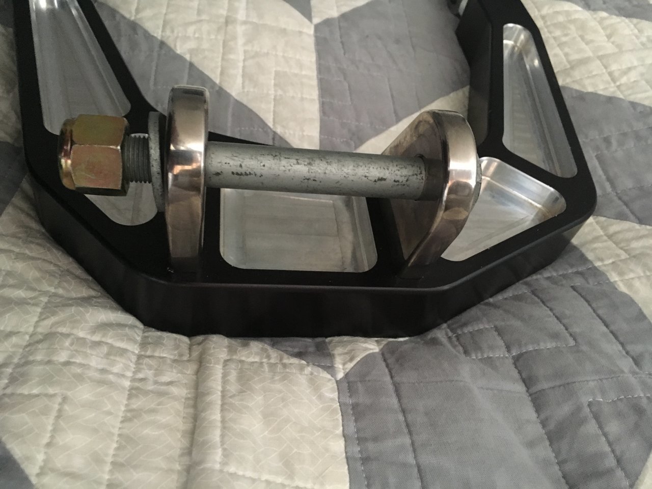

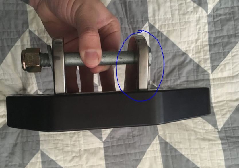

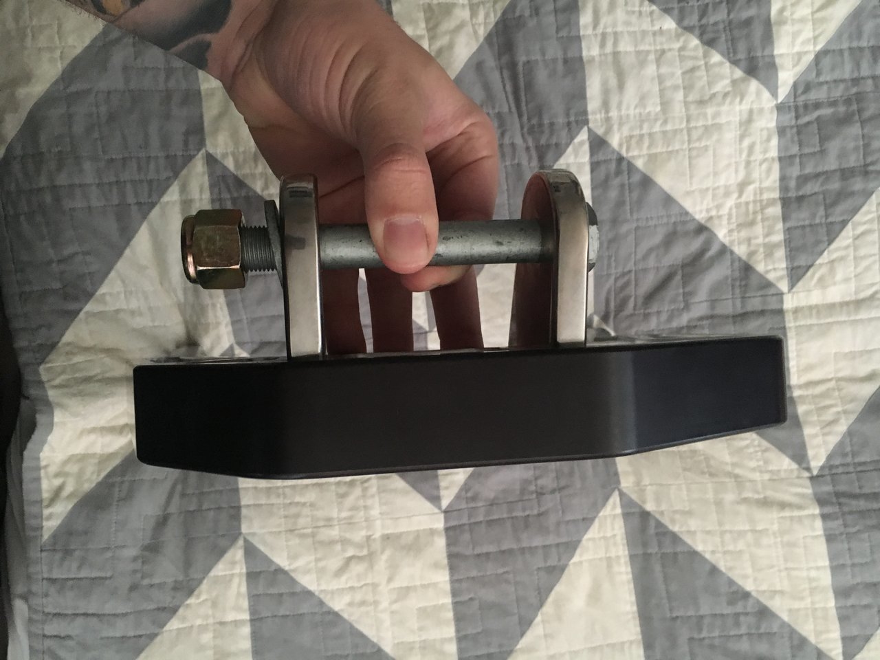

    I hope these picture answer your questions. If I doesn’t I’ll try again haha

    This looks like a questionable design. I assume those drilled/tapped tabs are mild steel. It doesn't matter what bolt you use if the "nut" material is far weaker than the bolt. For a 6" over kit this looks sketchy.

    We will see how it hold up. Blitzkrieg had kinda the same design for the billet ranger arms. The upper arm is not under that much stress ass opposed to the lower. It should be ok.

    Its totally fine. From the looks of it , its either billet or super thick 3/8"to 1/2" Steel.
