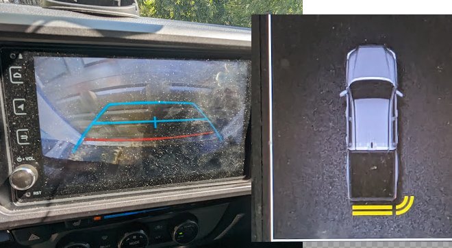

    16 TRD OR
    I tried those $15 china bsm sensors and they work but only from like 1 foot away. I tried a few of them from Amazon and ebay and they were all the same so eventually I bought an oem one from ebay for about $70 and that one works like the original one (senses from much farther away).
    Here's where the truck is facing the garage and only the middle and right sensors are picking up the walls and the china sensor is on the left and not picking up anything. I could also only see it get 1 bar most of the time from a foot away while the others would get 2.
