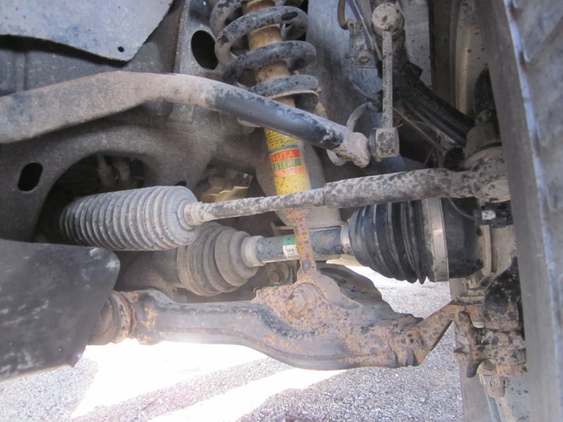

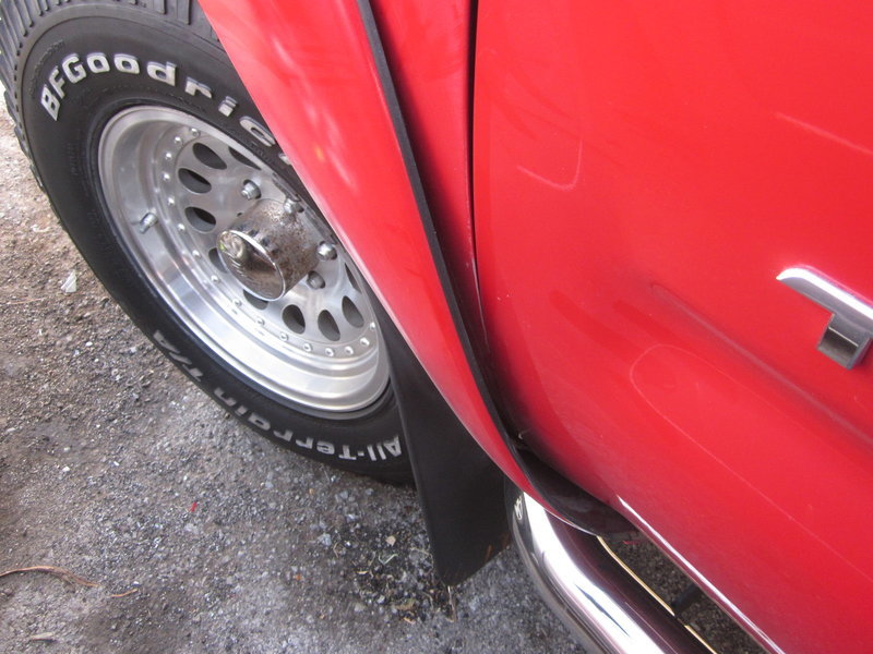

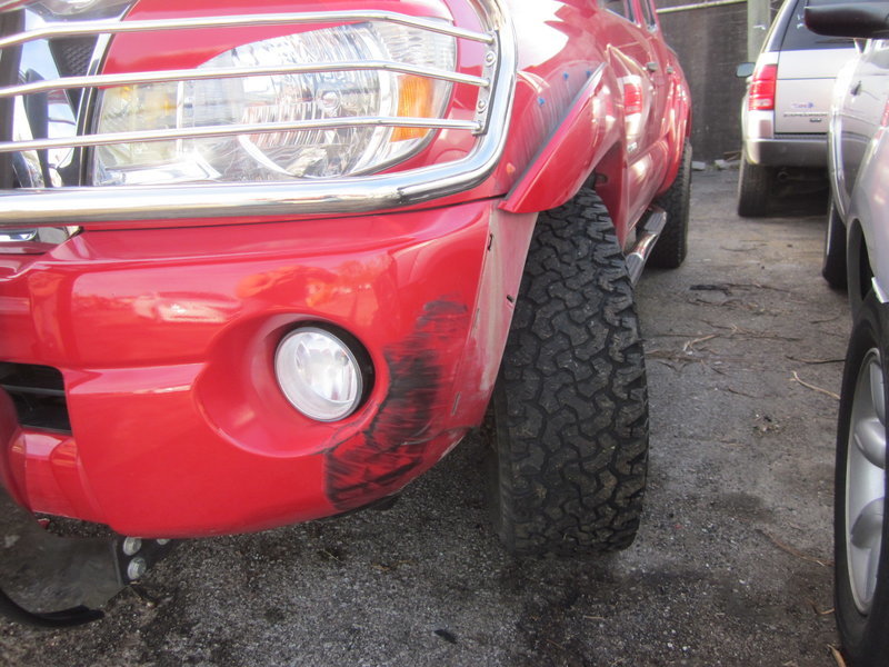

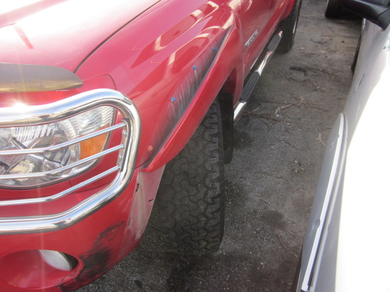

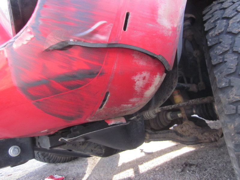

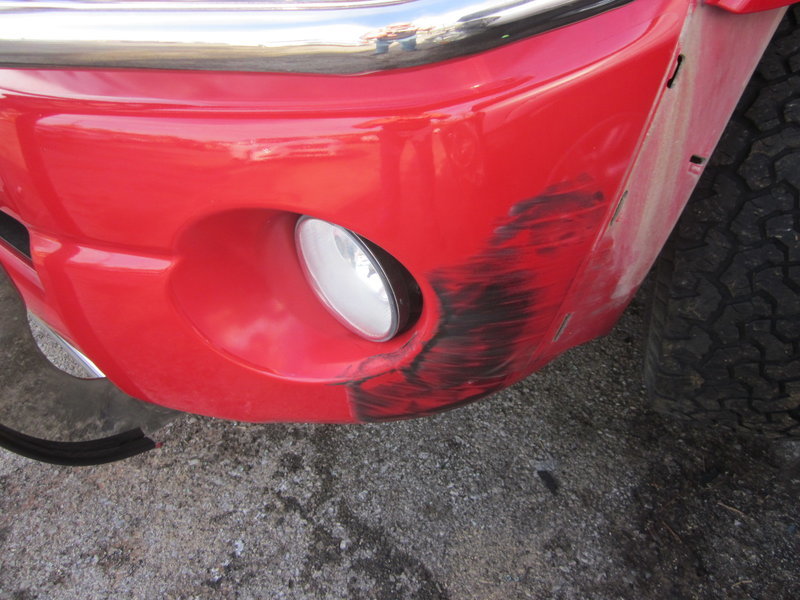

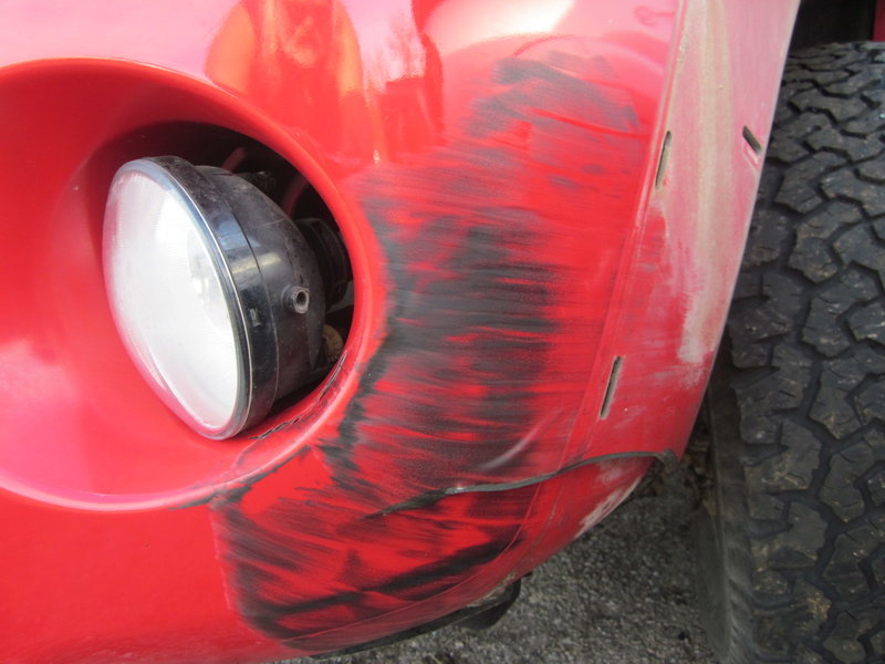

    Some more pics, with better lighting and in a bit closer. Maybe someone can see what's what with the suspension...
    IMG_2628.jpg IMG_2629.jpg IMG_2630.jpg IMG_2633.jpg IMG_2635.jpg IMG_2636.jpg IMG_2637.jpg

    lower control arm looks bent and maybe cracked on the end towards tire. spindle probably isn't straight and check the UCA frame mounting point, might not be like it was any more.

    I'm just wondering if the frame itself might have gotten bent, or just the suspension components. If it's just components, they can be replaced, but a bent frame is not good. Worried about the fact that the fender itself is now hitting the door when it is opened, so the sheet metal has been shoved back a bit.
