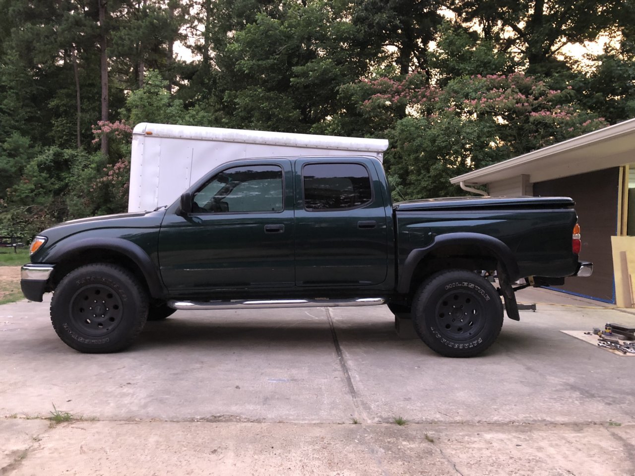

    just finished installing my new rear leaf packs and 5100s from the wheeers off-road complete suspension package. Couldn’t wait to get it off of jack stands to see what it looked like.... I was definitely surprised with the results. Prior to lifting I was at 35” to the bottom of the fender flare. Here are some pictures of the results...4” !! I guess I should’ve pulled a leaf spring out because I only wanted 2” of lift. When I finish installing all of my new front end parts I will post pictures of the stance before fixing the rear.
    I’ve seen some debate on here about which leaf to remove. I think it’s the longer of the overtravel ones? Is this correct?

    Wait for it settle it should drop then after that decided what you want to do

    Think it’ll settle a whole 2”? Or 1.75”?
    I’m driving like 1000 miles round trip to my new house and back this weekend. Should have a loaded trailer for the trip too. That should settle them right in if they’re going to settle much.

    You can take out the overload, but go easy on her for a while until it settles.

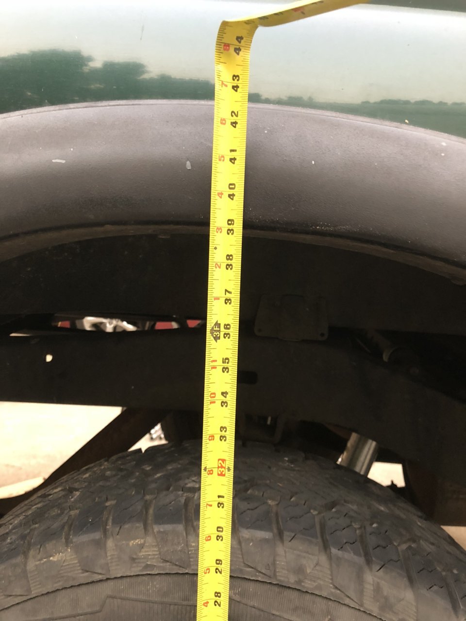

    What are some common fender measurements after adding the dakars? I know tire size will effect this. Mine currently sits at 39” and may be close to what others are sitting at after the same upgrade. Maybe my original 35” measurement was sagged a lot more than I thought?

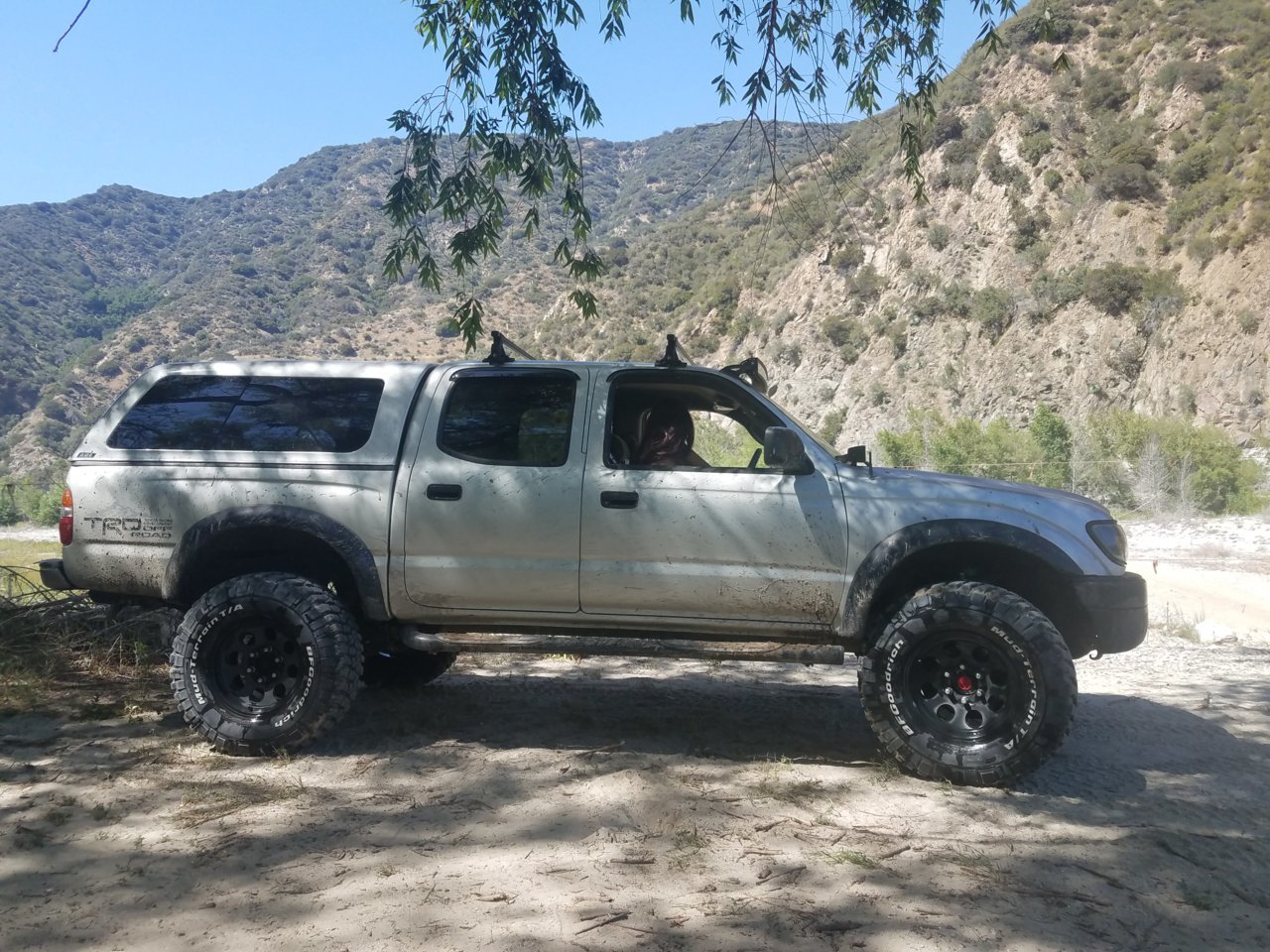

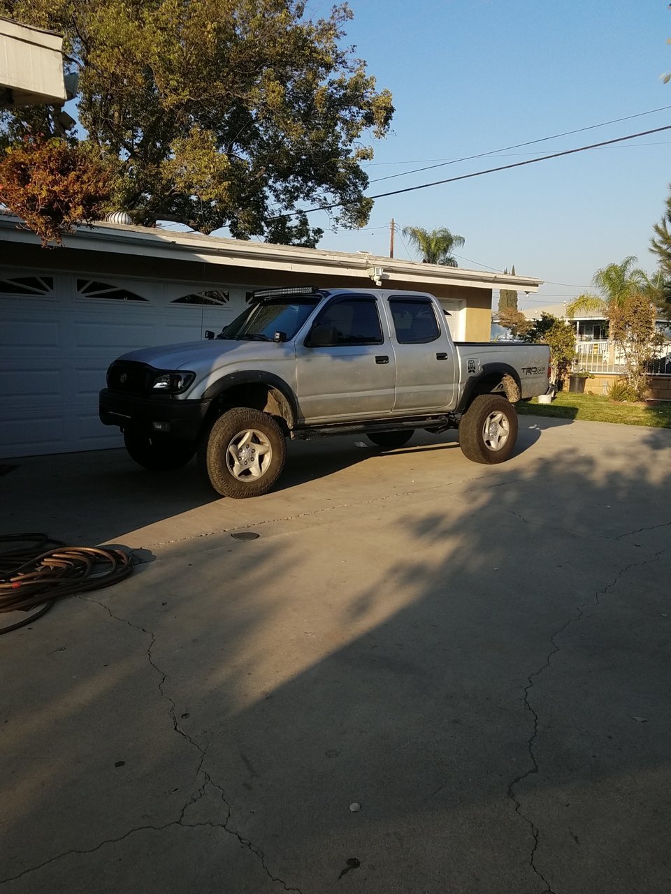

    This happen to me as well. I've just been adding weight to it and it's been settling just fine. IMG_20171028_165507.jpg 20180602_150748.jpg

    You should measure from the center of hub to Midway bottom of fender, for accuracy.
    Also torquing the front and rear leaf/ shackle bolts after cycling the suspension at ride hight will combat it sitting funny/ & or binding.
    Dakars sit high at first then pretty much settle flat.
    With an empty bed/ no weight you can remove the 5th leaf or throw a few concrete/ sand bags to settle it quicker.
