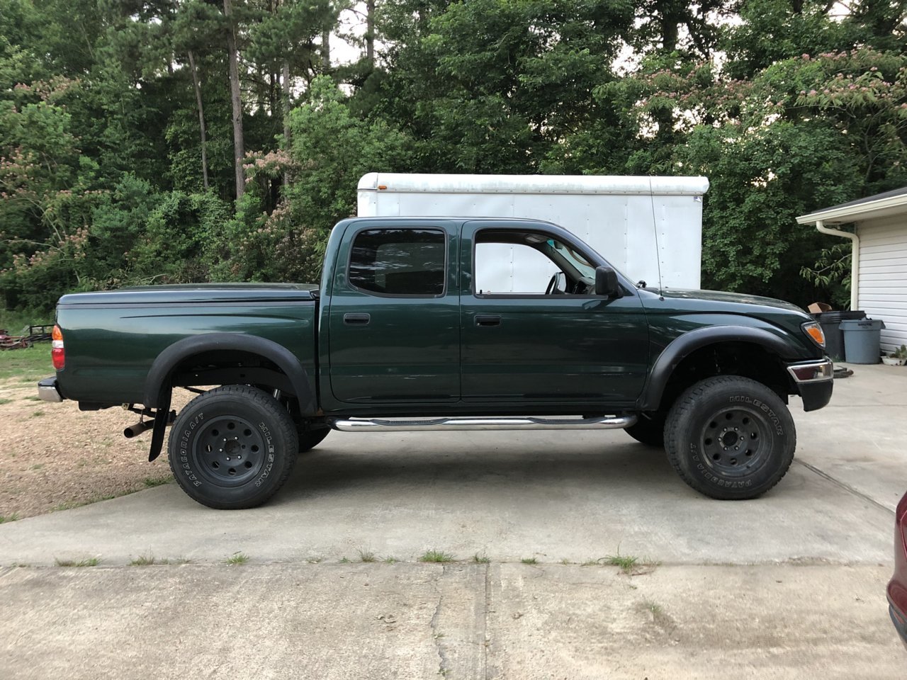

    You were correct. I think I was just stressing for the hell of it.
    Got my parts installed though. Lots of brake bleeding in my future. Also think I need to grease them. They sounded pretty crunchy when I moved the truck earlier today.

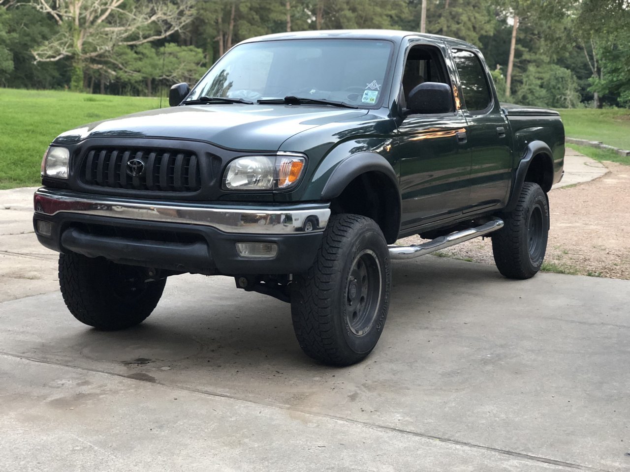

    That’s a wrap for this project. Still lots left to do but it’s safe to drive and road worthy again. Complete suspension and front end rebuild. Paint and body is next!

    How's the view up there:) looks tough!
