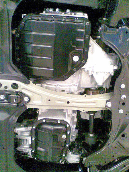

    It's not THAT bad, a tranny pan and an oil pan look a lot more like each other than an engine block and a transmission

    Yeah imagine changing oil under one of a few million Corollas out there. FWD with transverse engine means the tranny pan and engine oil pan are right next to each other. Both pans are black steel and the drain plugs are interchangeable...
