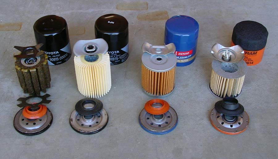

    Denso aftermarket filters have slightly different construction than OEM. Should work OK though:
    There were some further changes when Denso moved filter production from Thailand (blue canister) to China (black canister). The bypass valve now has a coil spring instead of leaf spring, for example.
