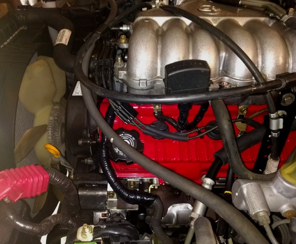

    This morning I finished installing the radiator, new belts, adding coolant, ATF, hooking everything up. Performed a final check. Then I disconnected the EFI relay and ran the starter for a few minutes to get the oil circulating for the startup.
    When I reconnected the EFI relay, it started right up. No codes! I let it run for 5 minutes and then cool down. I will start increasing run cycles 5 to 10-minute increments. I need to get it out of the garage where we can breathe.
    This is going to be a quiet baby. I'm so happy with the way it turned out.
    I'll post a run video later this evening.

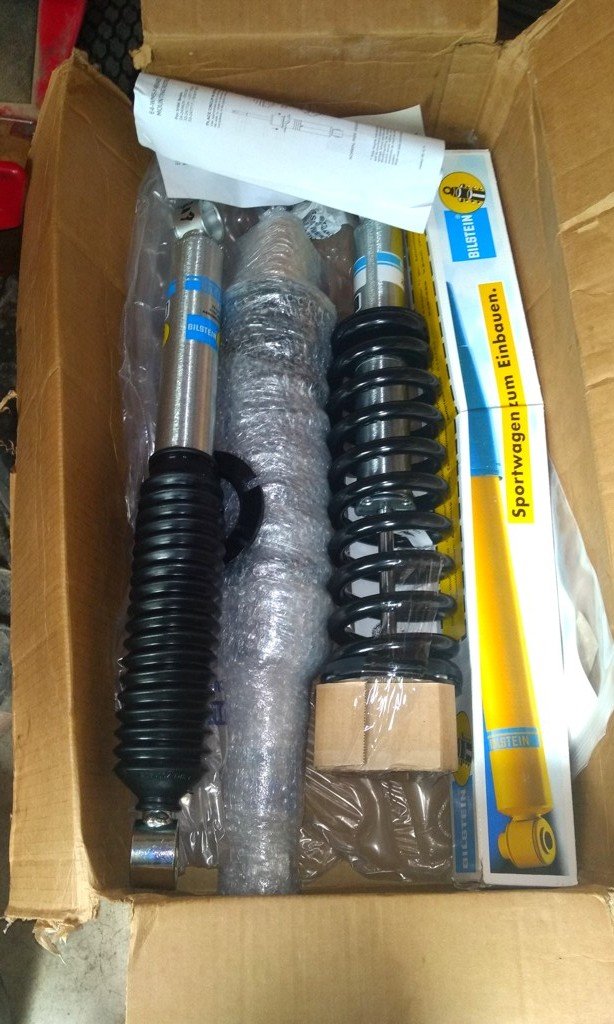

    Where did you get that box of awesomeness and how much did it set you back? I need that...

    Just give Wheelers Offroad a call and let them know you are a member of Tacoma World for a discount. They will outfit you with exactly what you need that fits and works great. Roughly $600 -- depends on shipping and final details. Let Wheelers assemble the shock spring sets. No hassle with spring compressors and totally worth every penny.

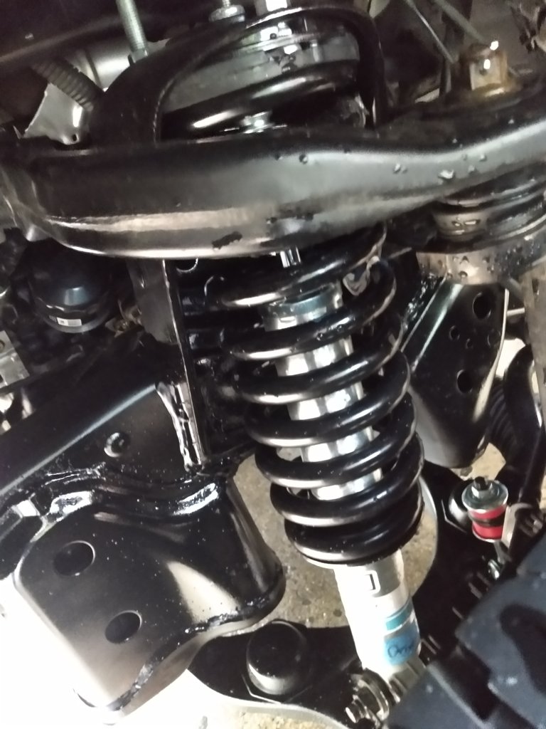

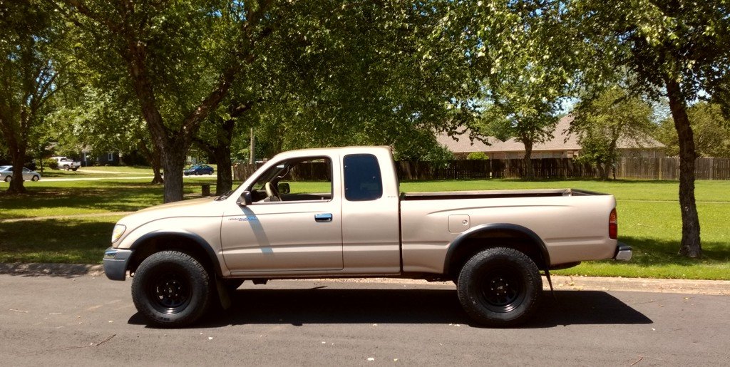

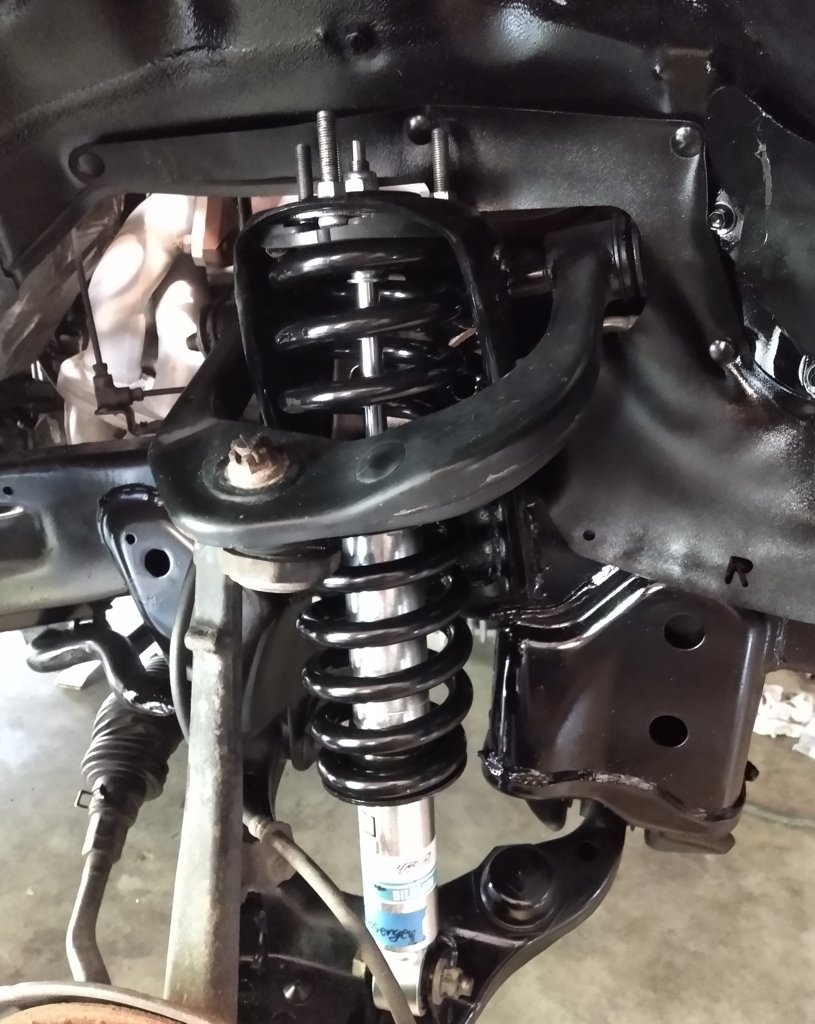

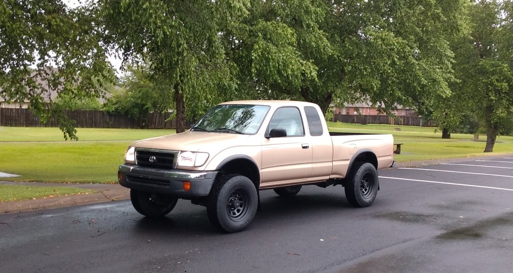

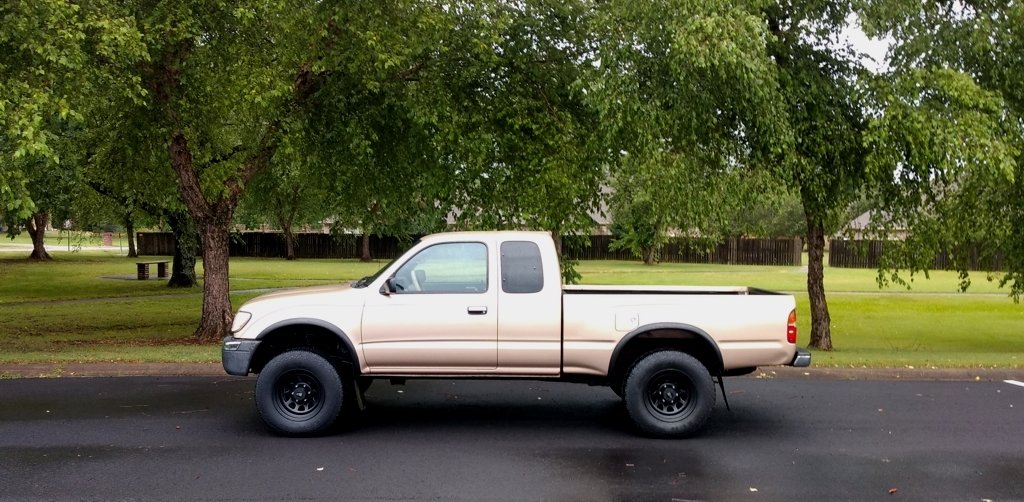

    Finished the Bilstein shock and OME 880 spring installation. I got just the amount of lift that I wanted. Here are some pictures with a before and after.
    New ES end link bushings in Red. Somebody had just replaced the inner bushings before I bought it. So I left those alone.
    Before side view.
    After the new 880 springs.
    At some point in the future, I will install new springs for the rear. I like it as it is right now.

  20. Jun 24, 2019 at 7:09 AM
    #20
    Wulf
    Jan 30, 2015
    #147523
    62,108
    rock raisin
    After 500 or more miles I'd expect the springs to settle a little bit so it might level out
