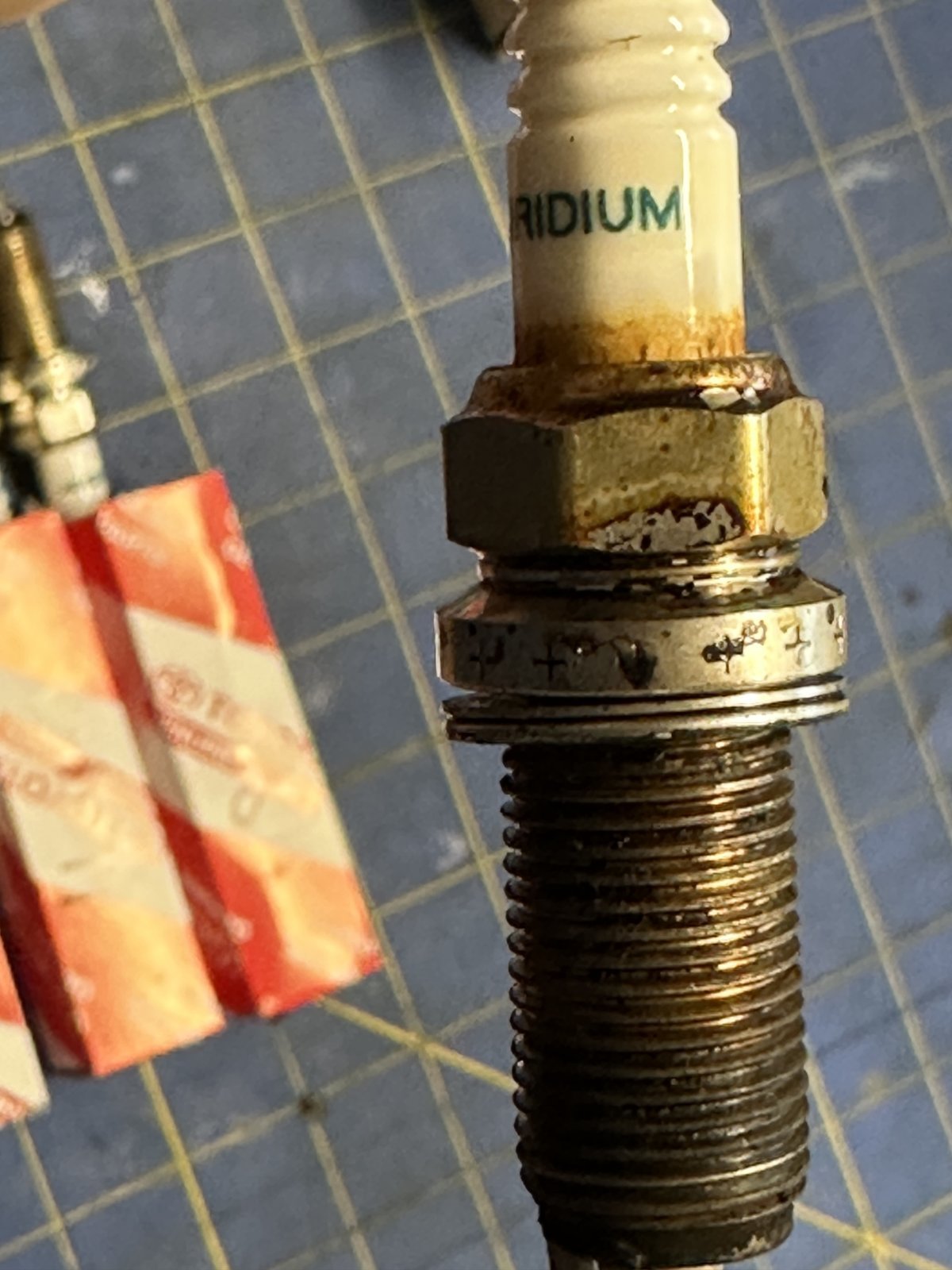

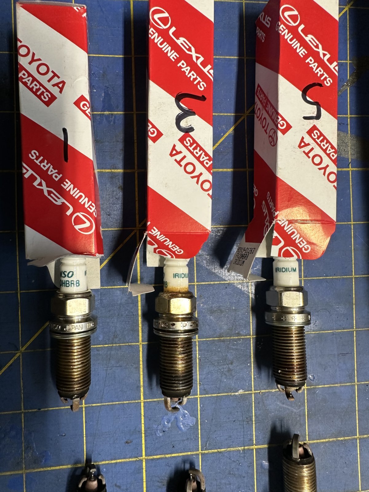

    On a whim, at 50k I thought maybe I’ll just change the spark plugs . I ended up buying Oem plugs . I had read a few people had some loose ones .
    but I thought , nah these will probably be all clean and fresh when I pull them out .
    Boy was I wrong . 5,6,1, and 2… tight. Enough that when undoing them they give a little like pop free .
    3 and 4 though, …. Yikes . They were pretty loose. 3 had actual burnt body and was sticky .
    Funny is truck seem to run fine .
    Filling up tank and who knows maybe I’ll pick up 1% mpg gain lol.
    Oh side note , I did not use the anti seize and I had read that the oem denso say not to use it
    It was actually much easier than seemed in some videos . So if you suspect anything , just change them to be sure you are good

    Just had a 30k mile big service from every fluid , belt to plugs. Three were loose but not finger loose. Plugs looked close to yours, it ran perfect so I chose to replace all of them. I say it was worth it!
