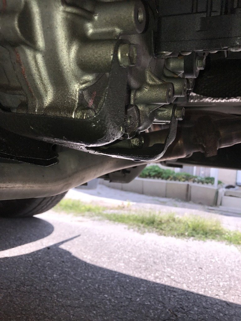

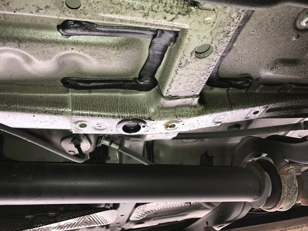

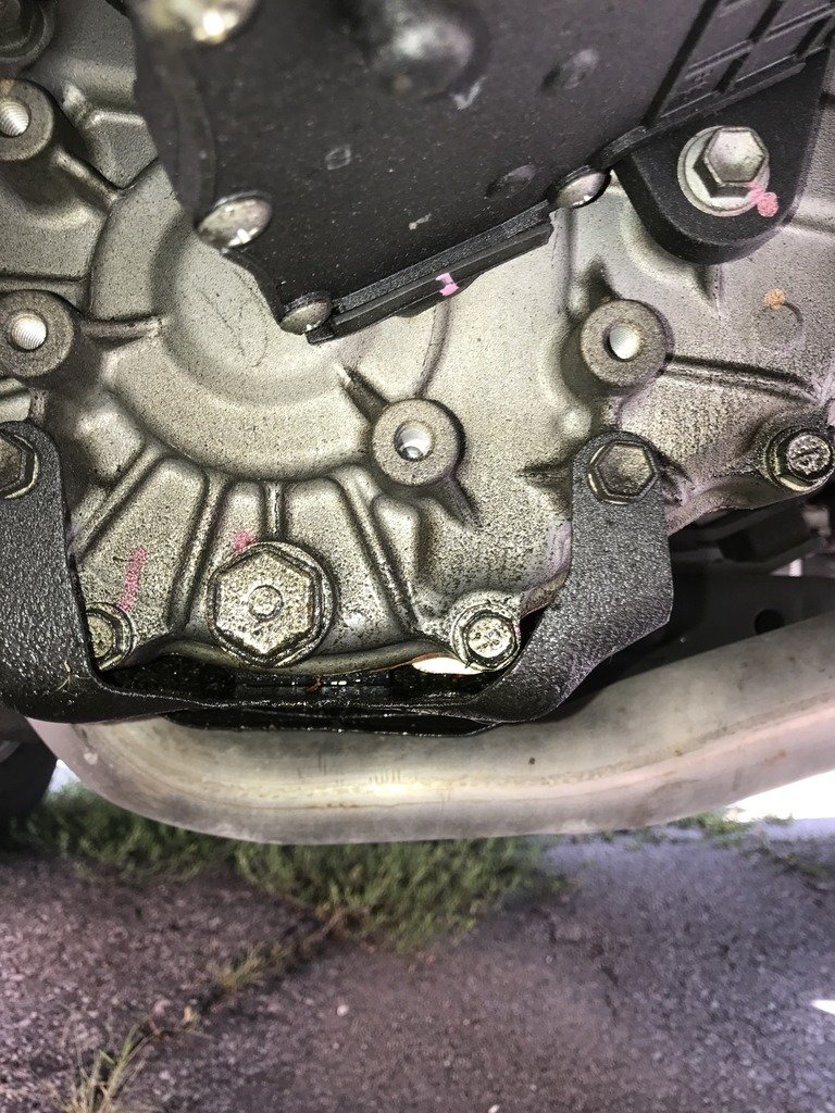

    Noticed a few drops on the driveway and seems to be coming from the transmission and/or transfer case.
    Off to Toyota we go...:bananadead:IMG_0062_zpseoa5zrbx_42dc6da77e3f8ecf371f76636cb298f1bfe2e329.jpg IMG_0060_zpspfmnegt1_fa9cd0cc3a9c52eeddd98156a5f4847aa75fca2a.jpg IMG_0061_zpsinqeern6_4c2b471877eed278db42db3c8ccb5f28a7fa770f.jpg

    Is it the transmission or the transfer case that seems to be the cause of the leak. Pictures kind of look to be of the transfer case, if it's the transfer case I do believe a few people have reported leaks in the last month or so.

    Good eye, it could also be the culprit both are oily. Really the first 1/3 of the truck is dripping at this point. I'm here now we'll see what the culprit is

    Verdict is in, leaking transfer case.
    Ordering in parts to reseal it.
    Question for the technically savvy, should I be worried about any damage/excess wear and tear in the transfer case?
