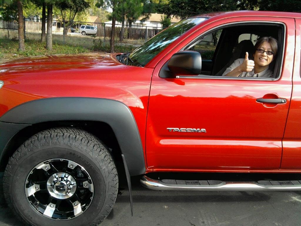

    About two weeks ago I went from stock steelies and tires to BFG Rugged Terrains (NOT Rugged Trails) size 265/70/17. From what I understood and was told, that these tires would fit fine with no rub.
    Well, I got rub. Rubs both on the front of the wheel well and on the flaps. I removed the flaps but it still rubbed just a tad at full crank.
    I don't want to cut both front and back of wheel wells so the next thing is to go down in size to 265/65. Had the guy check for recommended size in the computer and yep! It's supposed to be 265/65 not 70.
    Kills me to think that for some reason a lot of you can fit that size but for some reason I still touch rubber. :(
    Just a heads up on these tires and on a 2010 4x4 with stock height.

    if it's barely rubbing your tape test, i say leave it as is and don't downsize. in 6 months, you're going to add some kind of lift(given you hang around TW enough) and you're going to regret downsizing.
    as KPT recommend, you can add a 1" spacer lift up front. it's pretty cheap and you can level out the truck.
  18. Nov 27, 2011 at 4:29 PM
    #18
    babytruck
    babytruck [OP] Babytruck, babytruck...I've got a babytruck :)
    May 17, 2011
    #56797
    8,985
    NorCal
    2010 Barcelona AC 4x4 4.0 6spd
    I really don't want to cut the car quite yet. It's still new to me, I've got 4,400 miles on it.
    I was thinking that too but currently I can't even park the truck without hearing the sound.
    Ignore the thumbs up. This is when the truck was brought to me with the wheels on as a surprise. I was saving up and didn't quite have enough when my husband went ahead and had it done. Please note that the mud flaps have been removed.
    Will do!
    I don't think I'll be doing a lift any time soon so for now I'm hoping I don't regret anything.
    If this doesnt work, I'll have to consider the 1" spacer.

    why does the truck look so low? :confused: or is it just me?
  20. Nov 27, 2011 at 5:50 PM
    #20
    Rain
    Rain Well-Known Member
    Nov 13, 2011
    #66939
    227
    John
    Washington
    2011 TRD Off Road
    I see what you mean. The wheel well looks too "full" for that tire. Maybe something else has been done to the truck.
