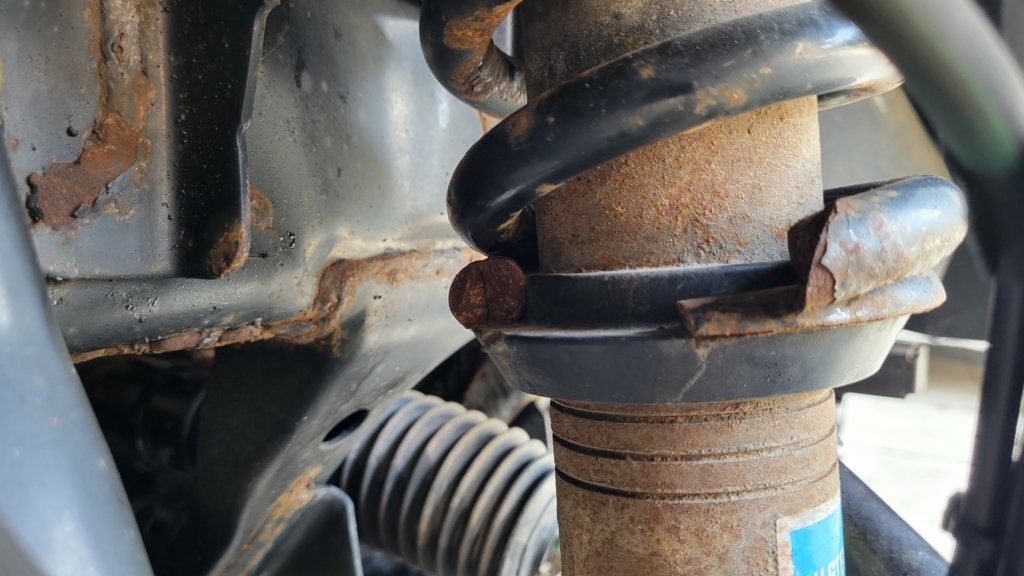

    Working on the "fix" for the timing cover "leak" and noticed this:
    It was getting time for replacing my suspension anyway, so now its diffidently time.
    Have 6112 up front with 5160 rear.
    Thinking of going to OME setup all around:
    REAR FRONT I have a Icon RXT leaf pack, so not sure on the trim size I'll need to keep ~ 2 inch in front and 2.5-3 in rear
    I contacted wheelers so well see what they recommend.

    Yeah....not good at all.
    Those OME shocks should keep you where you want to be, height wise.
    I have the Nitrochargers in the rear and MT64'S in the front.

    Yikes. Where are you at?
    Yikes. Where are you located? I upgraded to 6112 because I figured that'd be something that lasted a long time. That's a bit disappointing.

    Nearly every spring I've seen that is broken like that has also had significant rust on it (and this one's no different).
    I suspect that if you kept the rust in check, would help prevent this happening.
    JDKred[OP] likes this.

    I'm in Utah. Had the set up for about 8 years.
    It's time to replace the, for sure, but they appear to have been broken for years based on the rust.
