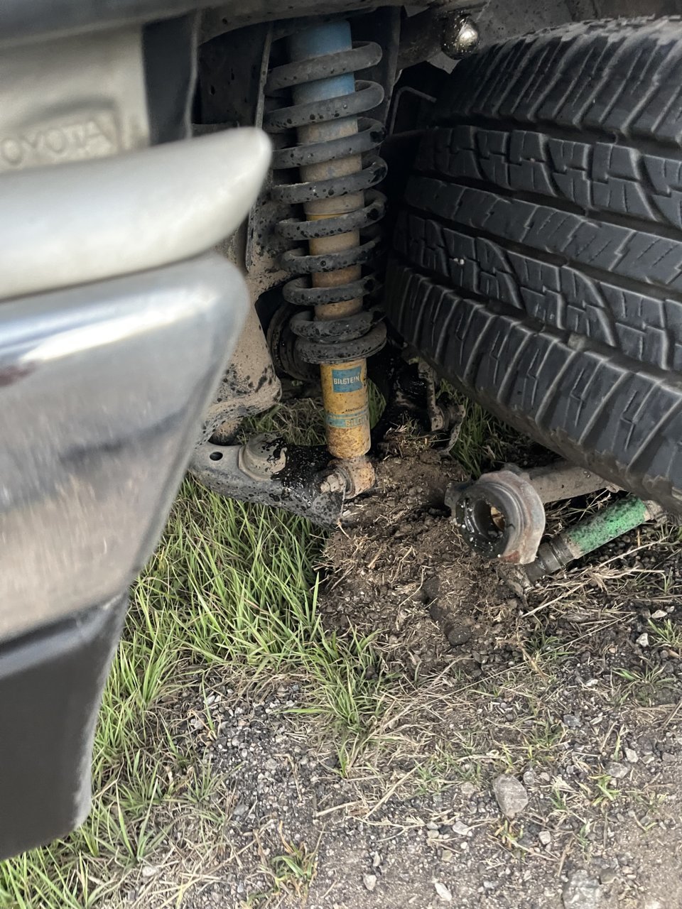

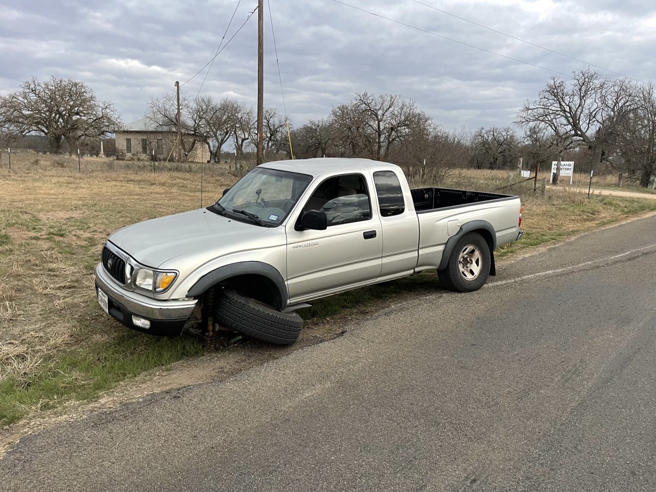

    Any ideas as to how this happened? Driving along and and with no warning this happened… scared the heck out of me. Still a little shocked. Thankful I was close to home and that no one else was around….
    My poor baby :(

    Your lower ball joint (LBJ) came apart, either the joint itself or the 4 bolts holding it to the steering knuckle. It’s a known issue on these trucks, the joint design is pretty poor.
    They have to be replaced at least every 100k miles, and bolt torque checked regularly.

    OP, replace both lower ball joints with OEM. Looks like you need upper ball joints too.

    Yeah this is the number one thing I stress when I see a new to me owner on here. Just the other day I told a guy to change em and some guy got mad that I said change em every 100k miles and check on then when changing the oil cus a lil rip in em will get water and dust in there and eventually will snap. Change all for joints with oem. If youre gonna lift you can save money with new uca’s. Your cv axle probbly ripped off aswell, had a hard time getting an oem axle cus of supply issues. Gl.

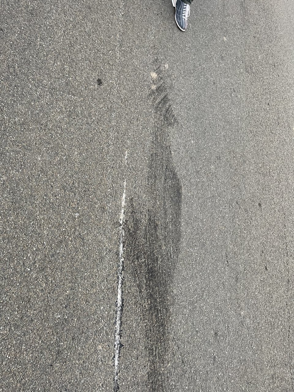

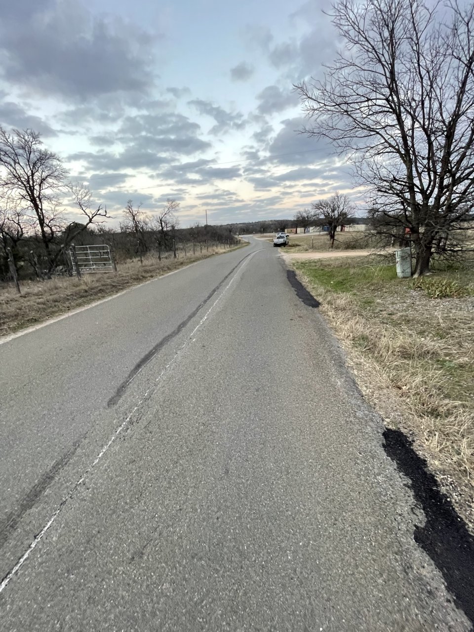

    Just out of curiosity, do you remember if you hit a pothole or some kind of road feature that took the weight off the left front? Reason I ask is quite a few of these posts have been on here and most were at low speeds, with minimal additional damage, and on local roads (not highway/freeway) so more potential for potholes. Looks like you were in a rural area, so I think your occurrence fits the scenario.
    I am just wondering if that's what normally allows the bad joint to separate to the extent the boll can get out of the cup.

    As you can see here there was nothing in the road. That’s why it was so shocking to me, I thought my tire exploded at first and got off the side of the road as soon as I could and as the truck would allow. Left a good scar in the pavement though :rofl: won’t soon forget that!
